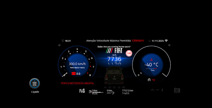

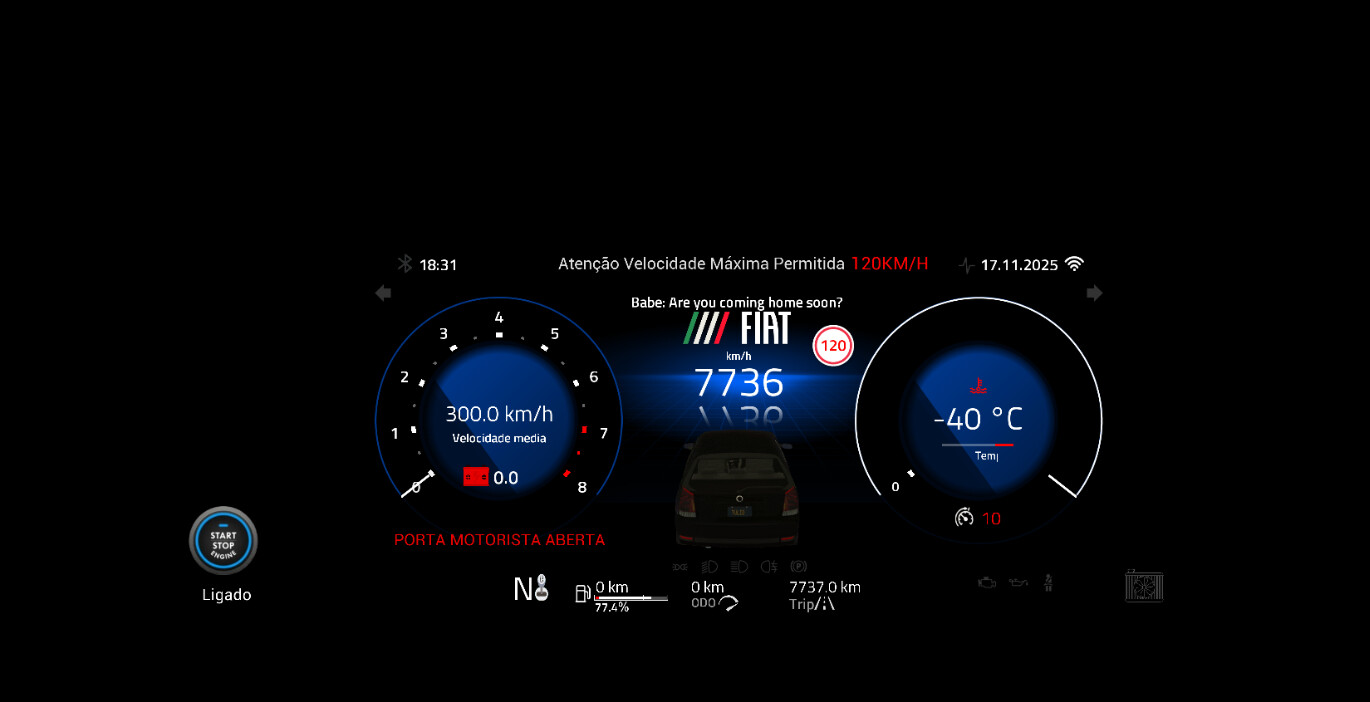

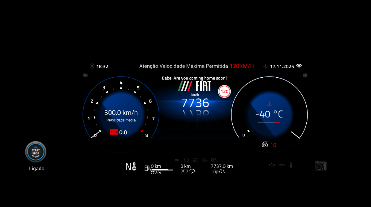

After updating to the latest version of RealDash, the car animations started disappearing during use. I use GIF files to create the 3D car animation, and some of these animations are triggered by steering-wheel inputs (triggers). The 3D car GIF animation only reappears if I manually reload the dashboard.
I noticed that this issue may be related to a specific trigger. In my case, the problem was caused by the fade gauge, which seems to make the animations disappear.
