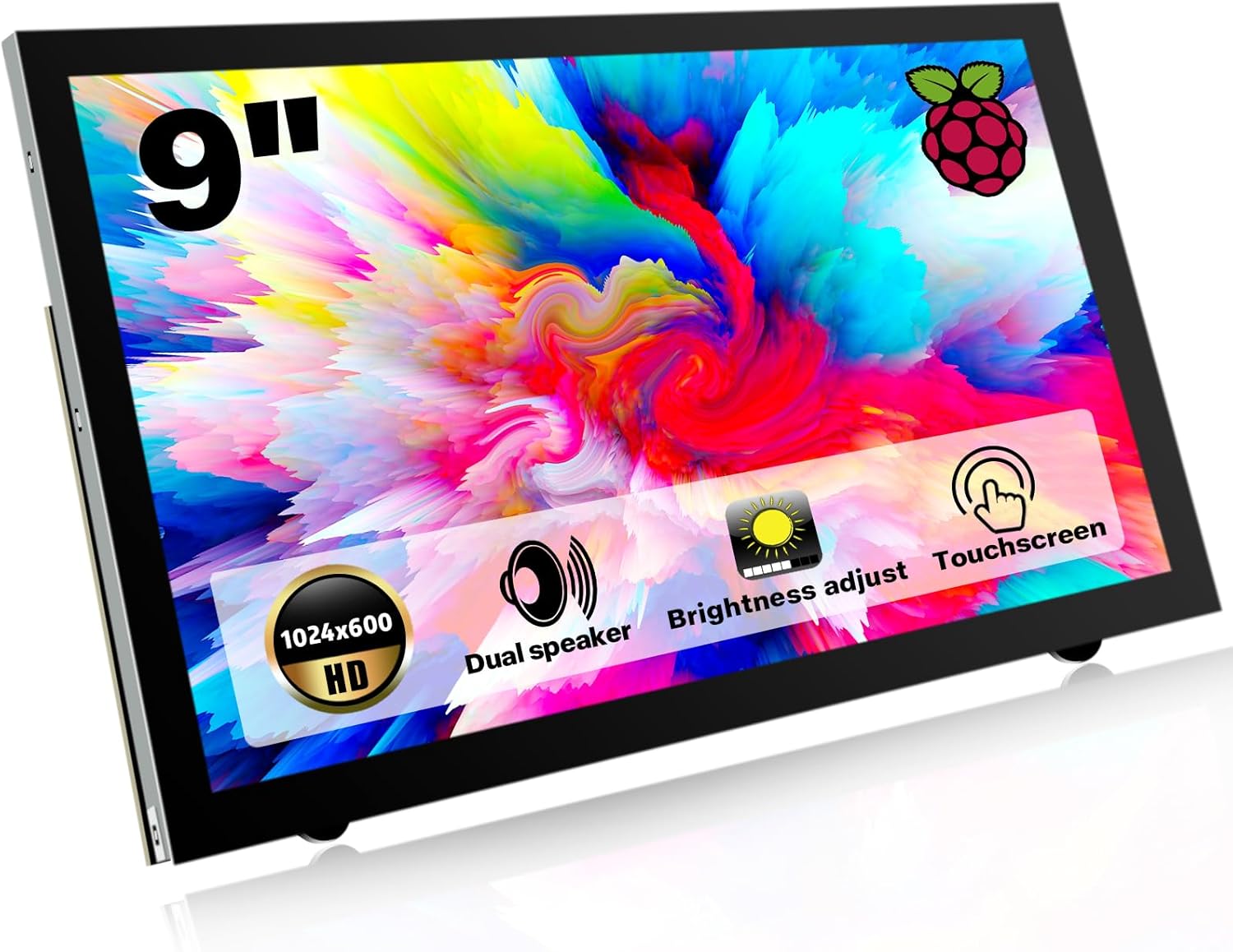

This is the screen I’m using, any suggestions on a different screen or help at all?
This could be a case of having display controller that reports a different resolution to OS than actual resolution of the screen. Does your X-Session identify the screen as 1024x600 display?
You were correct, thanks for the help!
