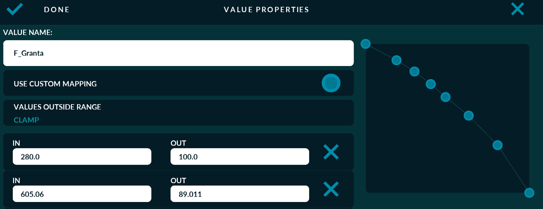

Please use custom mapping

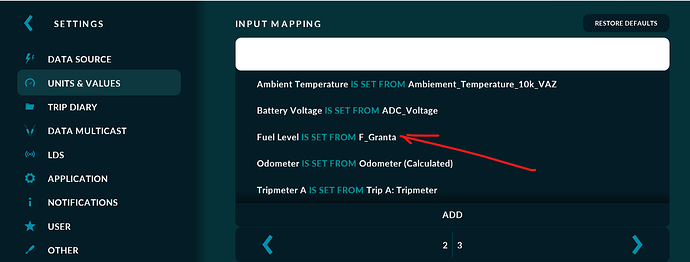

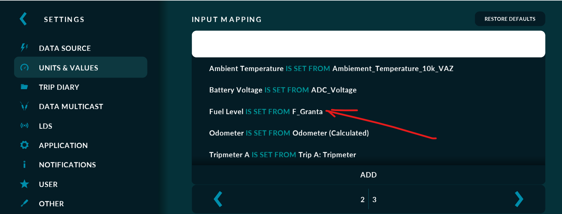

value name=“C_Fuel” offset=“1” length=“1” (any name)
next step
