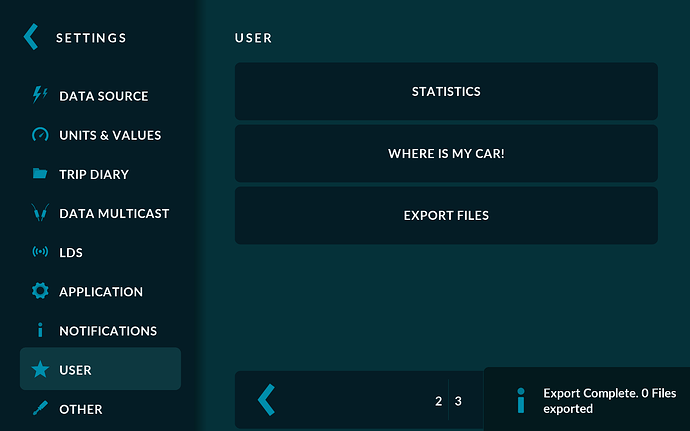

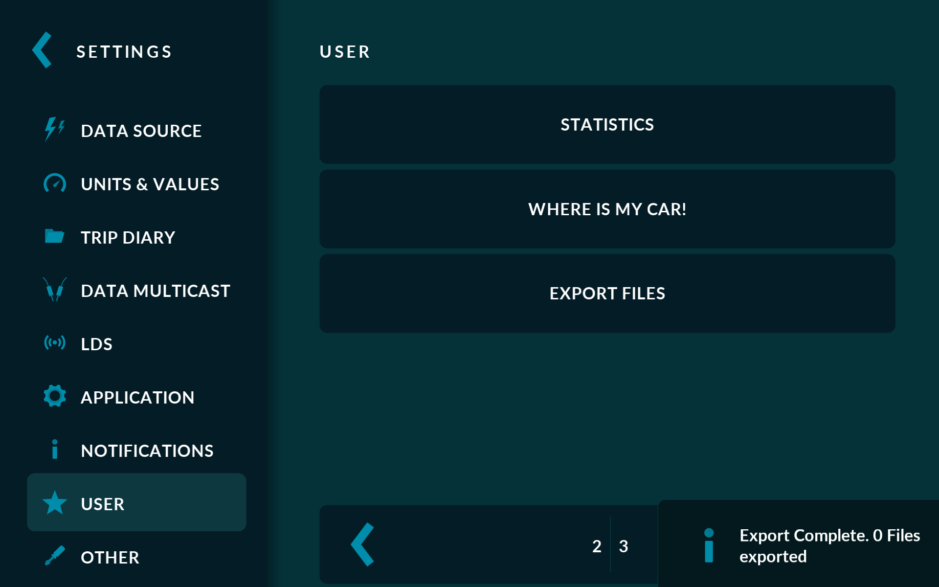

I tried exporting the files in bulk, but nothing was exported.

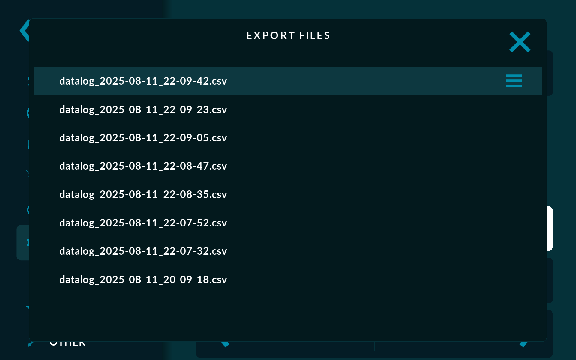

Also, is there a way to delete the logs stored in RealDash in bulk?
Currently, it seems that I have to delete them one by one.
No, currently you have to delete the log files one-by-one in My RealDash.

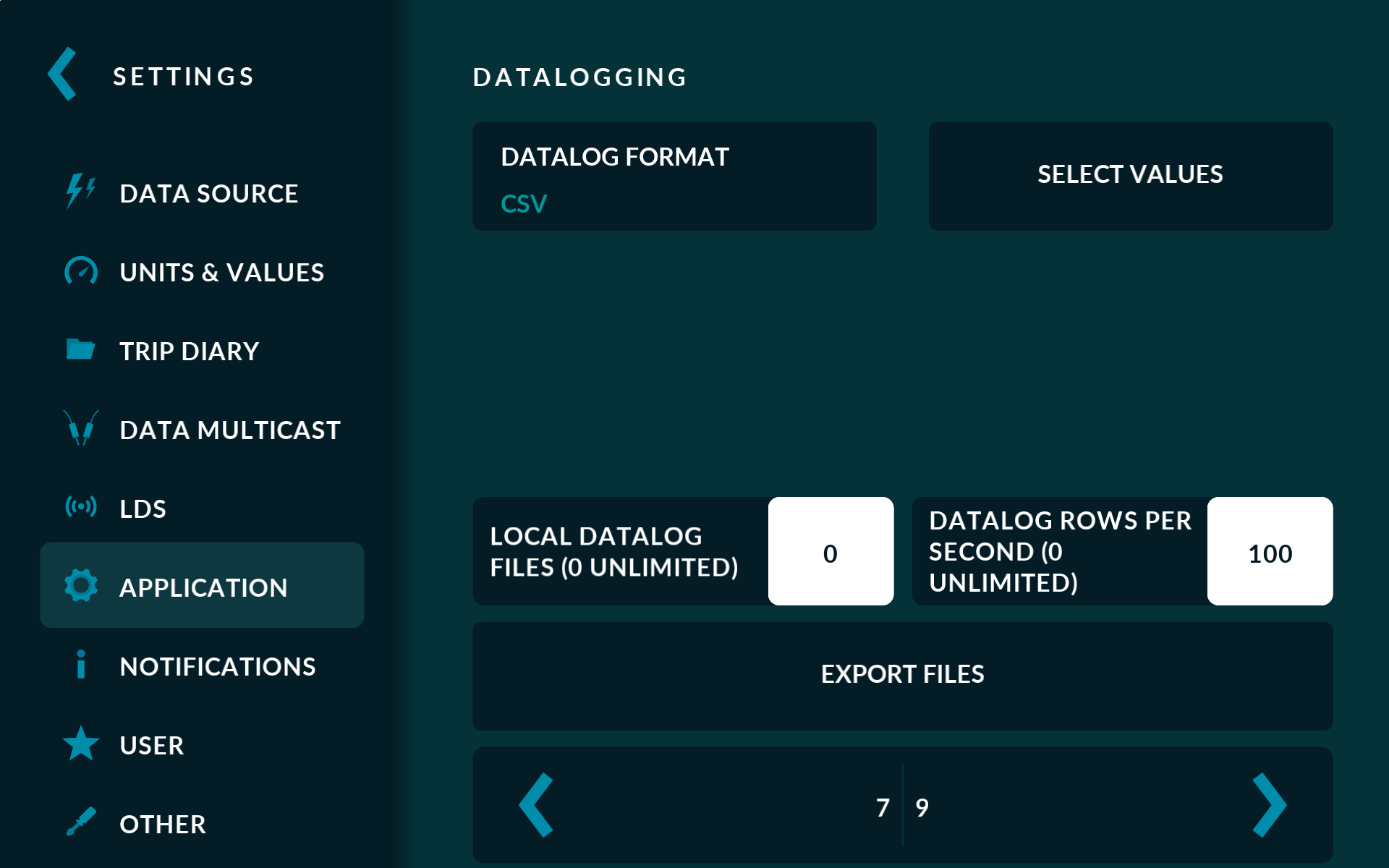

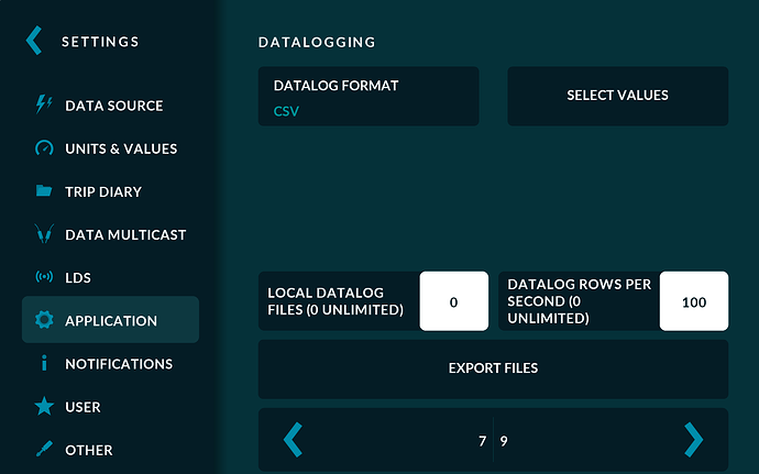

Is it the same for export?
There seems to be a menu for exporting everything at once, but nothing is exported.
Touch & Hold should select all items on the list.
I did some testing and indeed, we are getting ‘operation not permitted’ from the OS when trying to export all data from Settings. I will investigate further.
