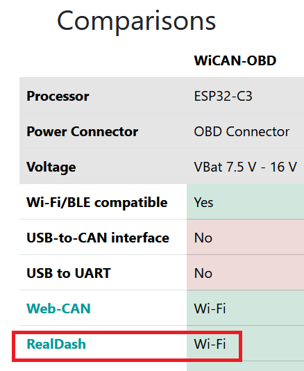

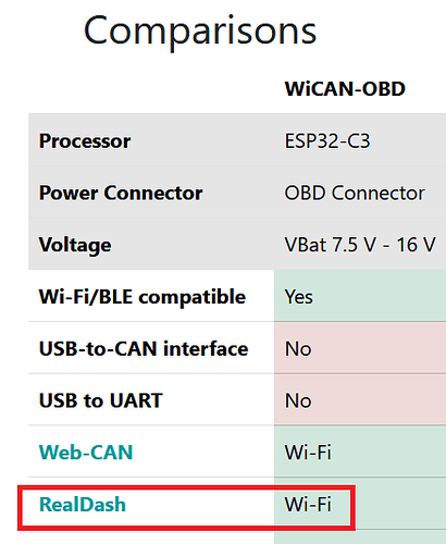

I am a little bit confused with the information provided at crowdsupply.com regarding to the Meatpi adapter: in the text you can read “The original firmware can use Wi-Fi or BLE to interface directly with RealDash…”, but in the comparision chart you can see:
From the chart it seems to be deduced that the device only interface RD using WiFi, but the truth is that RD lets me choose between BT or WIWI/LAN when I select the MeatPI CAN adapter.
