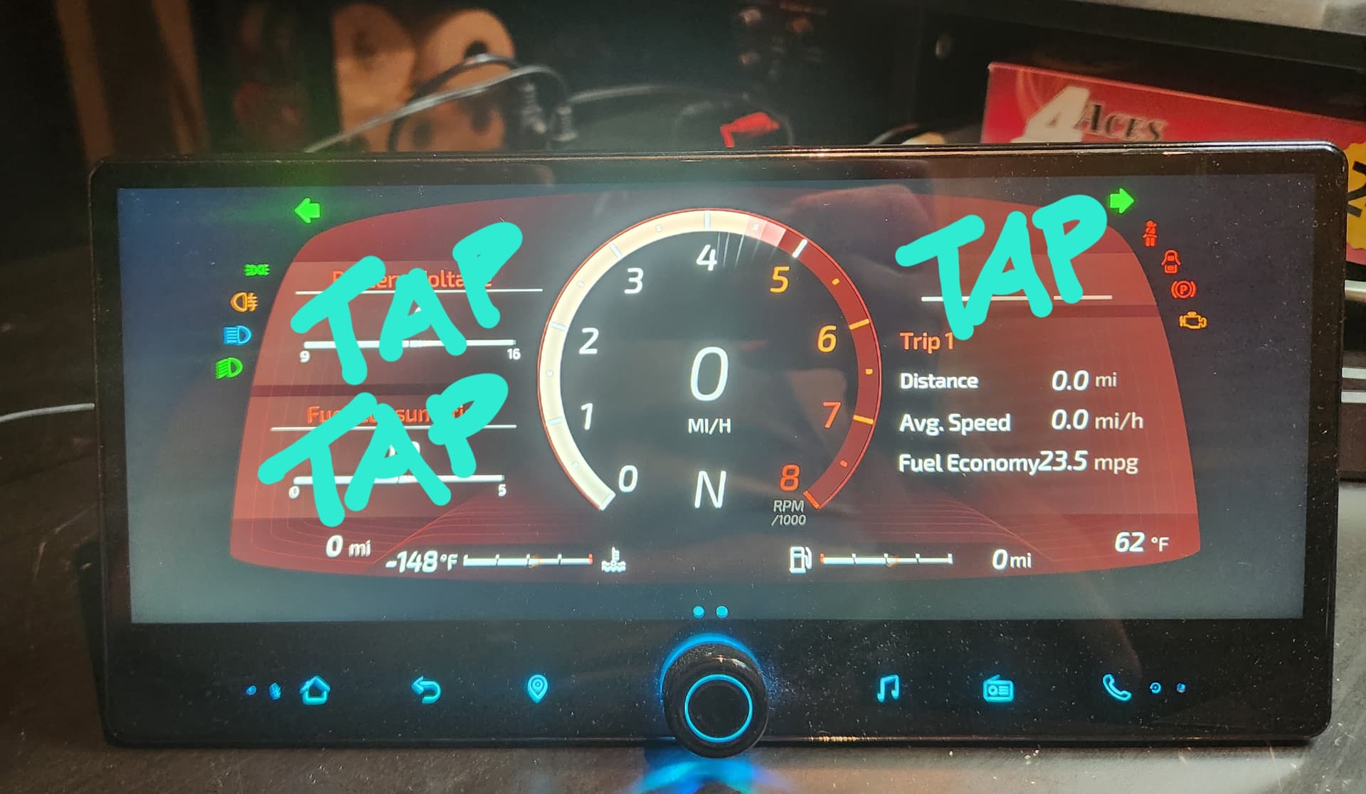

Within the C8 Theme, I have found 3 places on the screen to tap and reveal different information- i have indicated the areas on the attached photo.
If I were to provide 3 buttons, can they be assigned/mapped in a way that copies tapping the screen in those 3 places? I would like to toggle the different readings with my steering wheel buttons, and avoid tapping on the screen at all if possible (only when editing etc).

I think they are mostly there already with input called 'Steering Wheel Button #".
You can simulate steering wheel buttons 1-9 with keyboard. Simply press number 1 to 9 (not from numpad) and that will send a simulated steering wheel button press.
Oh wow , thank you for telling me!
