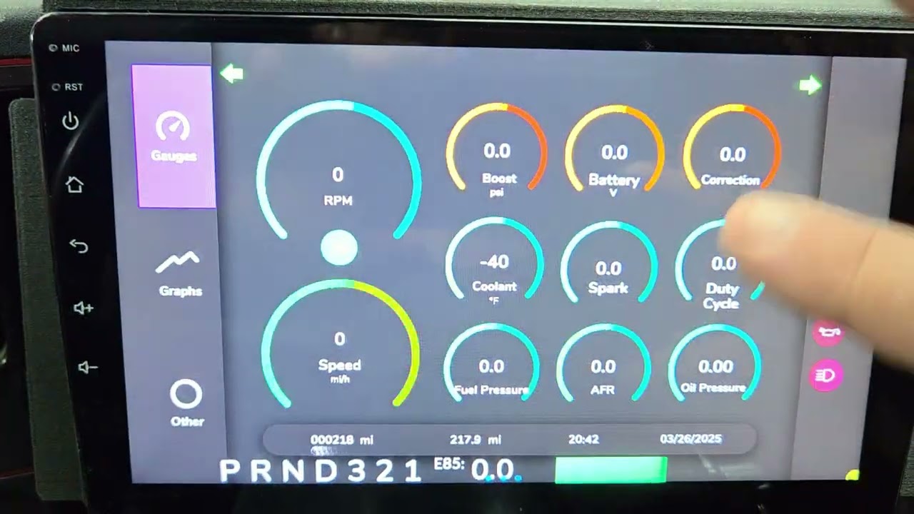

Using the holley_efi_can.xml edited to my ID allows real dash to see data from either adapters. Also can view data in can monitor. Change to the Holley: HP Dominator & Terminator X option from the list and there’s no data in real dash and timeout on the can monitor.

I can create a video this evening if you want.
Please do, it may help me understand what is going on.
Thank you for the video, this will clarify the issue for me :+1:
We do not have an actual Holley ECU to test on, we use CAN simulator; on which its working fine. I will try to build more of the same setup that you have with two connections and try to re-produce this issue.
