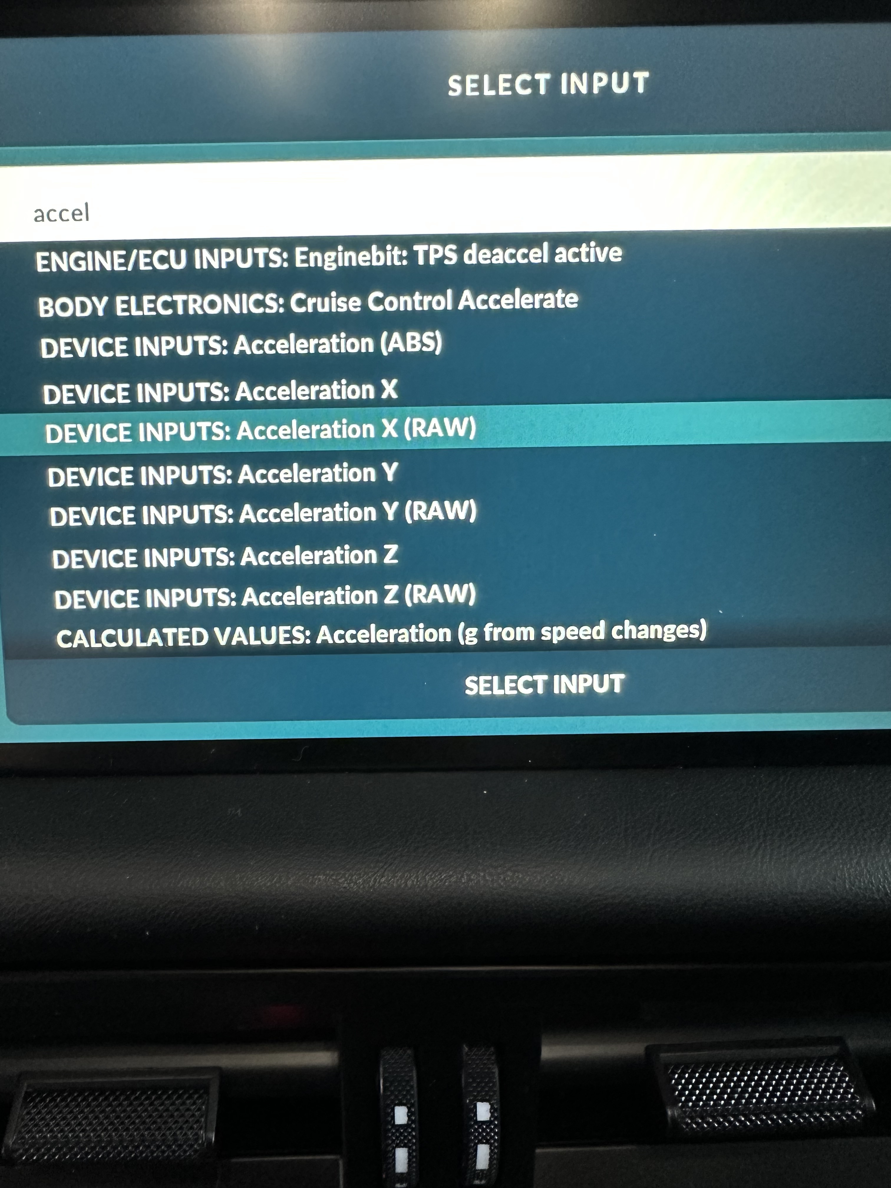

Hello, Is it possible to make an acceloemeter work in RD with only ELM27 inputs ?

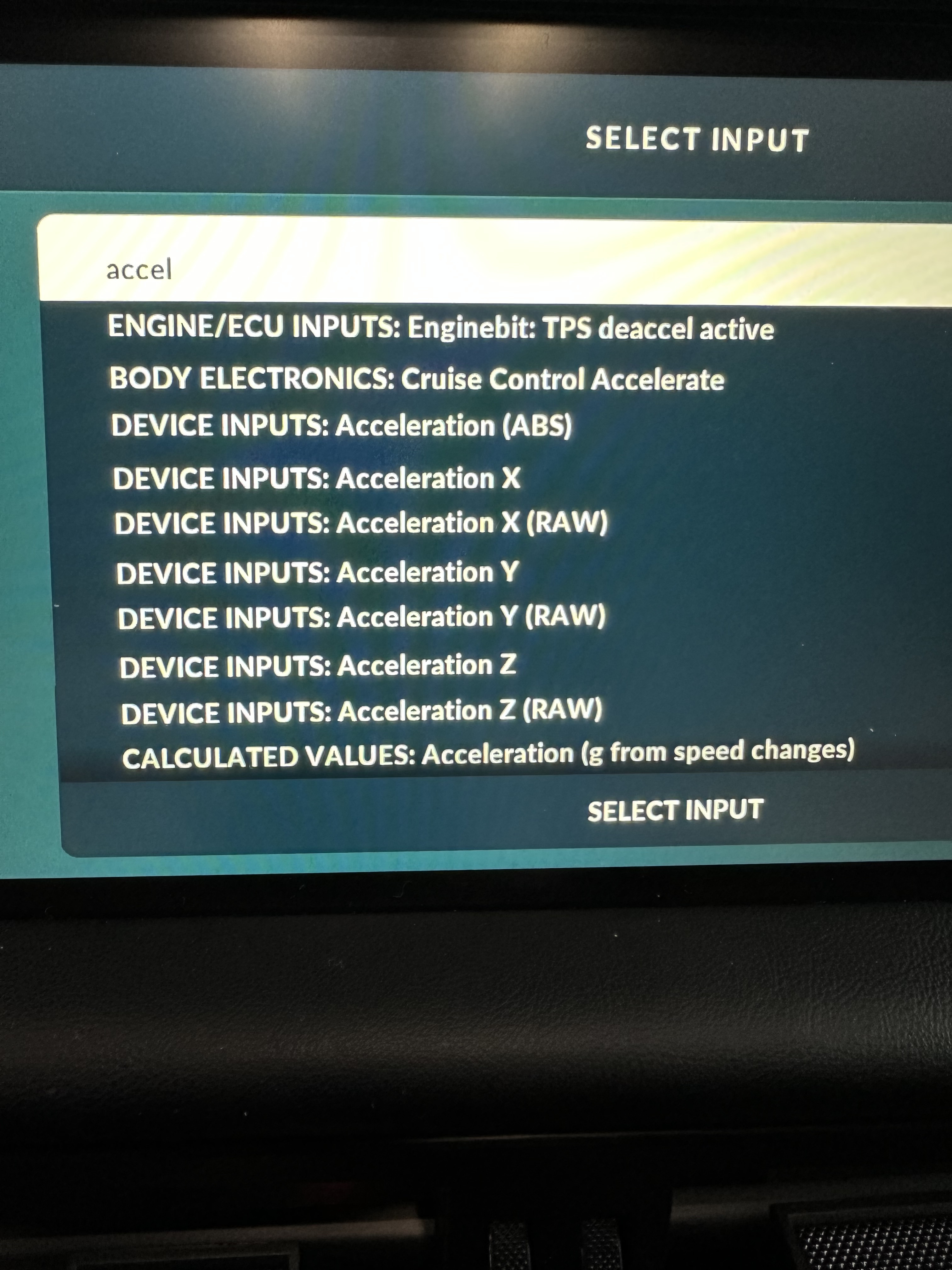

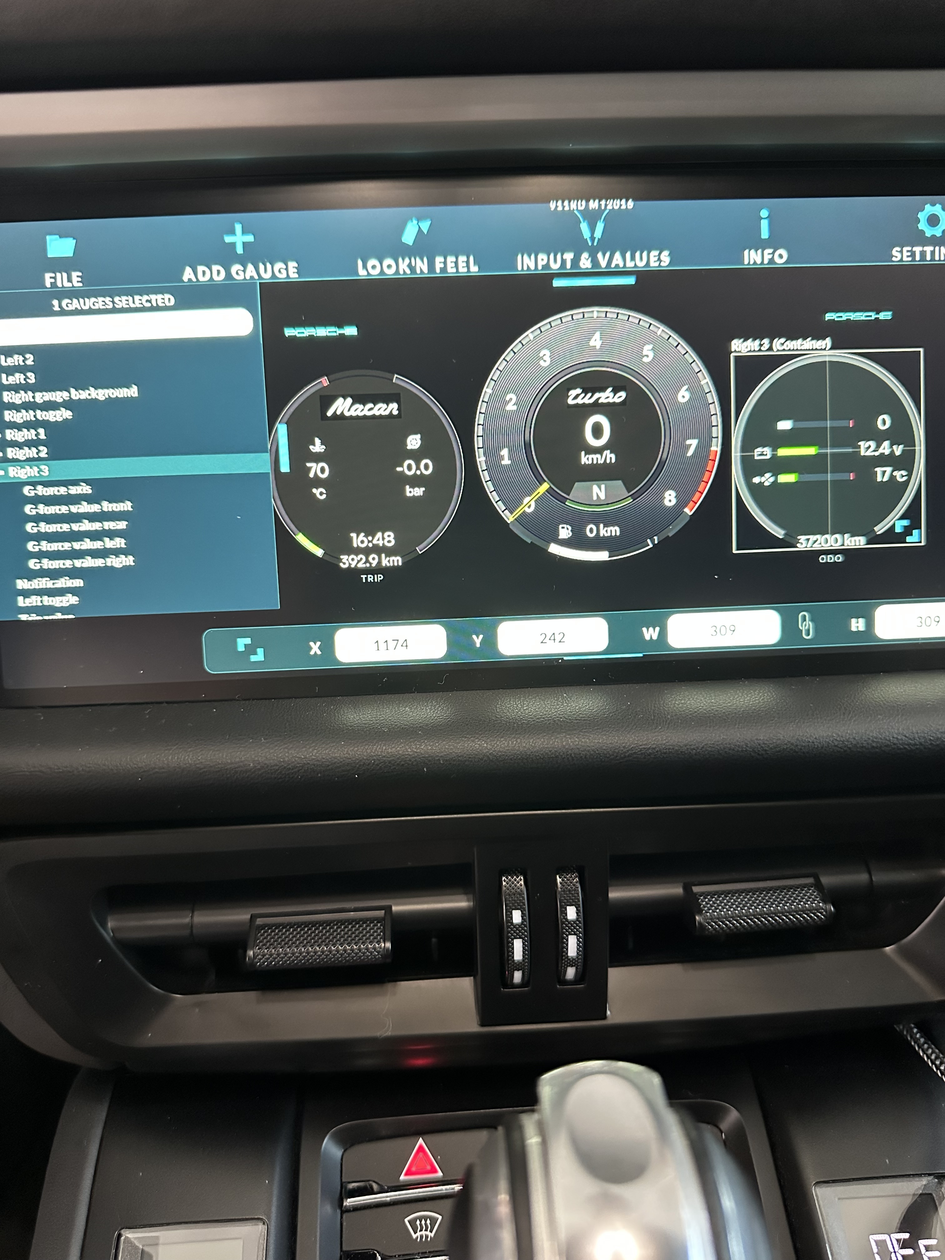

I am trying to make the new Porsche one work. Here is a picture of the RD object, and the available pids I see during set up. The GPS is also working as maps are accurate in this dash.

Hello @realdashdev , I posted above the pids from my obd…I do not see accelerometer. pids… any help on this >? I do believe that Torque was seeing them on this device…

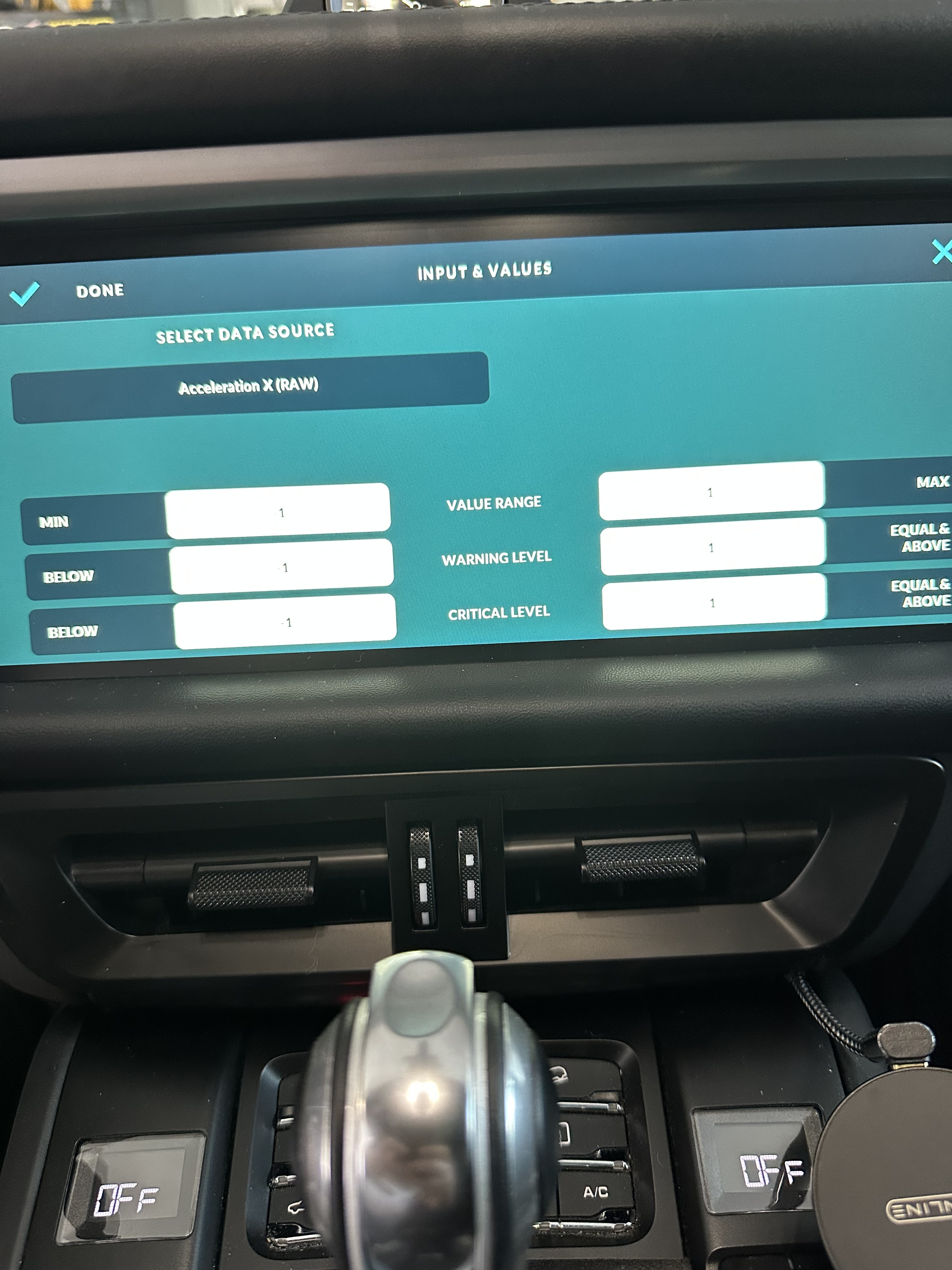

  • In dashboard, go to edit mode and select the accelerometer gauge.
  • Go to ‘Input & Values’ and change the data source for each axis on the gauge to your custom input.
Thanks for the reply , I guess I get to the point where I can pick raw or not , but I have no clue that’s referencing the OBD ?? How do I know that ?? And how do I know it is seeing the OBD pid ? Thank you
