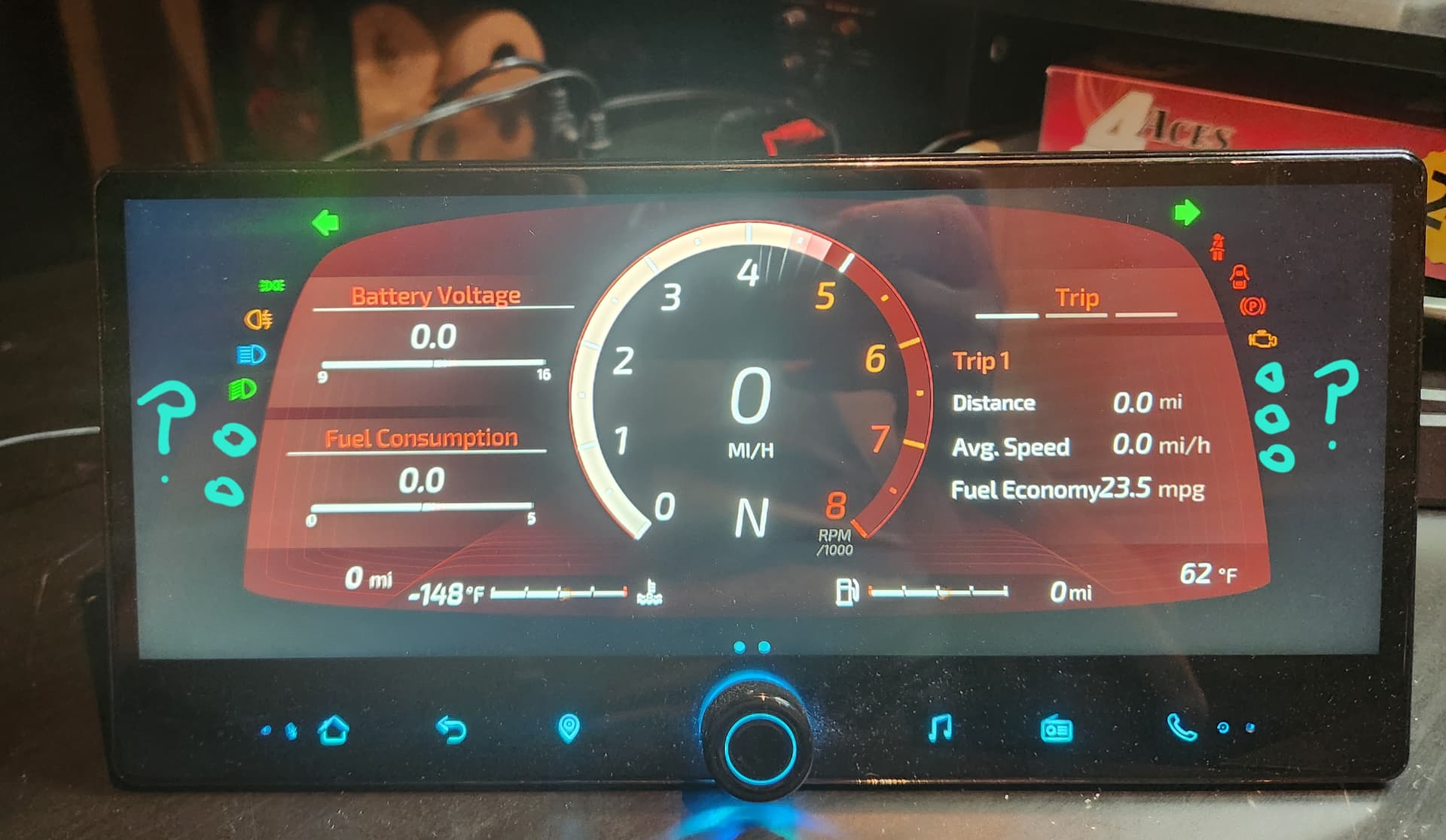

I have another question about the C8 theme. I have been informed that the premium themes cannot be modified, but i am wondering if i can add some extra indicator icons to the theme?
I have edited the photo to show where i had in mind to add them - right along side the original indicators.
The icons i have in mind are an “AUTO” icon for when my automatic headlights are turned on, a “DRL” icon for DRL lights, a “Tailgate” icon to show when my tailgate is open, and possibly a “Washer” icon to show low washer fluid.
I will be using OneGauge to send the information over to realdash, and i would be creating the icons myself with Adobe programs.
Thank you as always for any help with my constant questions :hugs:
Cheers
I think it is possible to add indicators to C8 dash. You just have to be careful that you save the dashboard when its animations are in ‘neutral’ state. All animated gauges are saved in the state where they are at that time, so animation states may get confused.

Yeah i took a look at the capabilities with the OneGauge hub and i will be able to have , i think, 19 indicators total with their add-on module. So , hopefully i can add all the info i want to the c8 theme which is easily becoming my favorite layout!
