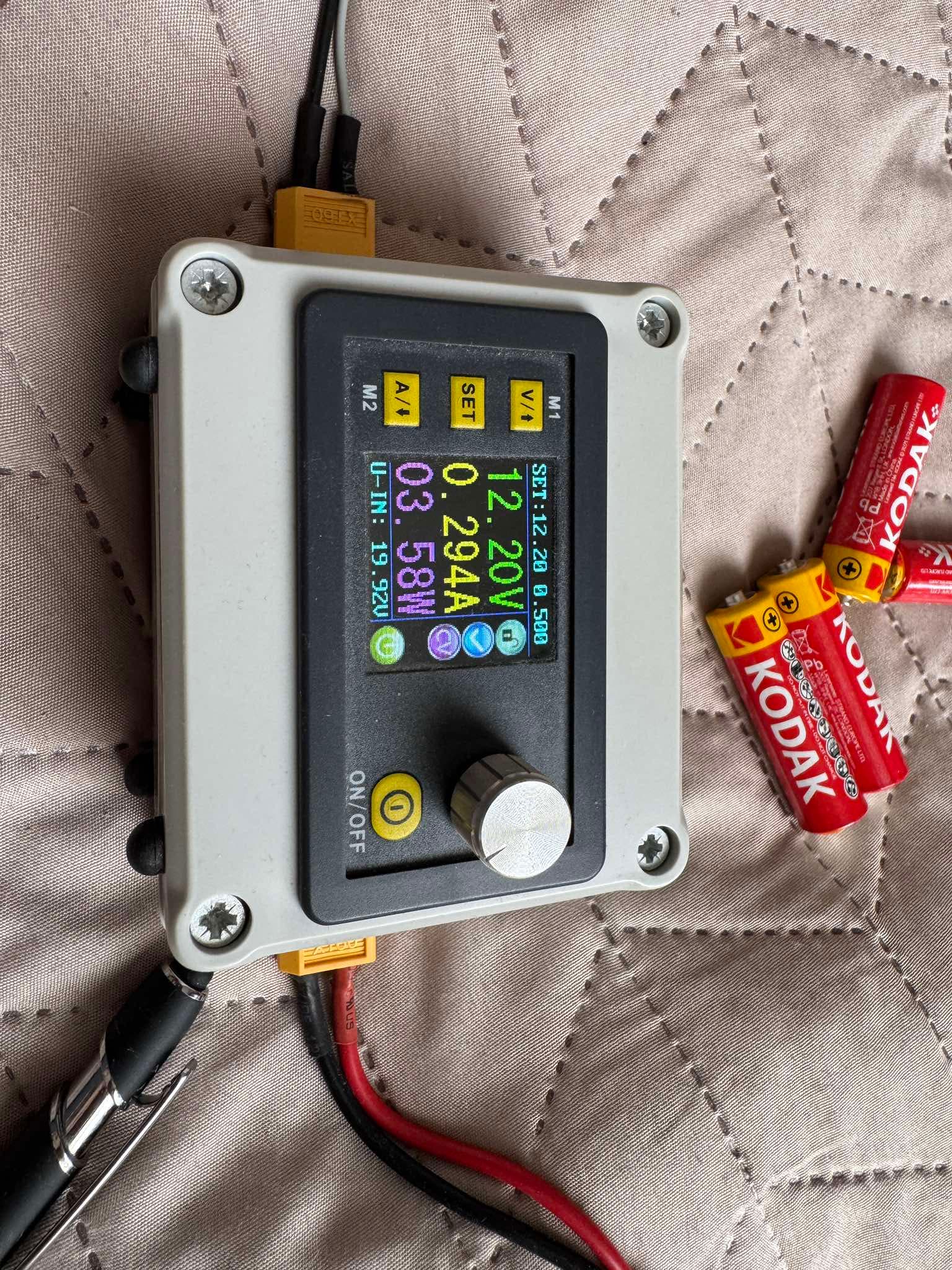

So have the WiCAN USB, connected to my PC.
Connect to WiCAN via WiFi: 192.168.80.1
setup:
  1. Go to configuration webpage.
  2. Select the baudrate
  3. Set “Port Type” = TCP
  4. Set “Protocol” = reladash 66
  5. Click submit changes.

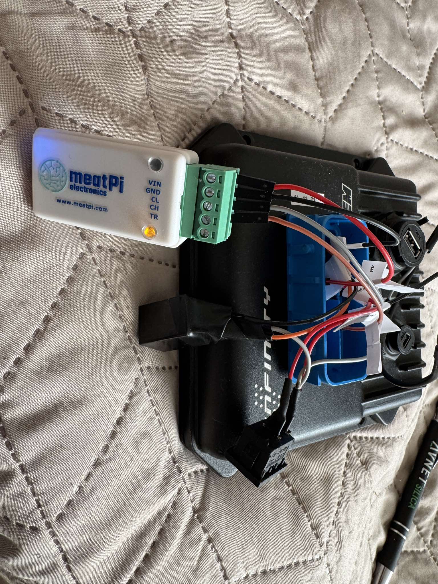

done it it works.
conencted wiCAN to the AEM infinity ECU via canbus which is used for the AEM dash. (and added 120ohm resistance what the AEM dash have.
Now finallllllllllllllllly I can see data on my phone.

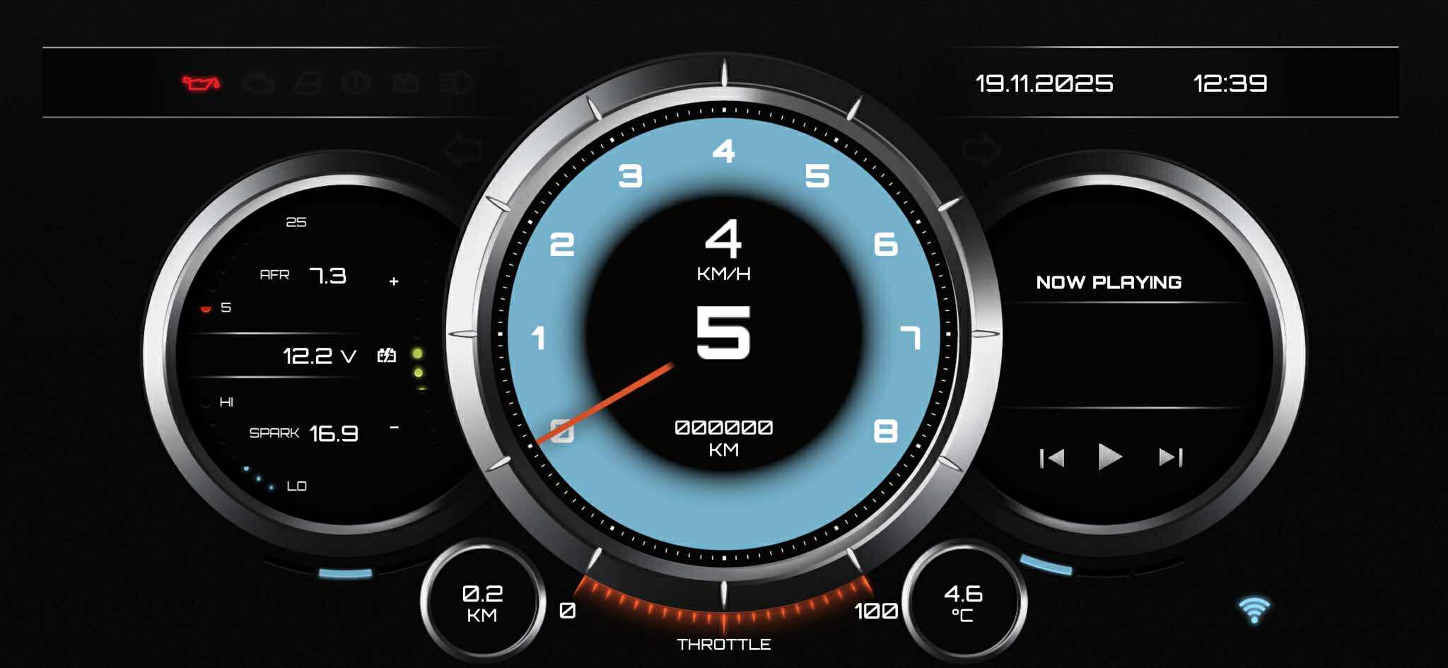

Now just need to make the most simple gauge skin for realdash, with the temps and pressures and done, no fancy things.
