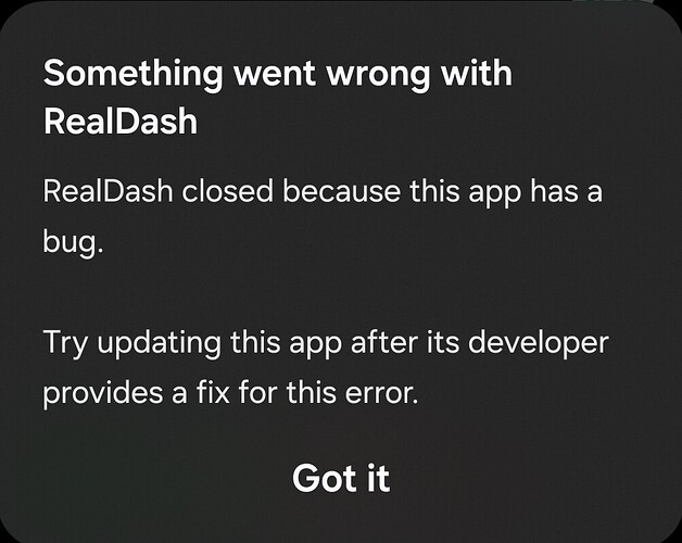

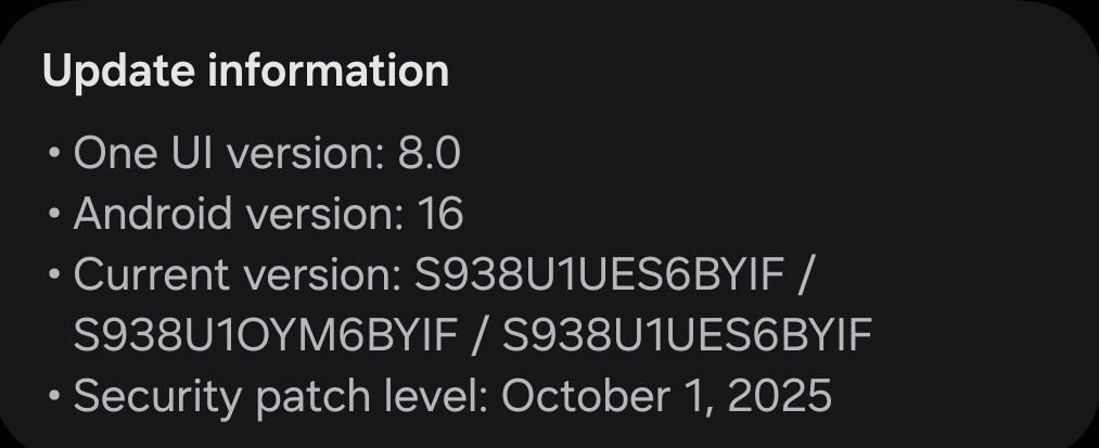

Hello,
My phone updated to Security patch Oct 1, 2025 for Android 16 yesterday (One UI 8.0). Now the app is crashing shortly after starting. I’ve tried uninstalling, clearing cache, and restarting the phone. If you know of a way to pull up the debug report, I’ll submit it.

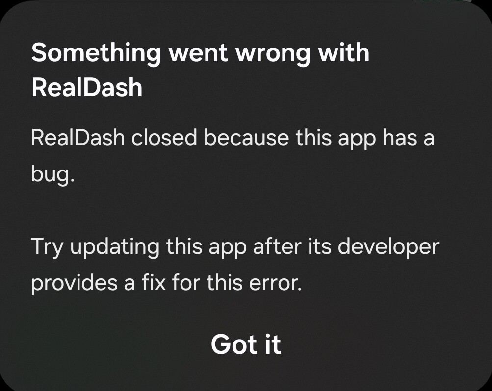

I spoke too soon :expressionless_face:. Problems are back.
Maybe this is related to your custom dashboard file? Send me your .rd file for analysis: contact@realdash.net
