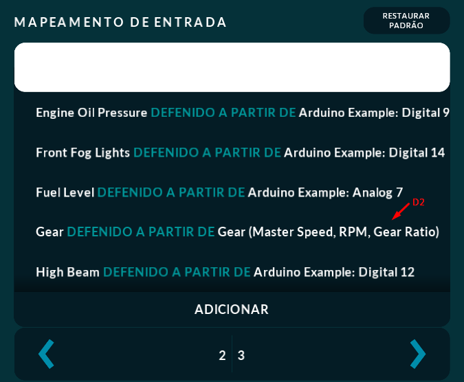

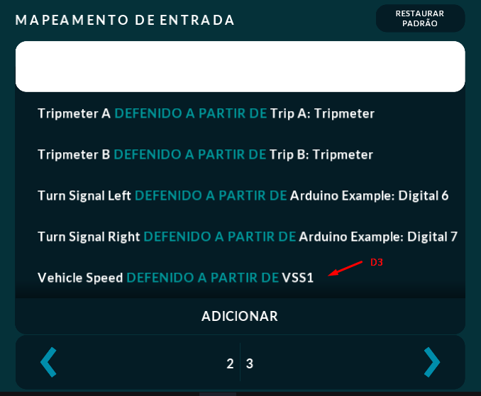

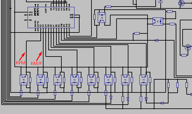

like in the connection of my schematic the RMP is in digital 2 and the Speed is in digital 3 but there in the Realdash settings it is as “Gear SET FROM Gear” and “Vehicle Speed SET FROM VSS1” I wouldn’t have to define there the ports used in the arduino as RPM = digital 2 and Speed = digital 3, or I’m wrong, or this configuration only occurs in the dashboard image like the RPM and Speed are configured in input values in each one

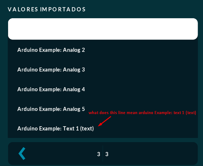

and what does what is in the image below mean arduino example text 1 what is this line for on page 3 of imported values what is the function of this line in relation to the arduino and its pins
