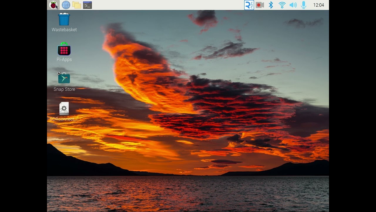

I just went through this the other day and after unsuccessfully trying a few methods, found this Youtube video:
You download a program called botspot/autostar and enter in that what you want to start at boot up. Maybe it’s not the cleanest or most lightweight setup, but it worked flawlessly after multiple other attempts. My Pi starts into Real Dash with it fullscreen and everything works great.
Mclovin1501’s code did not seem to work for my Pi 5, but it is very similar to what AI was giving me. It is just a minute or two after the desktop has loaded before RealDash starts up.
