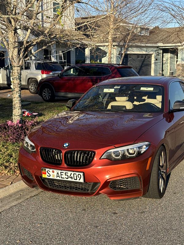

It is a 2018 BMW M240i with the B58 added a ethanol content sensor so that is an added sensor that is in my XML.
