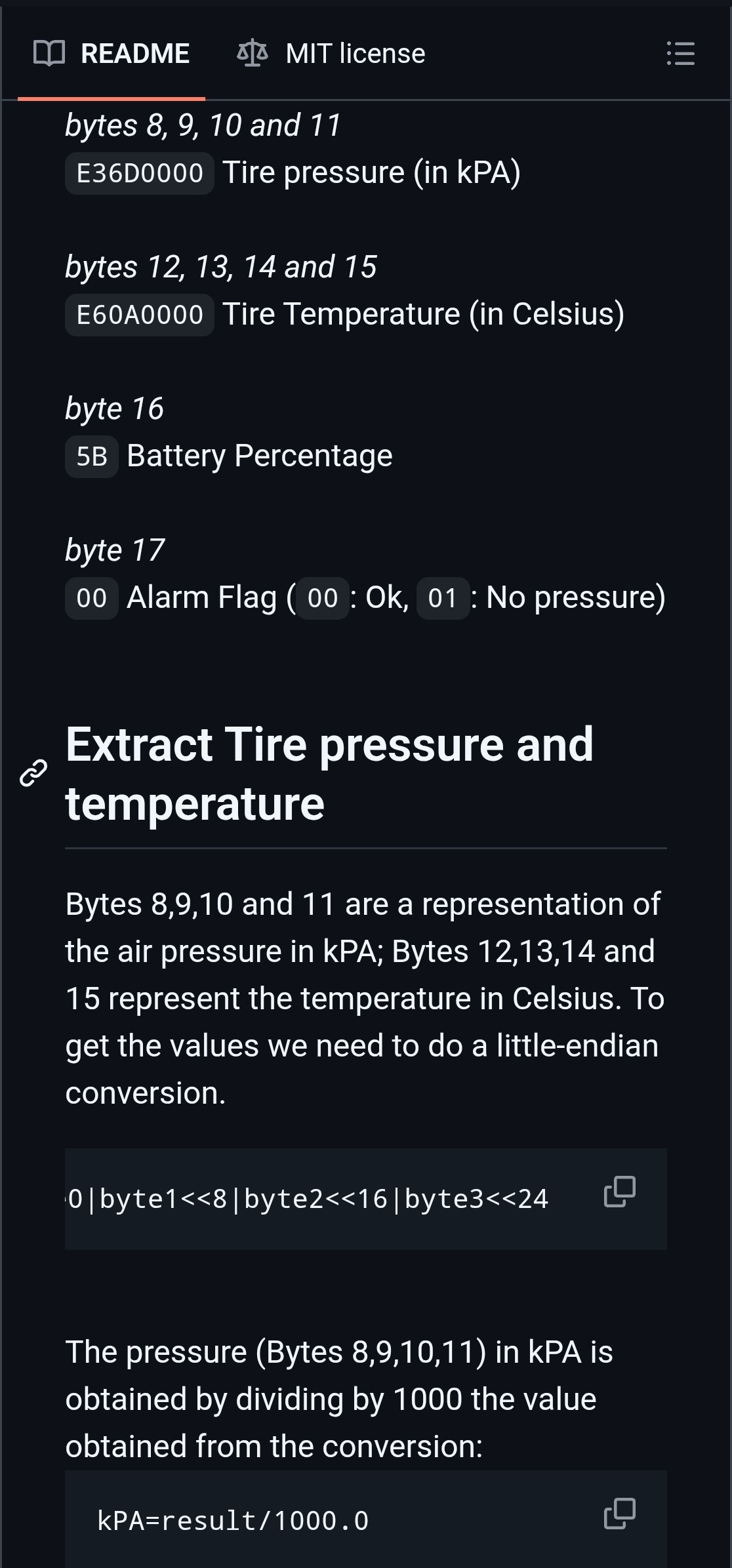

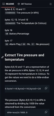

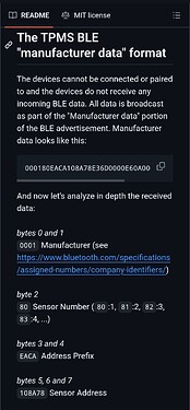

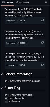

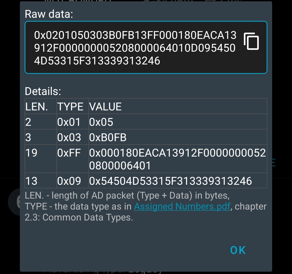

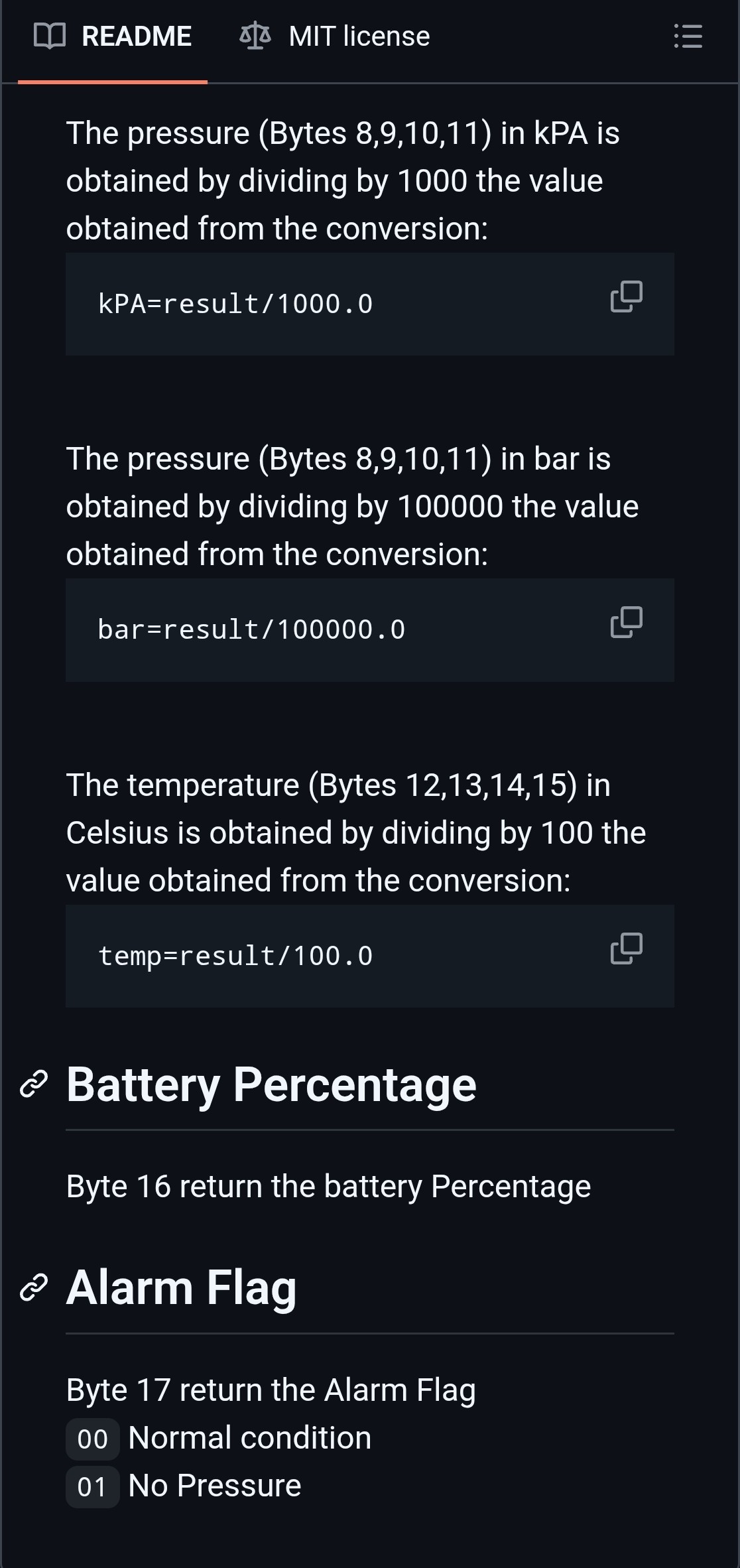

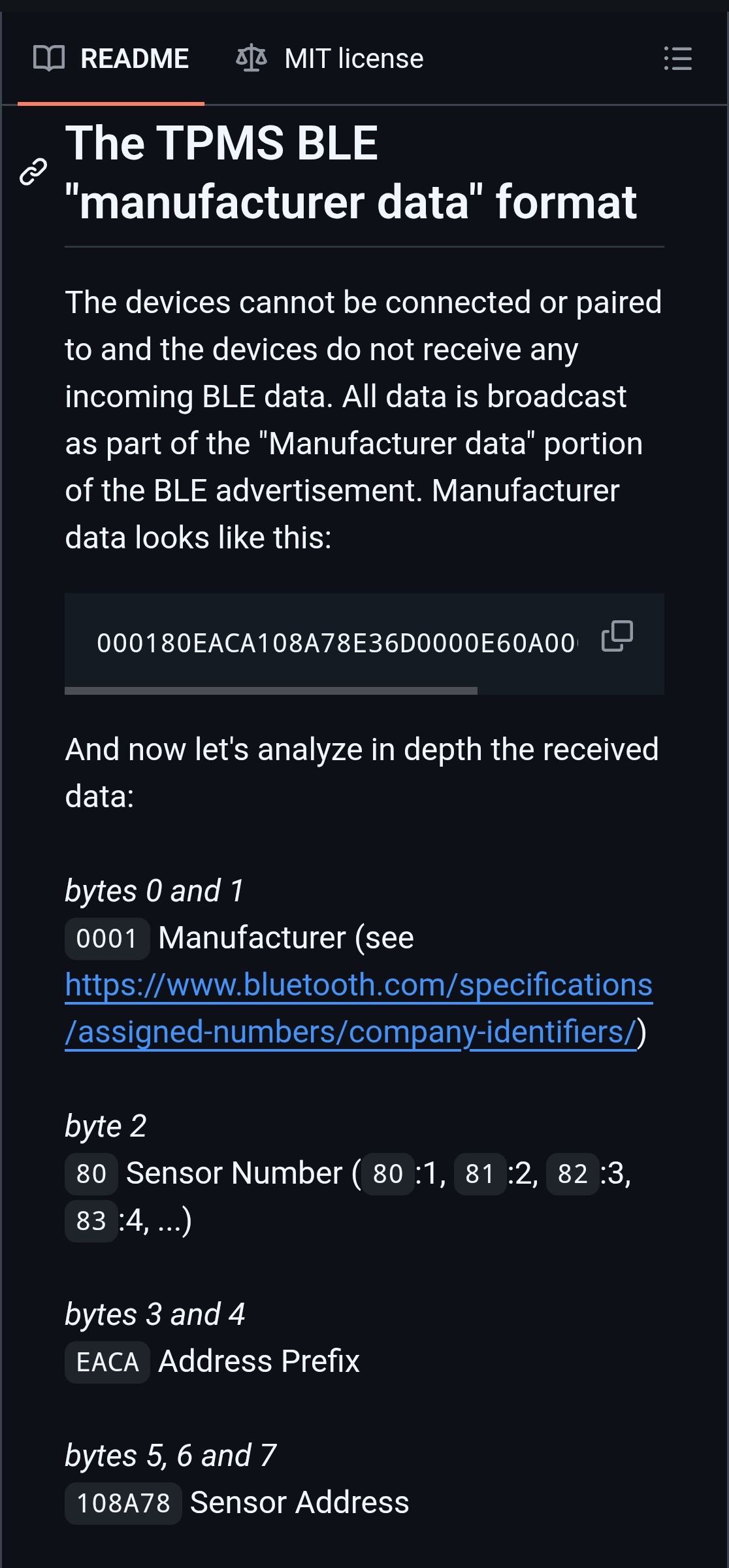

I sniffed the sensors with nRF Connect
Lucky me was already decoded, I found it on GitHub
So I wrote the can description file
(I was lazy and I drop on AI eheheh)
<?xml version="1.0" encoding="utf-8"?>
<!-- SENSORE 1 -->
<frame id="1" endianness="little">
  <value name="Tire 1 Pressure"    units="bar" offset="0" length="4" conversion="V/100000"/>
  <value name="Tire 1 Temperature" units="C"   offset="4" length="2" conversion="V/100"/>
  <value name="Tire 1 Battery"     units="%"   offset="6" length="1"/>
  <value name="Tire 1 Alarm"                   offset="7" length="1"/>
</frame>
<!-- SENSORE 2 -->
<frame id="2" endianness="little">
  <value name="Tire 2 Pressure"    units="bar" offset="0" length="4" conversion="V/100000"/>
  <value name="Tire 2 Temperature" units="C"   offset="4" length="2" conversion="V/100"/>
  <value name="Tire 2 Battery"     units="%"   offset="6" length="1"/>
  <value name="Tire 2 Alarm"                   offset="7" length="1"/>
</frame>

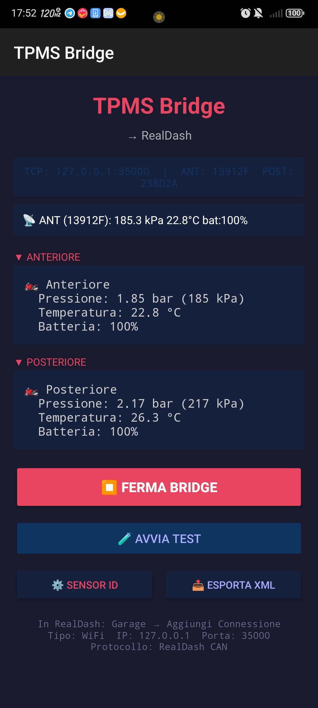

Now I’ll play with Android studio
I just want to share with you :slight_smile:
Something is moving
