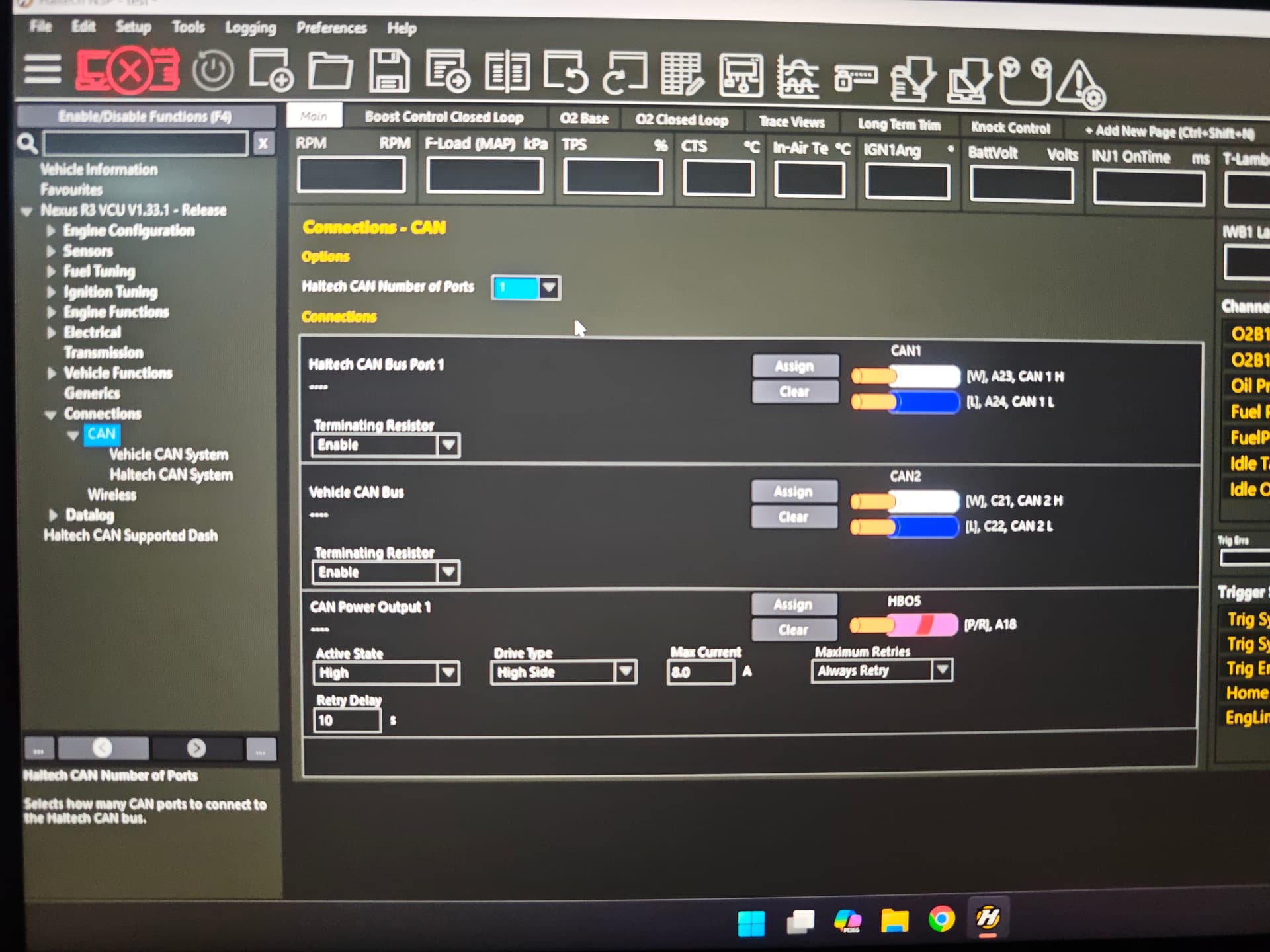

It seems like there is no longer a port option? Is this the same for others? I am using a nexus R3 and the latest NSP software.
Any direction on what the latest setting are would be a god sent as i have spent more time then im willing to admit publicly on this.
On R3 you go to Connections → CAN, select desired number of can ports and the wiring configuration:
Thank you for this. It turned out that my biggest problem was that you need to ground the adaptor on the CAN side as well.
I thought the CAN H and L was all that was needed and the power and ground were just for powering devices (and that was being done with the usb for the adaptor).
