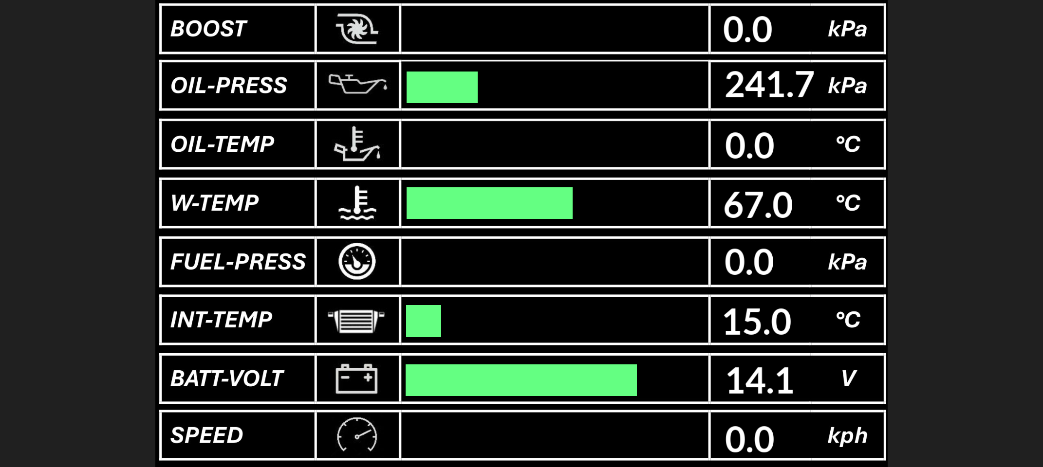

Have any of you had contradicting information/incorrect info on your dash?

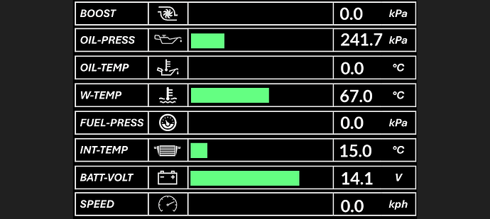

I’ve 2 of the same inputs on both my tablet and my phone and they are showing 2 different values.
Also my phone shows oil pressure but my tablet doesn’t.
Thanks in advance
Some sort of a configuration thing. Temperatures seem to be Fahrenheit on the bottom image and Celsius on the top. Oil pressure could be mapped differently on ‘Settings->Units & Values->Input Mapping’.
