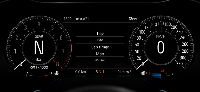

Could someone help me? I have a button configured—let’s call it Button 1—and I need it to do the following: when I’m on the “Map” tab, pressing Button 1 opens the navigation; however, when I’m on the “Trip” tab, pressing Button 1 resets the trip data. Can anyone help me set this up so the button functions differently for each of those tabs?
Uploading: IMG_1467.png…
You do have to create triggers and actions for this dashboard to achieve that. Warning though, our premium dashboards will be difficult to modify as they have complicated animation systems that may get broken while editing the dashboard.
