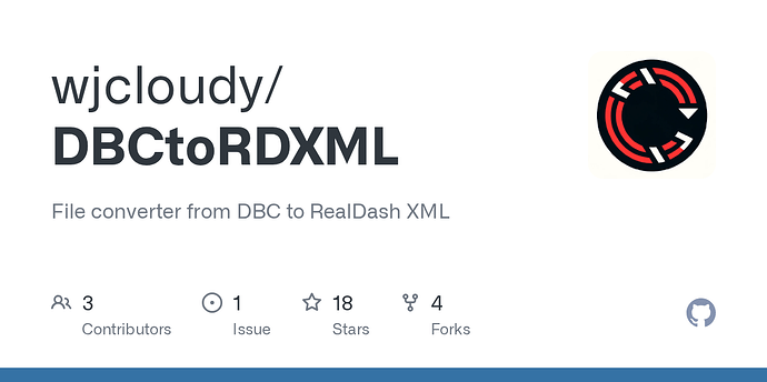

RealDash uses XML files instead of DBC. My RealDash web service has a DBC to XML converter which can give you a nice startup XML file.
I just used this and it worked/loaded up fine.
You’ll likely still want to manually crop down or tweak it quite a bit, but does a lot of the work for you. For example I’m going thru now and assigning targetId to the key sensors and removing stuff I don’t actually care about.
