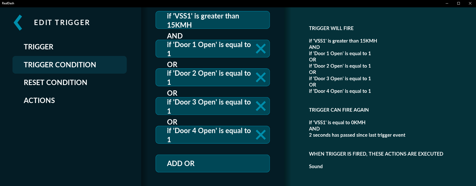

I think we have a problem here. I want to have a voice output when the speed is over 15 km/h and one of 4 doors is open, but only the first door works, all others are ignored.

If you please take the time to look at the screenshot, it’s correct, but it doesn’t work. I’m not criticizing anyone here. What’s wrong with you?
Dude, if you want all the doors to work, you’ll have to create a trigger and action for each door. The “AND” function adds triggers, the “OR” function activates the action by one or the other trigger. So create a trigger for each door and use the same action for all of them.

you think you wrote this:
vss1 and (door1 or door2 or door3 or door4)
but it turned out to be this:
vss1 and door1 or door2 or door3 or door4.
you only need to create two triggers, one to check the doors, the result of which is placed in a dummy-variable, and the second to compare the speed and this dummy-variable.
