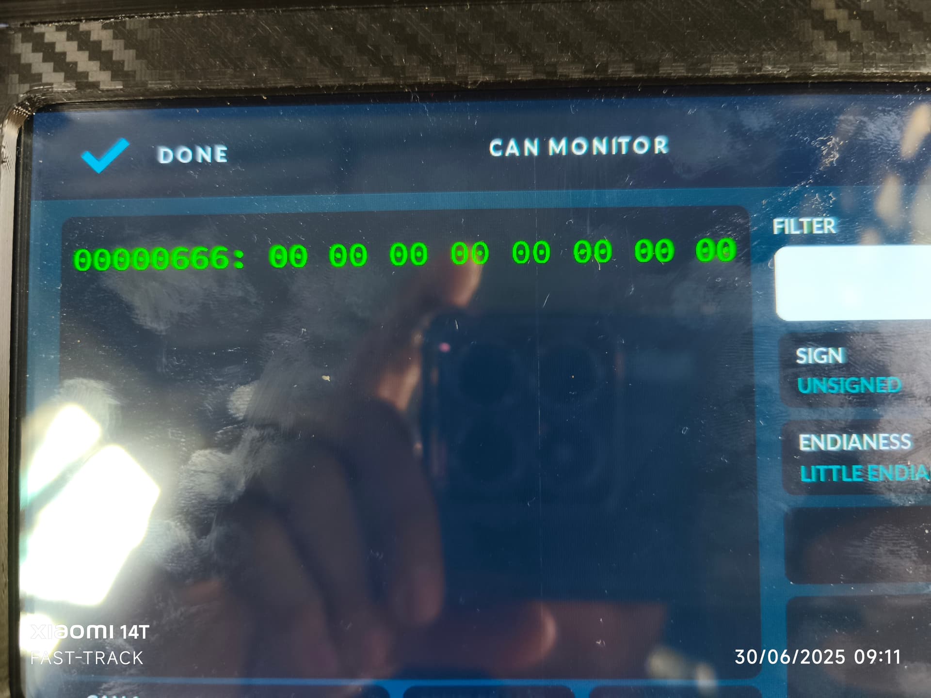

EcuMaster black Canmonitor show only id 666

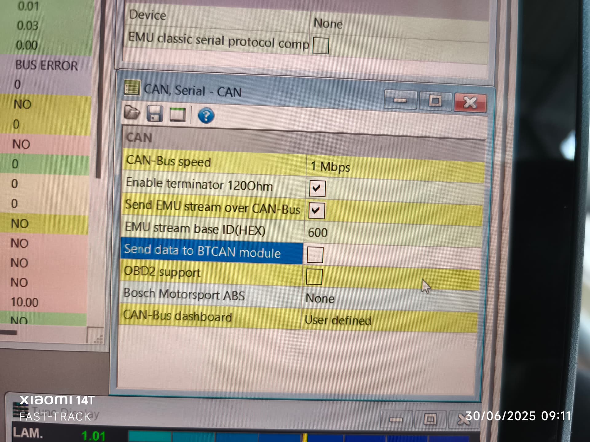

EcuMaster black i use can adptor connect realdash with usb. I check data Canmonitor show only id 666. Can ID 600 601 602 603 not show now display not respond canbus in ecu master ok and error blink all time.
I try to setting can speed 500k 1Mbit

I try to connect with canbus Bluetooth canmonitor can show only ID 0x666 the same usb can analyzer

On my settings, I have under can serial ECUMASTER logger EDL-1. From there, it’s that device that is sending to the realdash I believe. Are you using that device or something else?
Now it working from rs232. I make rs232 to ttl use Max232 and send data Bluetooth to my display
