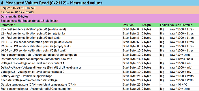

While searching for reliable data to calculate fuel consumption, I came across active queries for the factory instrument cluster (Renault Megdne 2 Phase 2 1.5DCi 2009).
(If anyone is interested, let me know.)
The responses to these queries contain a lot of useful data.
For example:
Fuel consumed (petrol) – Accumulated petrol consumption Start Byte: 12 2 bytes Big raw / 20 → liters
If I use my name in the .XML file: name=“TdB: Fuel Consumed” offset=“4” length=“2” endianness=“big” conversion=“V/20” units=“L”
Then the text guage shows the correct value. But if I use TargetId: Fuel Consumption (Liters or Gallons per hour) - 407
targetId=“407” offset=“4” length=“2” endianness=“big” conversion=“V/20” units=“L”
Then the value starts to jump and jump, as if something else is broadcasting to ID 407 and interfering with my value.
If anyone knows how to fix this, please let me know.

Try ID 490, ‘Fuel Flow’ as in litres per hour. That is the main input for RealDash fuel consumption calculations.
It sounds like the two values may be coming from different calculations or OBD parameters. I’d first check that both are using the same units, fuel type, and ECU data source. If possible, compare the raw fuel-flow and distance values too, since that can help pinpoint where the mismatch is coming from.
Thanks everyone; fixed by changing the source in the input mapping.
