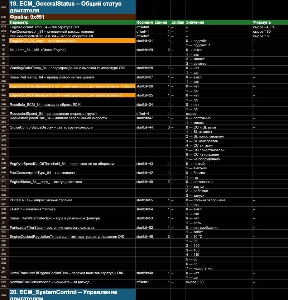

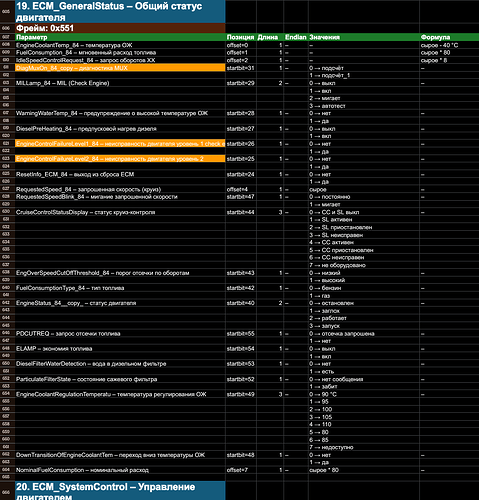

I’ve completely decoded all the passive signals on the CAN bus, all possible blocks (39), Renault Megane 2 Phase 2.
Where can I share these files and are they needed here?
I can’t understand. At the beginning of this thread, you described that Renault only has a 0-255 counter (which is what I have). This, as I understand it, is targetId=“490”. What is being transmitted in the frame in the screenshot? Renault doesn’t have an equivalent.

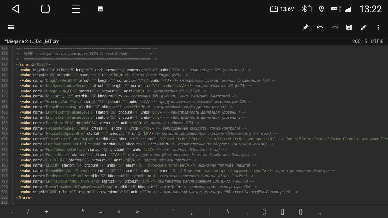

Screenshot_2026-07-02-00-21-41-376_bin.mt.plus
please check global triggers
Yes, global triggers have appeared, but that’s not the question. Target ID 490. I understand this to be the same counter that counts from zero to 255 and then back to zero, the current consumption counter. But what is passed to the Dummy 11 fuel consumption variable if only the above-described counter exists?
sorry/// no have time/// i need summer holidays too/// check my file - he work in real cars
