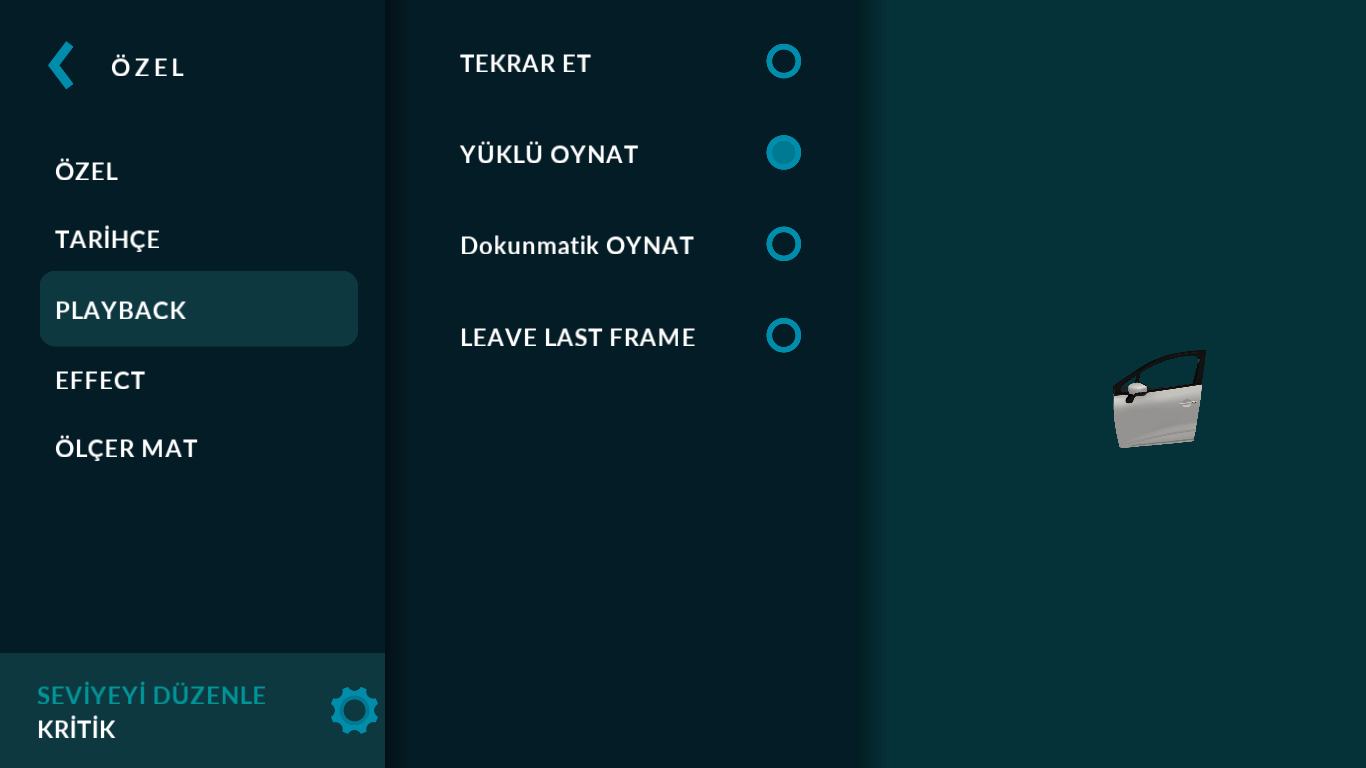

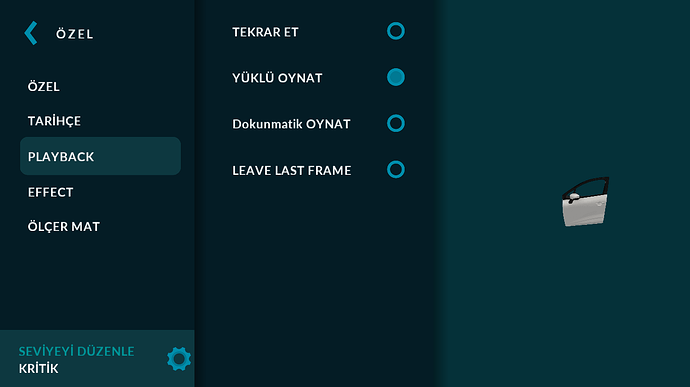

Ok I found the solution,
I selected critical in the visual and marked it as on the screen. and I made the visual itself a door entry, this is how it happened, when my dashboard opens, the video plays if it is door1.
