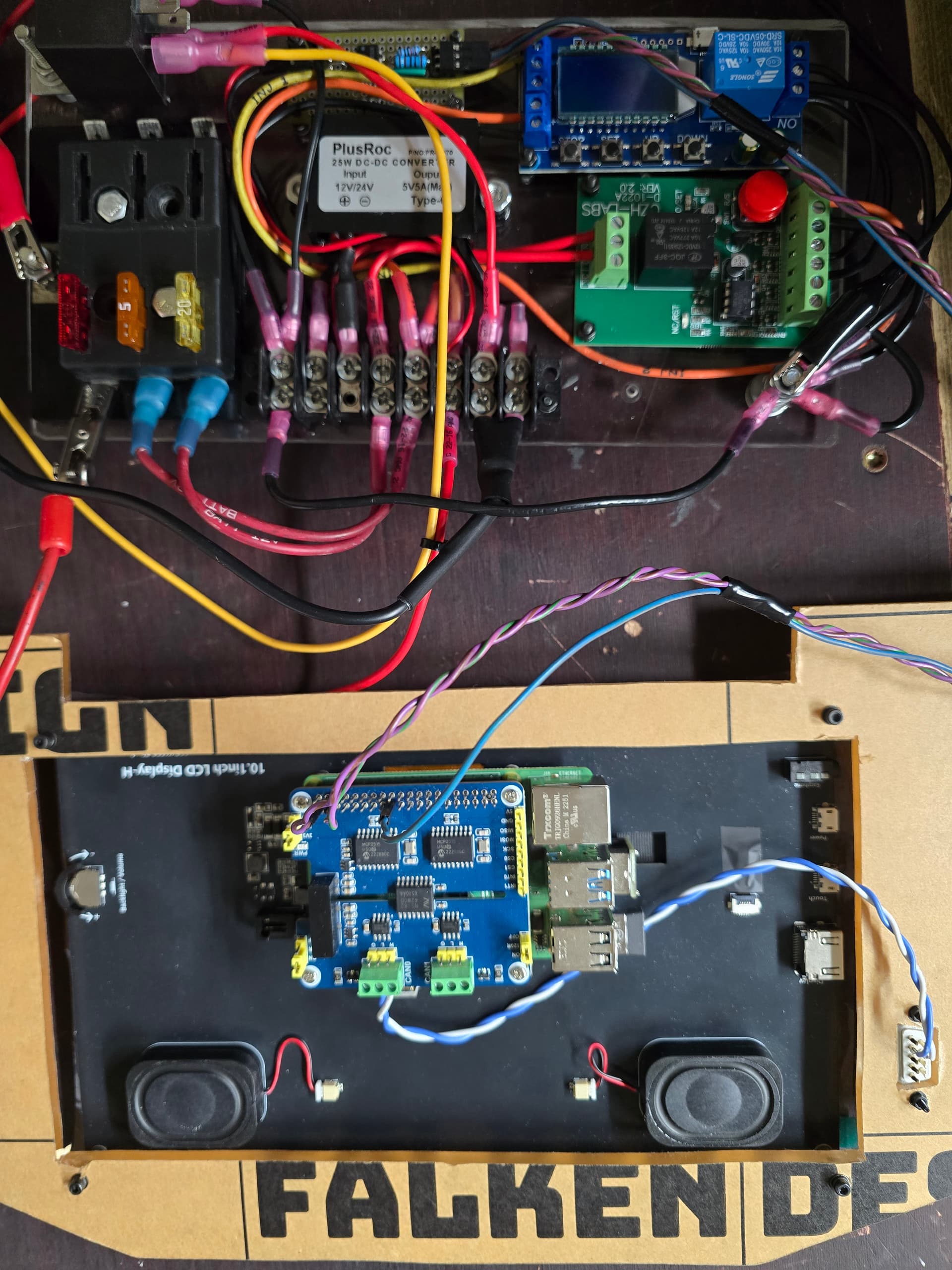

I have been struggling with the power management myself.
I think that I just about have it figured out here:
But, I am still getting a shutdown dialog (shutdown/log off/change user) when I withdraw my key.
The optocoupler on the wiring board senses the key withdrawal (KP2->KP0) and the GPIO gets a 3.3v signal to initiate shutdown.
Would you be able to send command:
sudo shutdown now
When you receive the shutdown signal from GPIO?
