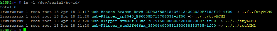

Hello is there a way to hardcode a by ID for real dash serial devices? I have a good few serial usb devices and they swap arround every reboot on the ttyxxx.
Used alot with 3d printers.

No, the by ID takes the ID from the device and will allways be the same no matter the reboot or other stuff. Only thing that can change the reported by-id is a firmware write to the adapter or alike.
The dev/ttyxxxxx will allways move on reboot. Mine have done that 4 times now, kinda annoying to go in after starting the car to change it :blush:
I guess I culd do a symlink to by-id/xxx into /dev/* to get realdash to see it.

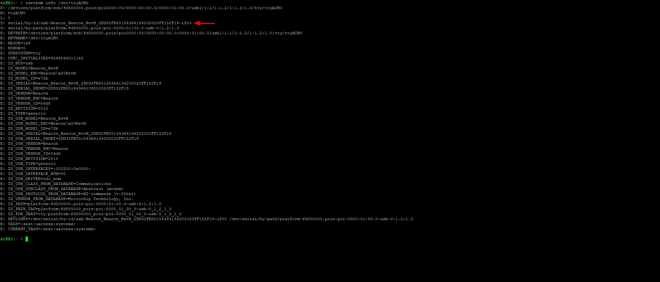

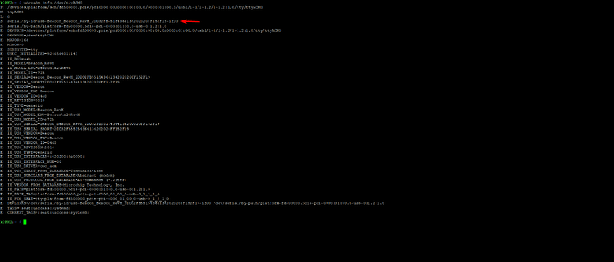

Or can you tell what realdash is looking for in a serial dev/tty* so we can use Udev to make a link that do not change? Im guesing a parameter in Udev? As making a link in udev with just ID_MODEL_ID and ID_VENDOR_ID do not get registered in Realdash. Or if theres a .ini file where the link is that i manualy can edit?
you can see the udev creates the /tty* random but based on the by-id.
