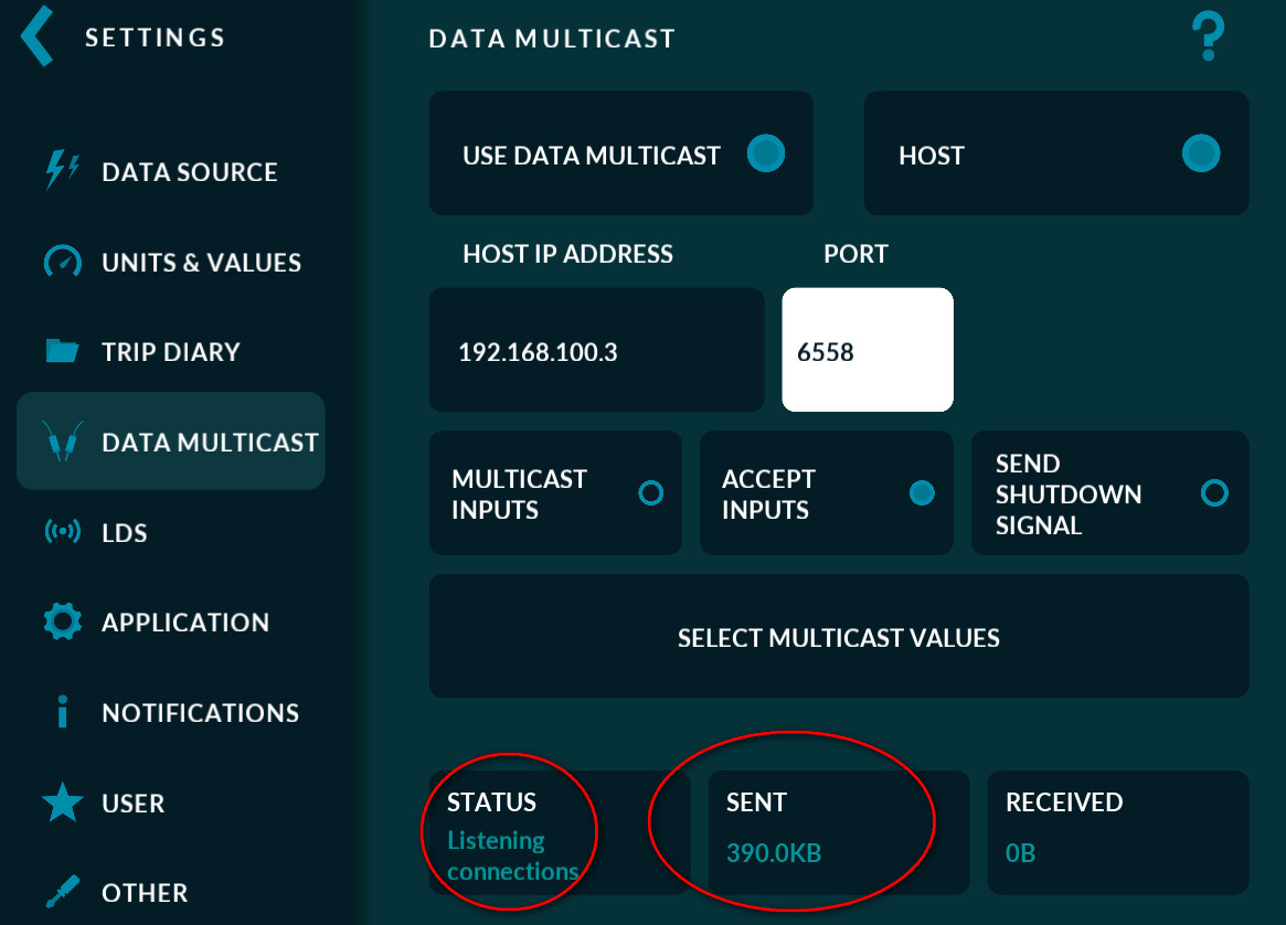

How to activate touch between screens via multicast. I did not find the method. and the transfer is done well and works without problems.
You need to add an gauge that acts as a ‘Touchpad’ on a device that is multicasting inputs to others. Go to ‘Gallery->Examples’ and download ‘Remote Controller’ example to see how touchpad gauge is defined.
Thank you, Janim. I succeeded in controlling more than one device. I thank you again.
