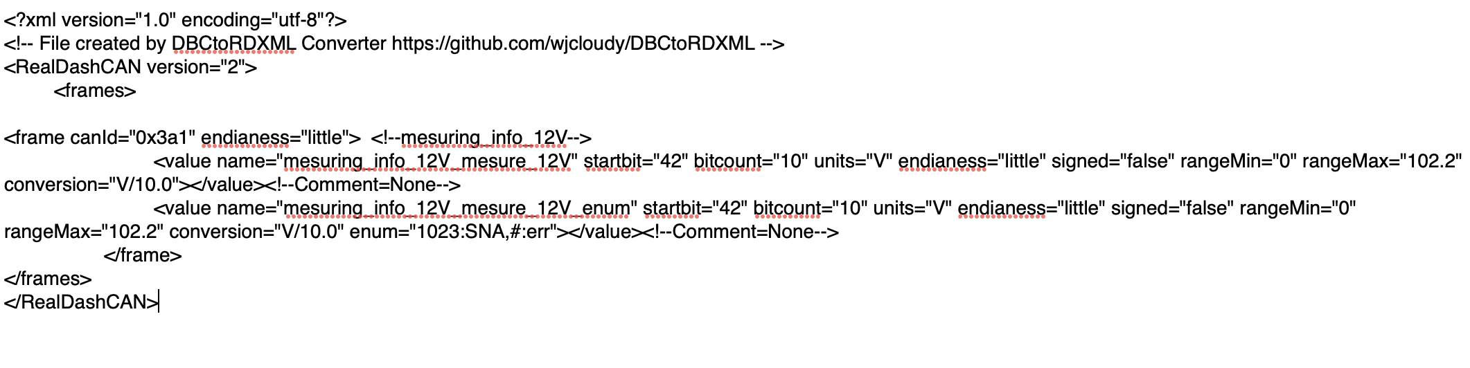

I’ve tried to upload an XML file but it only shows the first couple lines. What am I doing wrong? Just trying to see if anyone can see a problem with my XML.
Don’t see anything obviously wrong with it. The signed=“false” and endianess=“little” are not necessary as those are the default values.
