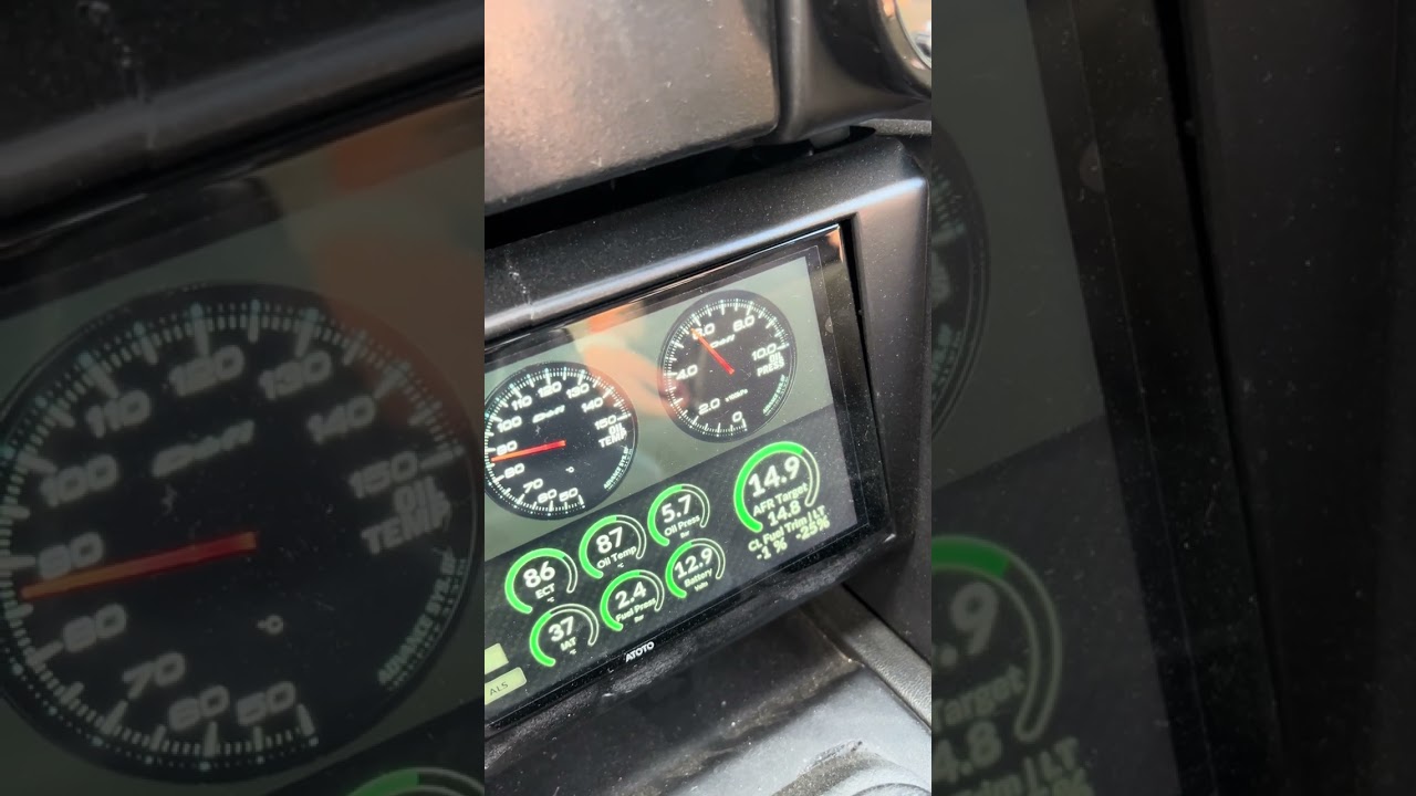

I tell you: I have an ae86 with a ecu link storm g4x connected by can adapter to an atoto x10, in which real dash is installed but I have two problems:
first:
by default, when I turn on the ignition or start the car, the radio turns on with realdash directly, and everything works fine until after about 3 minutes, in which everything hangs and I have to return to the garage, connections, and reload the can description file. then everything works perfect and without “time limit”.
Second:
everything works fine, except the oil pressure, which has short peaks that are not related to what the sensor sees or can be seen from pclink. any idea what could be the cause of this?

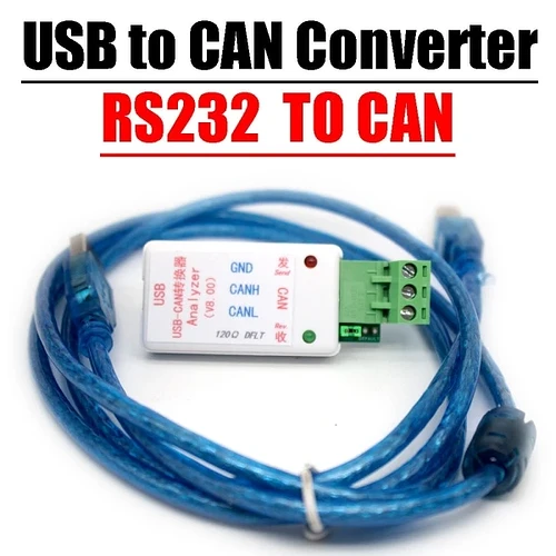

For first case, I do not know what could cause this hang on the data. But your second case suggests that there are CAN data stream errors for some reason. What CAN adapter you are using? Do you have an option to try a different CAN adapter?
Hello guys! I’m using this one
