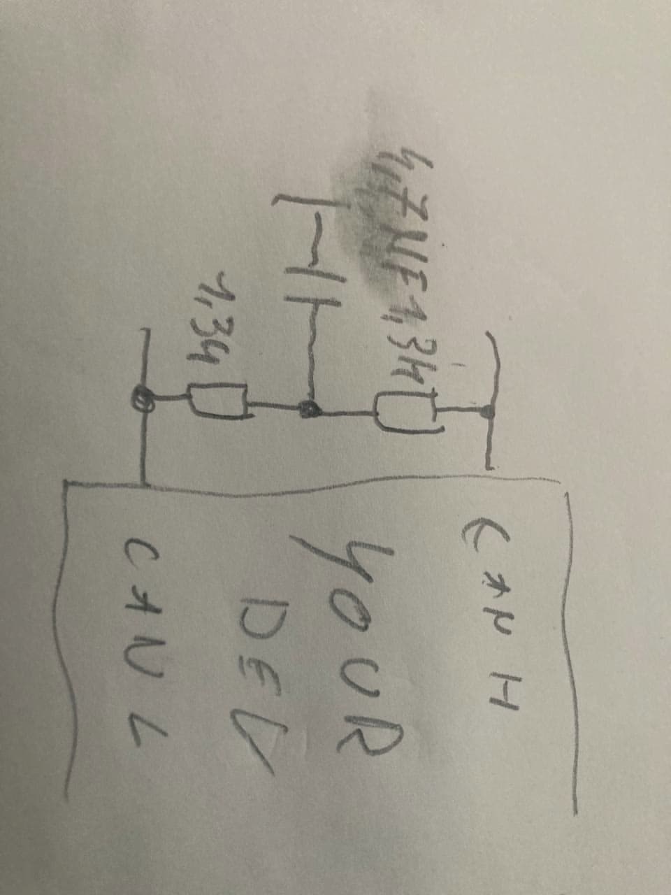

CAN termination is a key point, and the CAR’s CAN system is already terminated as they designed, if you adds an external device your device also requred an small termination due the wire chunk. Your CAN device can be tarminated as showed on the image, this will be tolareted by the CAR network. The values optimal at 500Kbit, in your case the 4.7nF cap may need to be lowered..
