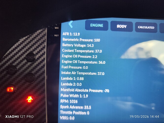

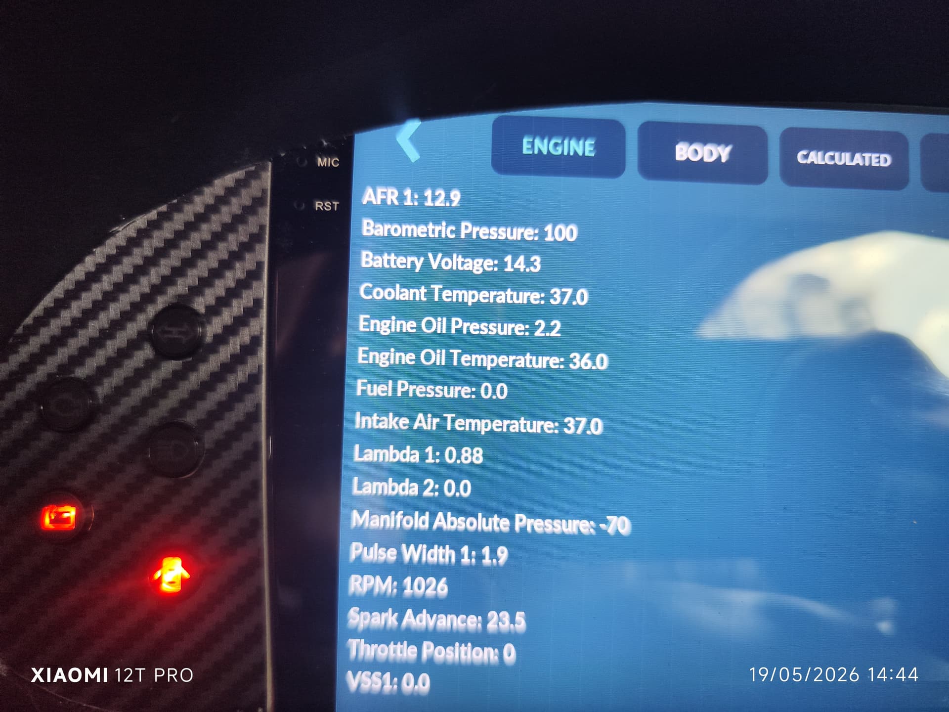

Hi Dev,
I checked with the Debug data view - Fuel Pressure got 0 Reading (but on link g4x PClink side fuel pressure is running normal)

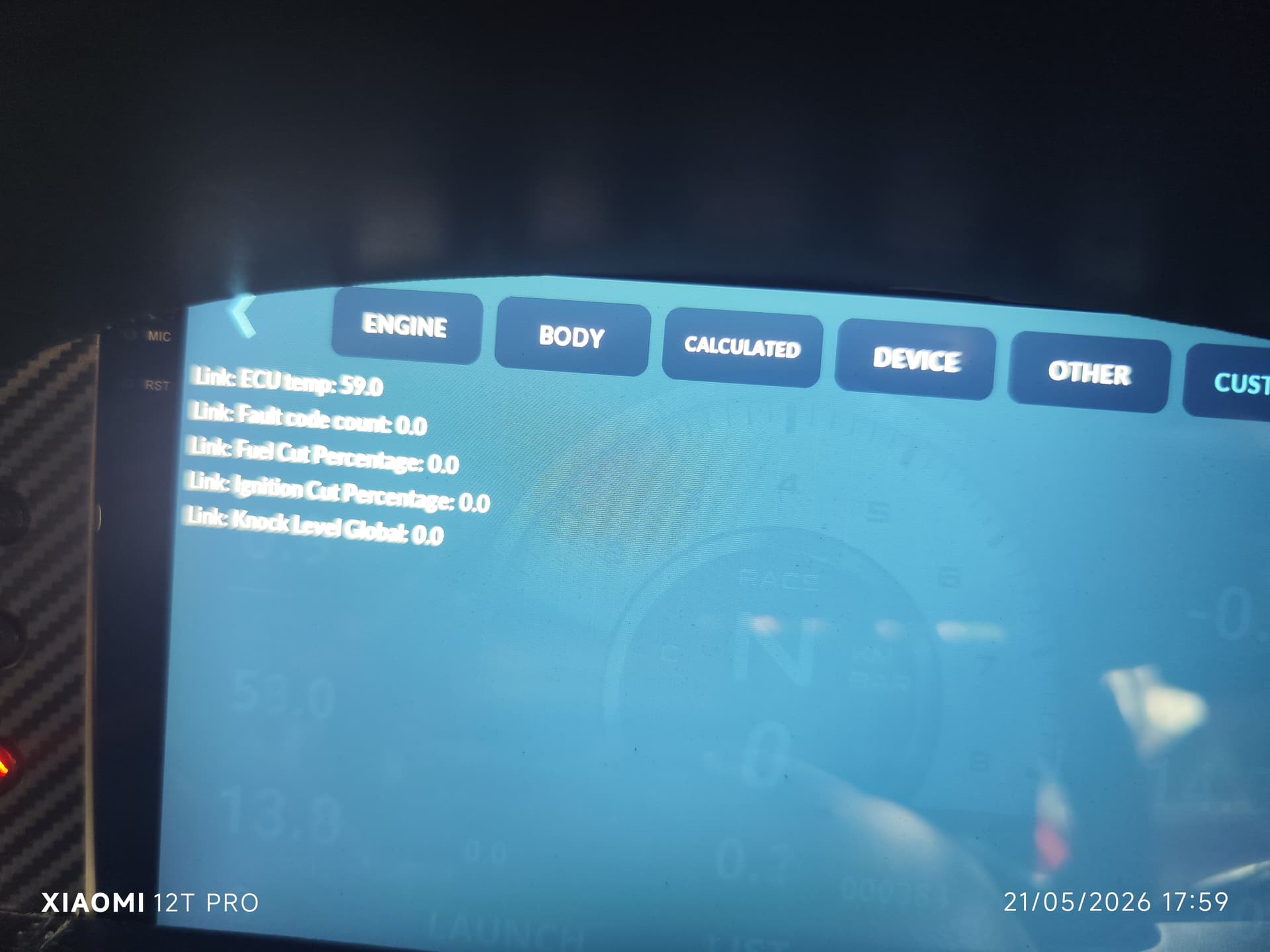

In same view, select ‘Custom’ category to see ECU specific values. Is there any analog input value that corresponds to your fuel pressure?
there is no fuel pressure input on custom
It seems like your setup does not send fuel pressure or Analog inputs to RealDash. I’m not an expert on Link ECU configuration so cannot help much on how to configure it.
