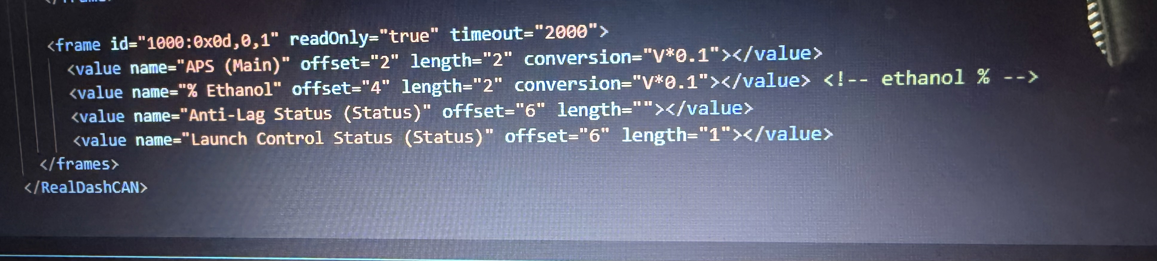

There it is its the ethanole % line is needed to be transmit to the dash !

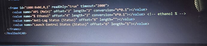

i think i figure it out what happen in the linkdisplay xml. one message is missing (the id 1013) i will try by the end of the week to see if it work well. but all this is missing in the xml file:
Your XML example is broken. Do you have original source where this information is from? I can then update the XML to next release.

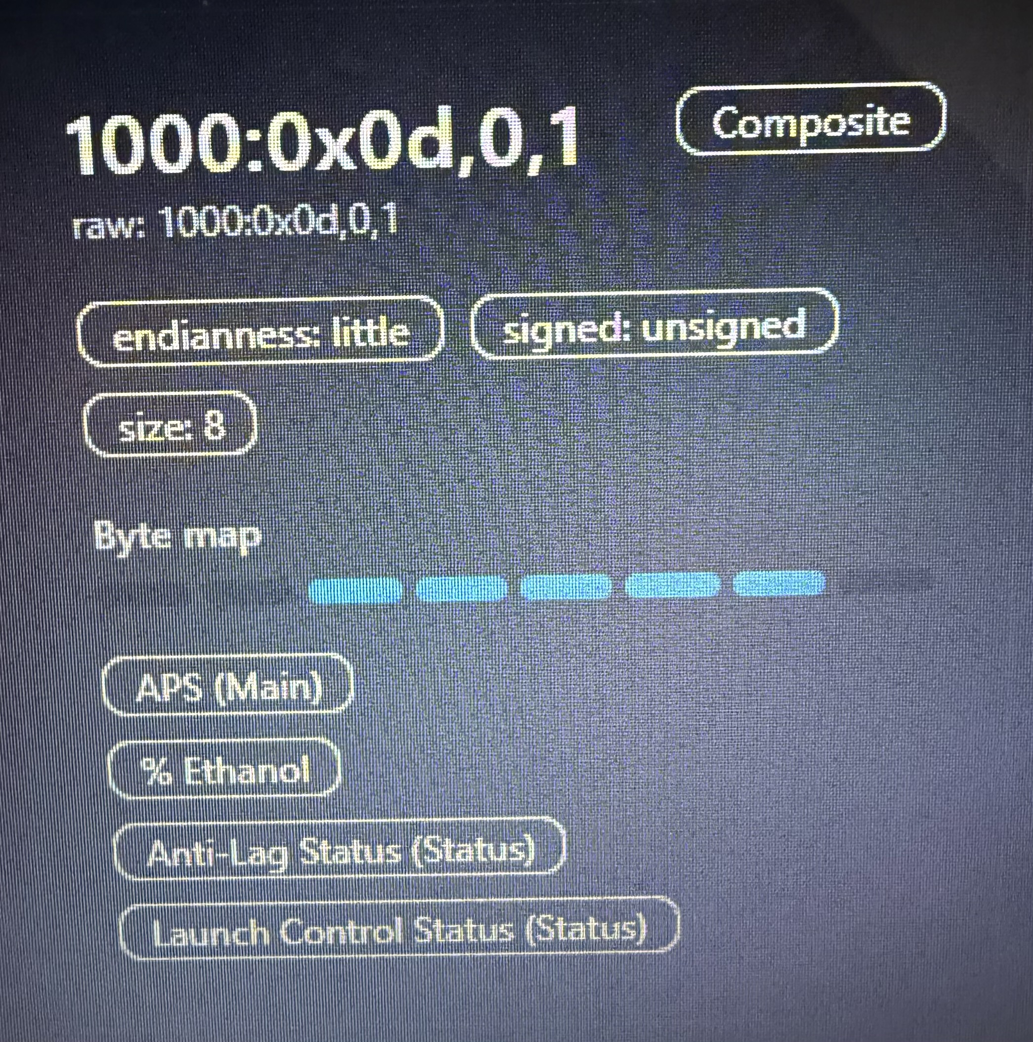

What do you mean by broken ? I done it myself by logic if you look the stream line in the link generic dash you have 13 stream including the 0 so 14
And in the xml you have 13 of them including the 0 so 12 i juste make my own other stream by logic i will test it by the end of the week end but for sure you missing one in the xml✌🏼

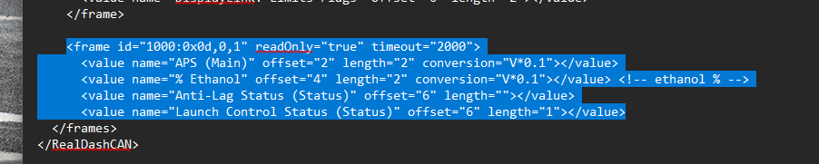

With quick look:
  • <frame as no end tag
  • length=“” is invalid
Yeah you right i update it after the picture because i try to figure it out why the two last one have a lenght of a fractionate bit one use 3 of 8 bit and the other one 2 of 8 bit so i was confuse for the lenght and how to right it. like i said i have not already try it… but for sur is missing all this to fit with the link message .. im not a pro like you i juste try to get it fix
