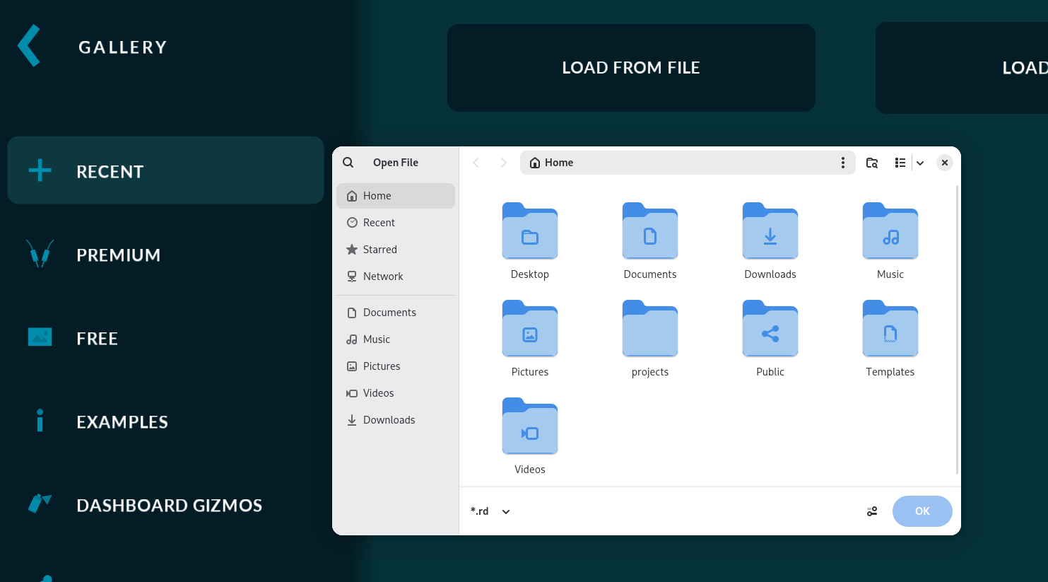

Try ‘realdash-mrd_2.5.9-1-prerel1_amd64.deb’ from downloads. For me, it opens the file dialog just fine on Debian 13.
Hello! Installed the new version. Yes it finally opens a dialog just as you see. However I cannot interact with the dialog or Realdash after that, it freezes still. Progress though!
