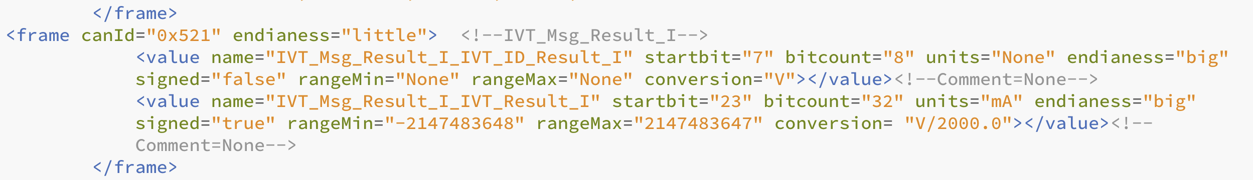

Hi, I’m actually using a Windows 10 mini computer in my car. I also tried using a different windows 10 laptop in the car with my cars connections and the same issue. I’m attaching another 500kbs xml to see if you can see any issue with it.
I’m sure if standard frame or extended frame has anything to do with it but I’ve tried both.

Latest update has a fix for XML values that use only startbit and bitcount. Maybe it will fix your issue:
RealDash version 2.6.2 - General / Announcements and updates - RealDash Forum
Thank you, I can start growing my hair back now. Everything started working again after update. That really drove me crazy. Thank you guys again.
