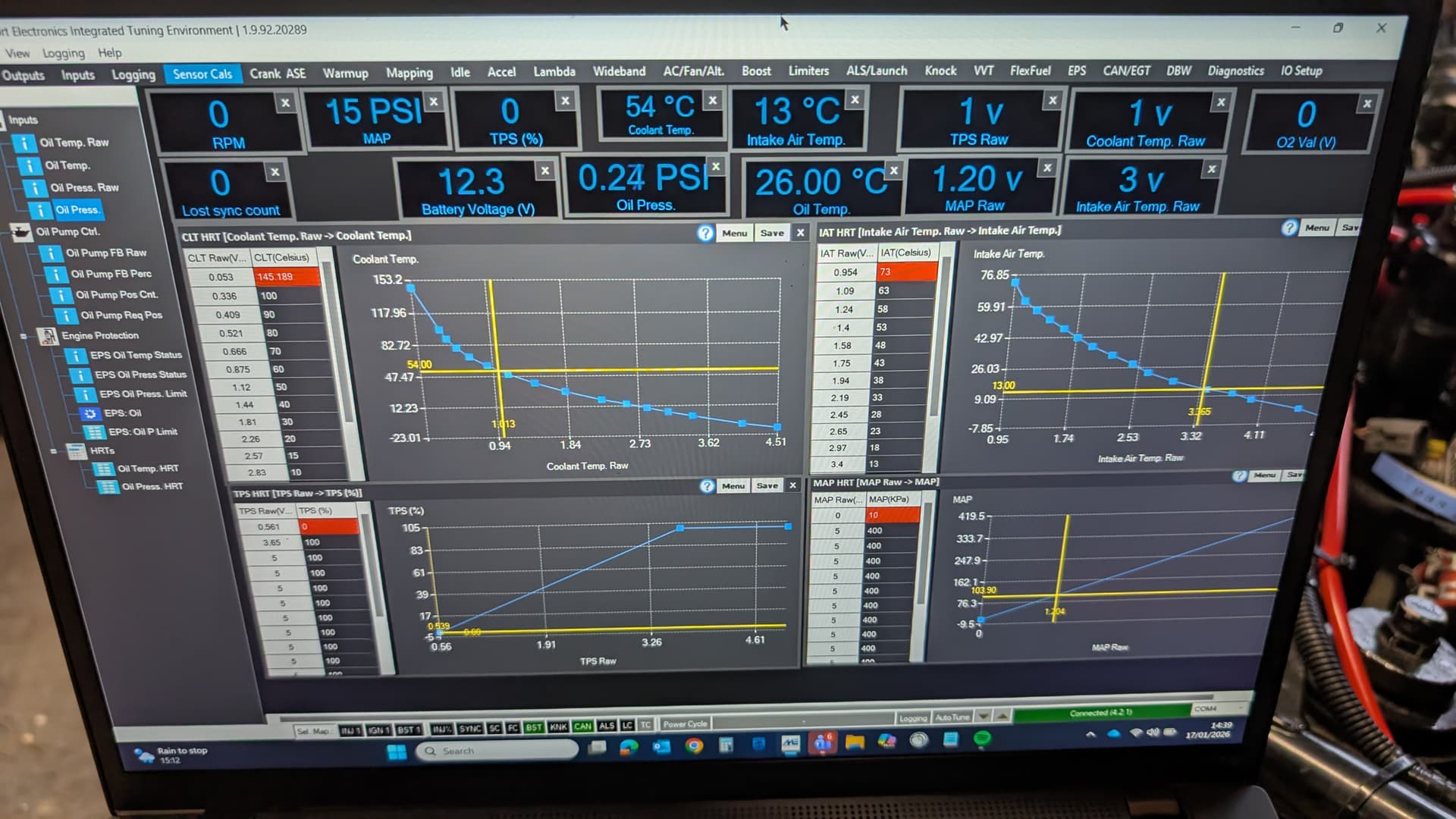

I’m struggling reading the oil temperature data on my real dash app, I’ve selected “oil temperature” and tried others with no success.
I have multiple other values working fine ie rpm,tps,boost,coolant temp ect and the oil pressure which is an additional input on the ecu is working fine but oil temperature I can’t seem to pin point the whereabouts of the data on the app (Working fine on ecu/MEITE).
Can anyone shed any light please? 01-05 VVT ME442 GEN2 wired into one of the ANA terminals IIRC (will check).

Ok so with the new software It now shows a value but not what I’m expecting. Meite shows 26 c and Realdash shows 140c

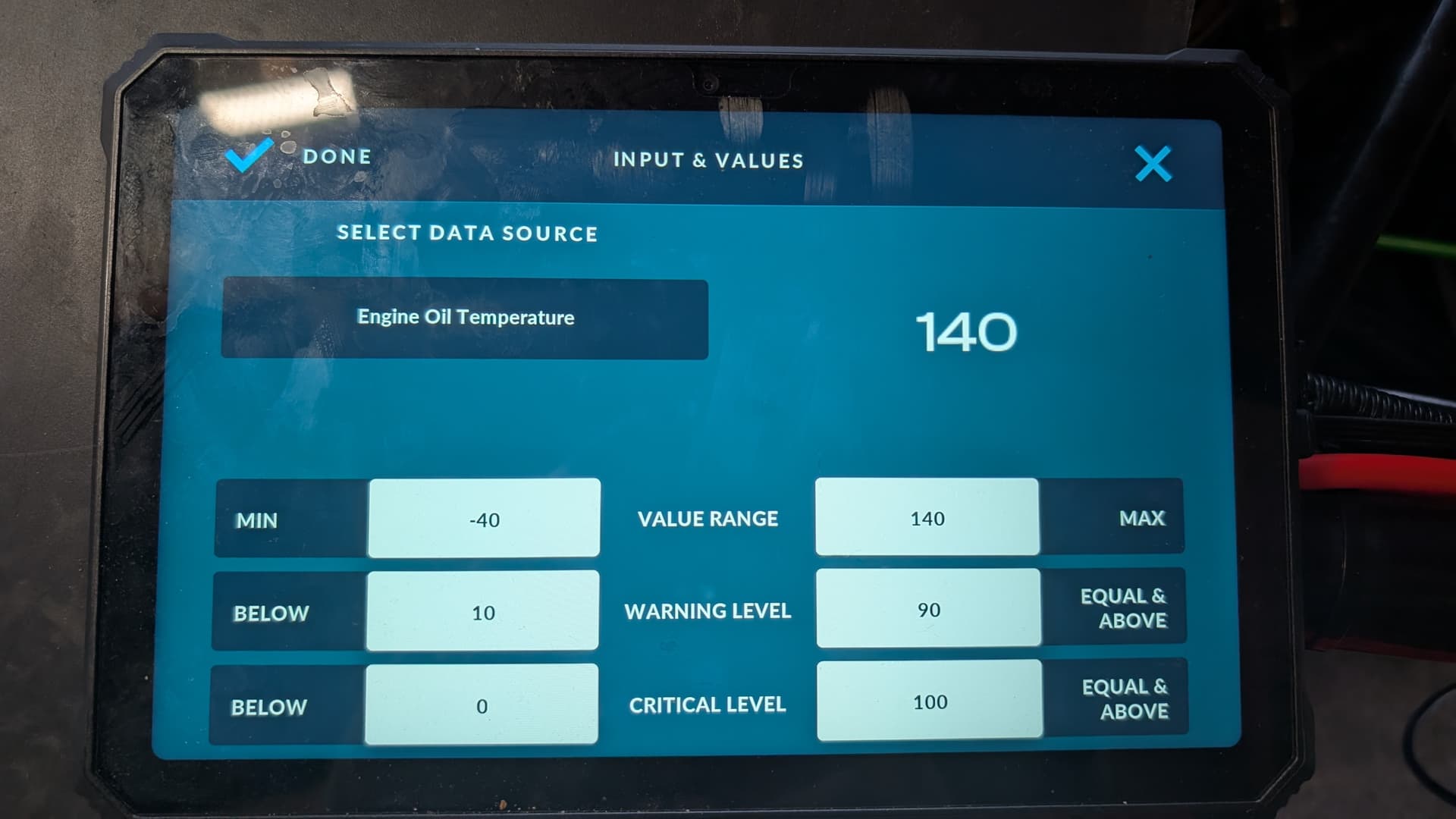

I’ve tried the update this afternoon and had the same result, previously reading 0 now reading 140. Not inline with the Oil Temperature readings within MEITE

Please check if value is actually 140. Now your range has capped it to 140, so text gauge will not show any larger values.
I think we are going to need more help from ME to solve this. Maybe the value is sensor voltage instead of actual temperature?

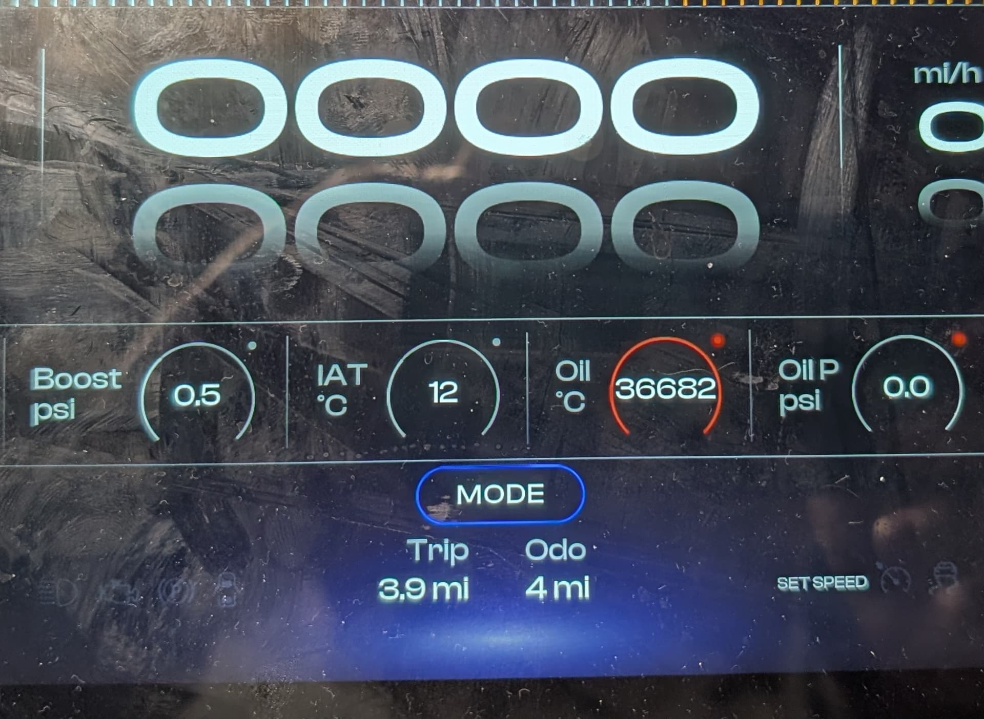

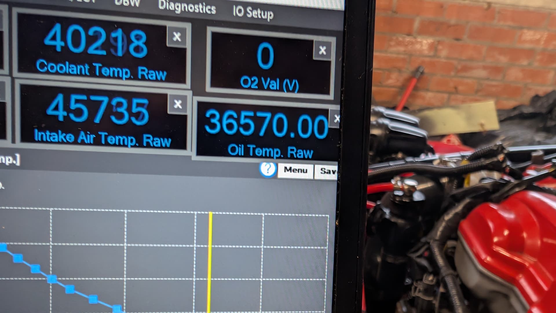

I increased the cap and the actual value is hovering around 37000 . Any idea what that would be ? I’ve also asked ME
Looks like the value real dash is showing corresponds to oil temp raw in meite
Update from ME. They said it’s actually 29 ( not 28) . 28 is raw. 29 is actual temperature
