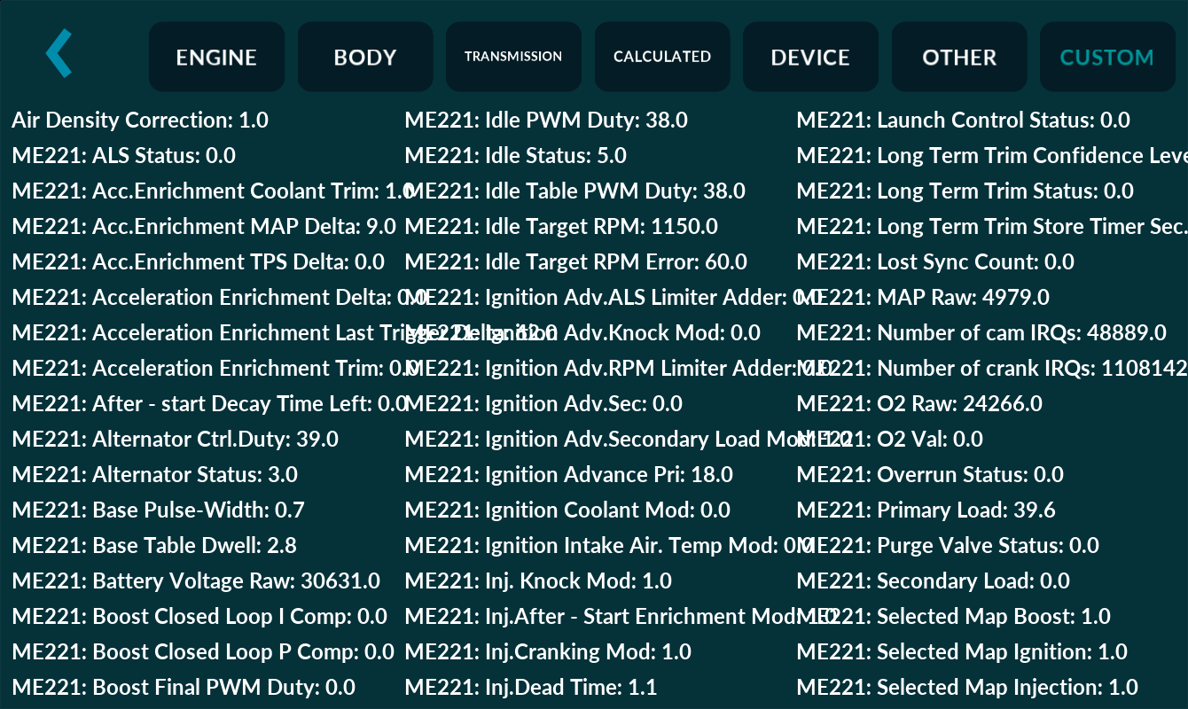

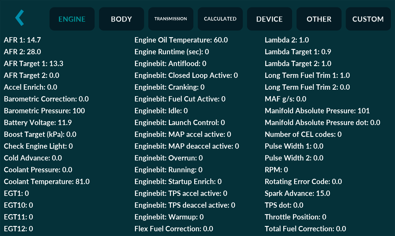

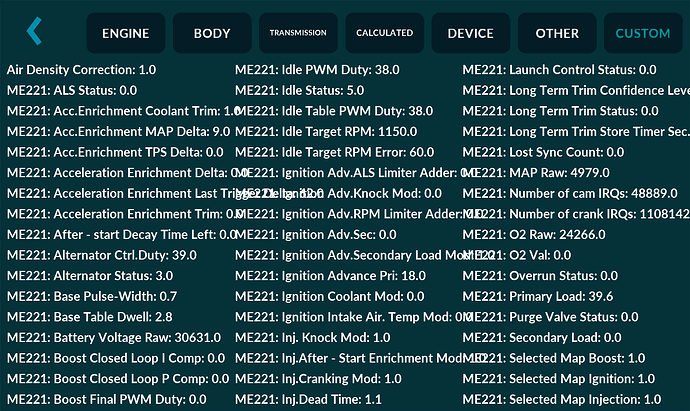

Yeah, I checked the data view, but I can only see the oil temperature data, not pressure - see attached screenshots.

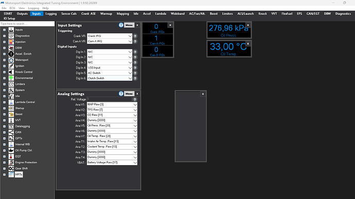

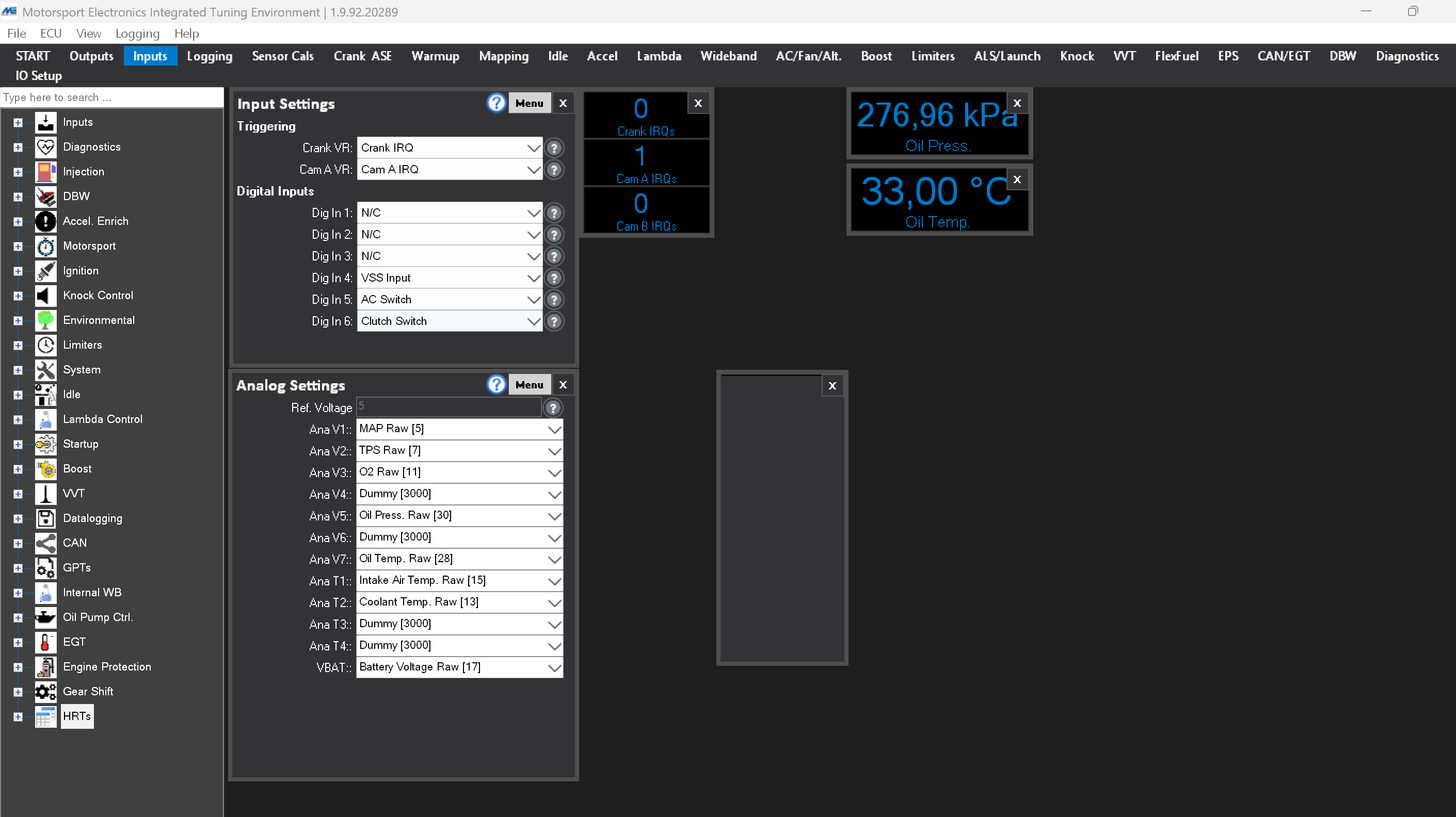

Attached also a screenshot from the MEITE, with the live data chanels used. I hope it helps…
