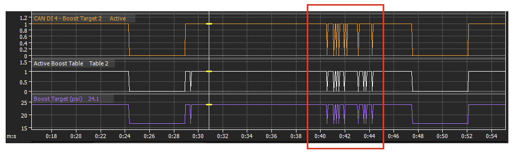

I do also have an issue with “Button press” CAN send actions from Realdash to an ECU on the other end of the CANBus - the initial “button press” action in RealDash activates a Digital Input on the ECU end, however RealDash seems to intermittently reset that state sporadically every 150ms from 0 > 1.

Based on the marked graph, are you sure the wifi really disconnects or it’s somthing data corruption ?, by the time line, I’m unsure if the wifi will reconnects within that short periods…
Hi @HondaRulez ,
No the WiFi doesn’t disconnect during a “Button Press” action from RealDash → ECU, as the received CAN Data from the ECU still displays and updates in real time in RealDash itself. Its just the CAN Send action that is problematic.
150ms is too short a period for Wifi to disconnect and reconnect - this Android device takes roughly 10 seconds to reconnect to Wifi if the connection is dropped.
My suspicion is that RealDash isn’t sending the CAN state frequently enough and the ECU is determining that the state is being triggered on/off, rather than remaining constant 0 or 1.

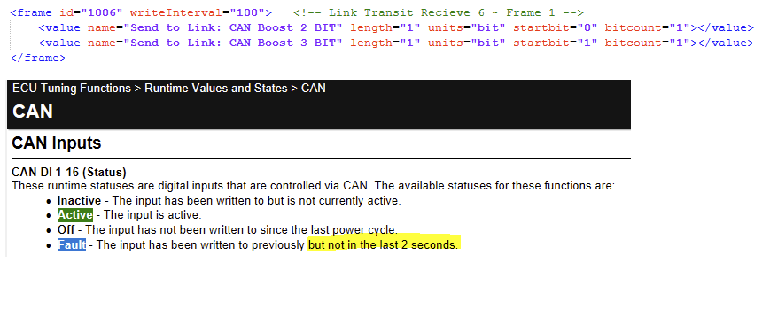

I did have to decrease the XML “writeinterval” to 100 to prevent the ECU from toggling a ‘Fault’ state on the CAN input, as it expects the value being sent from RealDash to be written at least every 2 seconds - while this has fixed the ECU CAN input going into “Fault” when activated from RealDash, it hasn’t resolved the sporadic on/off behavior as shown in the image above.
Reducing the writeinterval to 50ms didn’t help the problem either.
