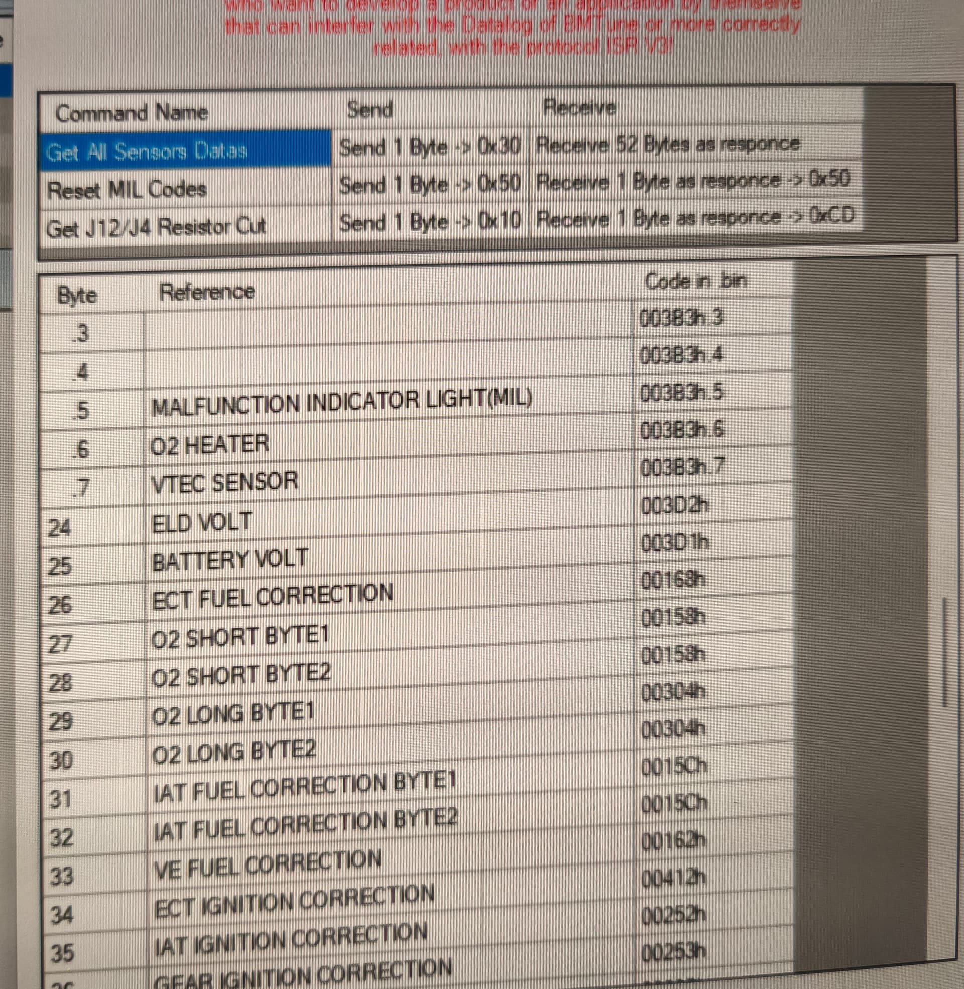

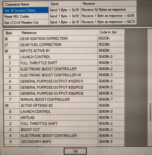

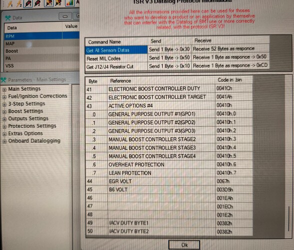

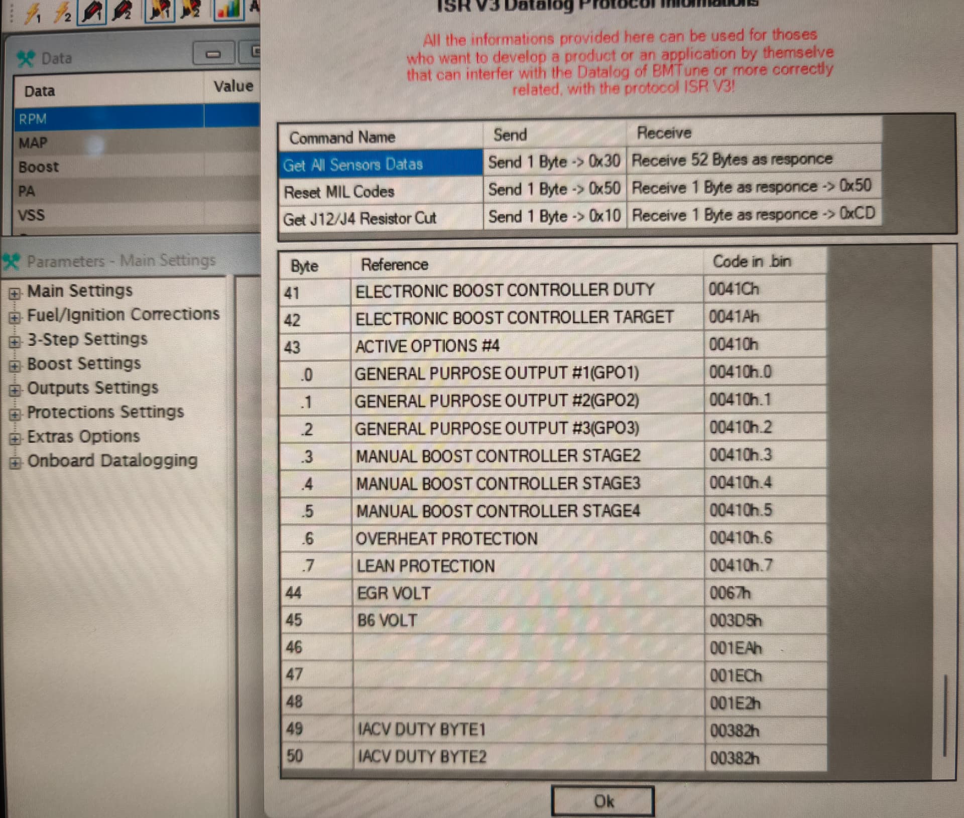

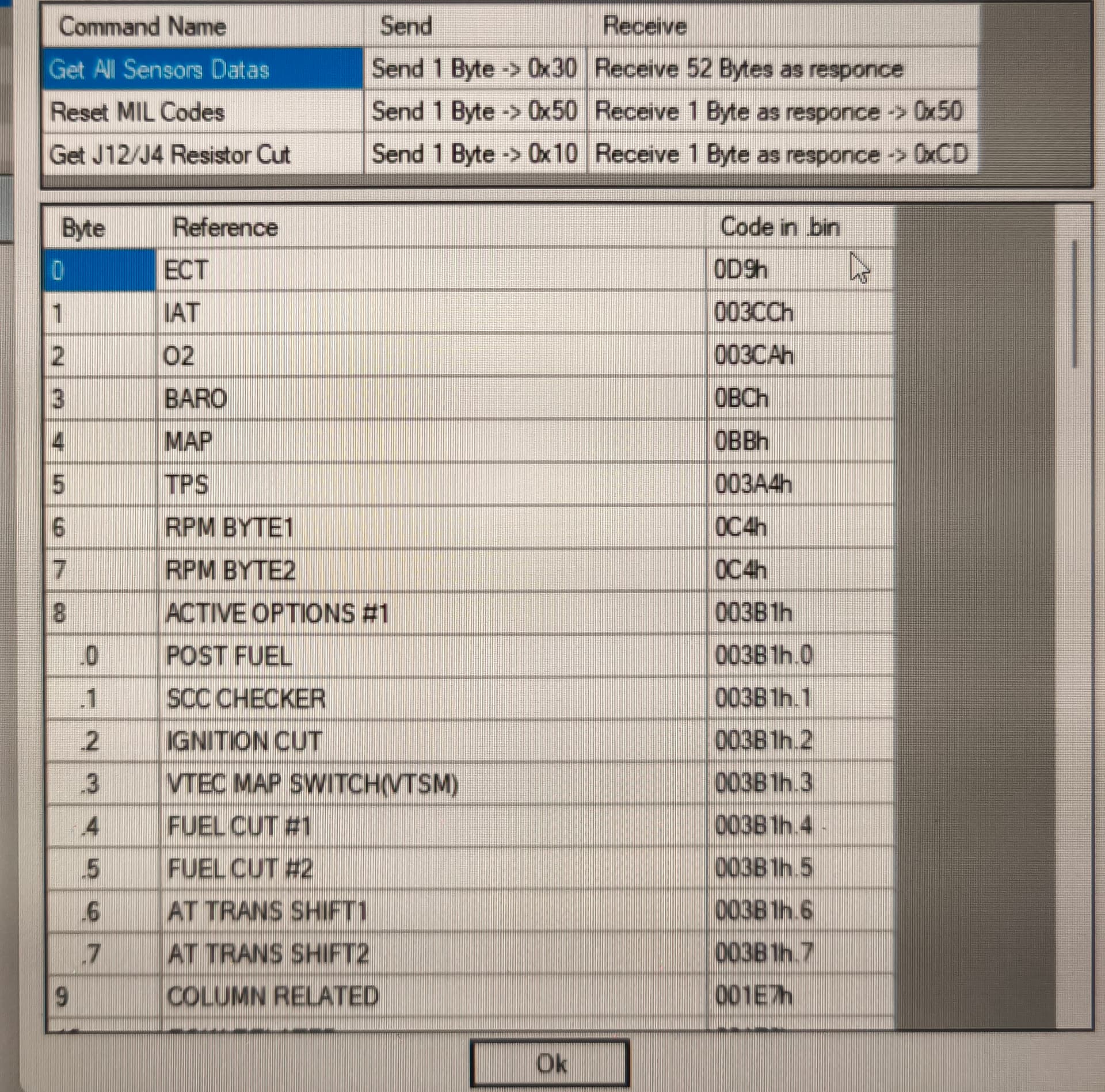

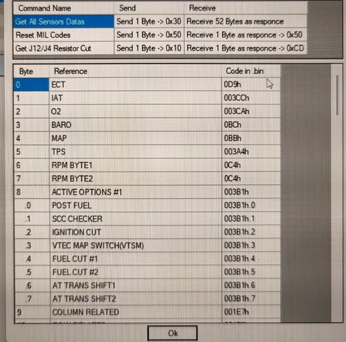

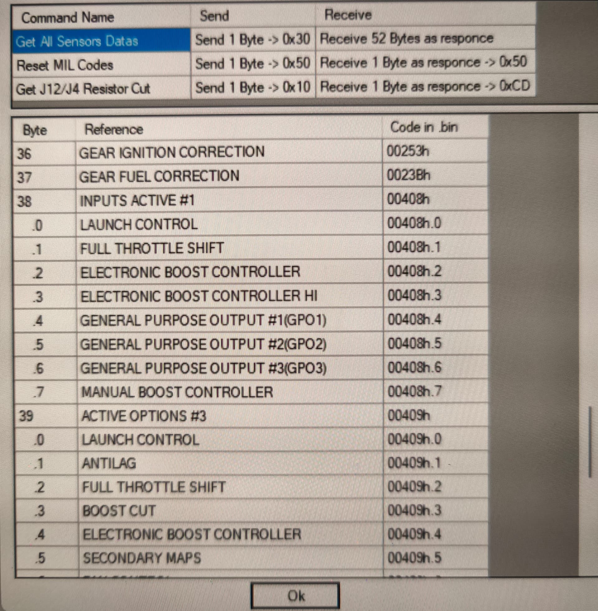

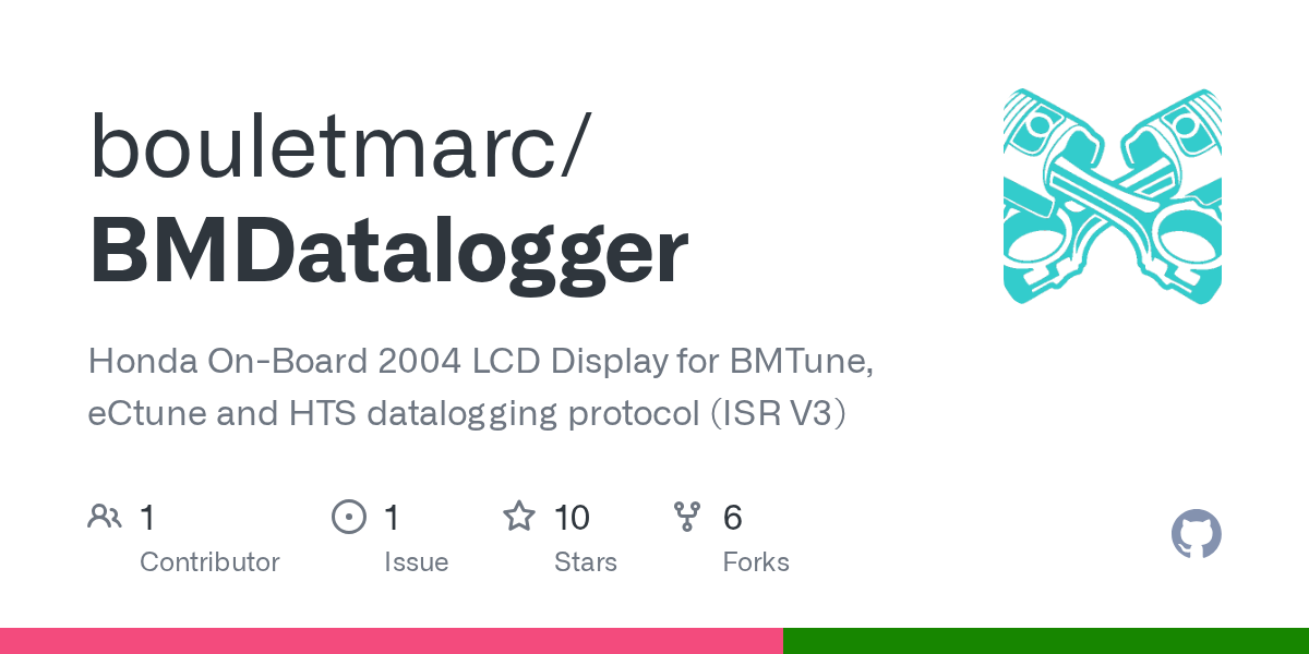

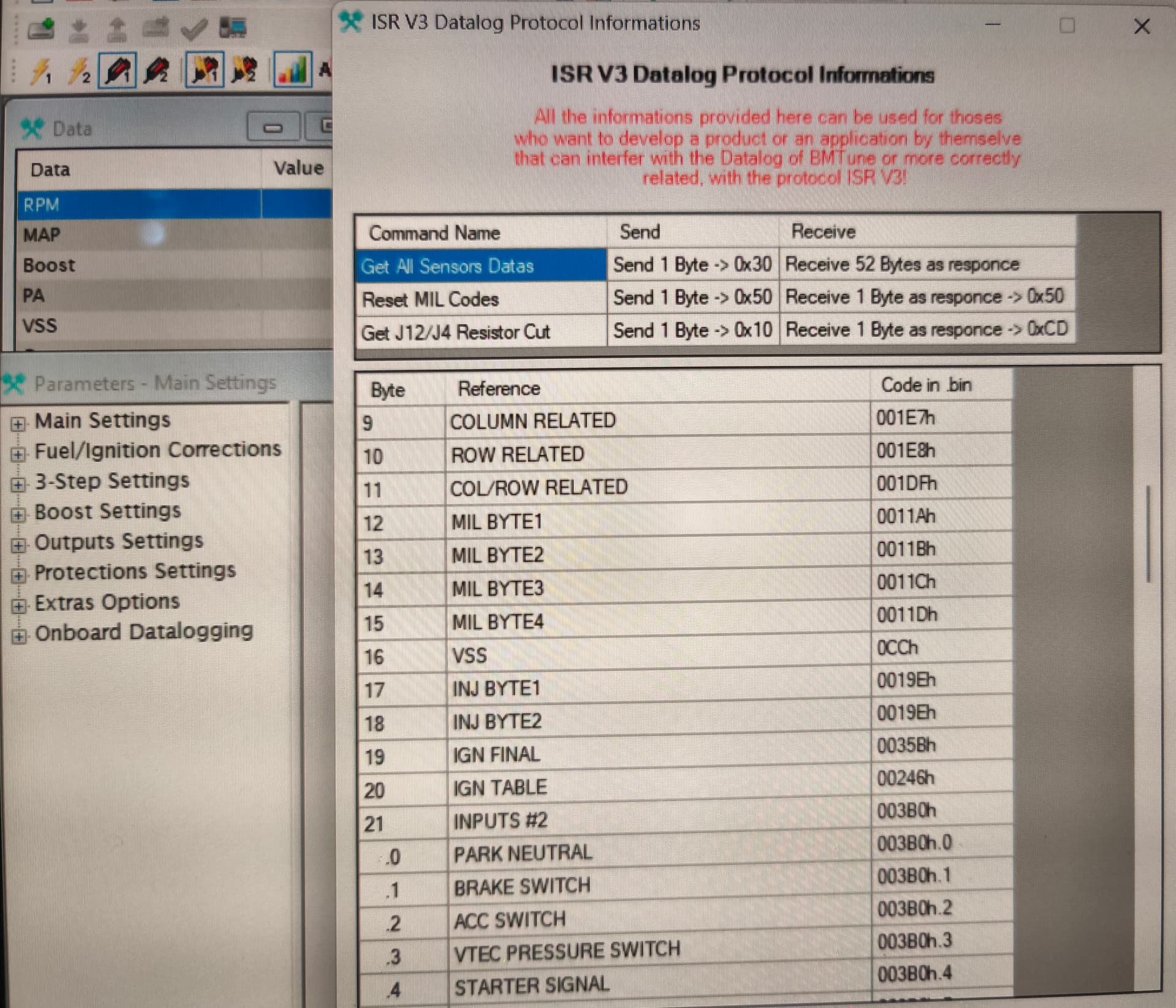

Thanks. ive been looking up more and it seems the best option would be to use ISR V3 protocol, which is used on ectune and honda tuning suite chipped ecus. So i guess disregard the demonv2 stuff.

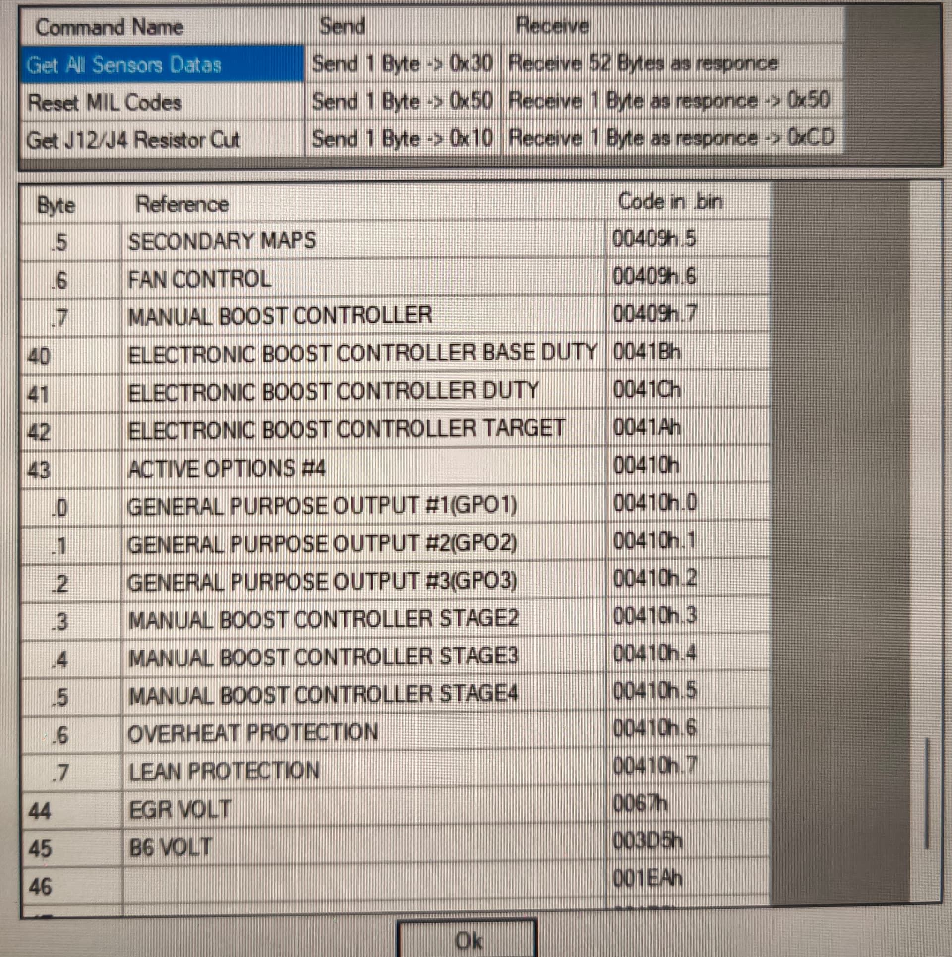

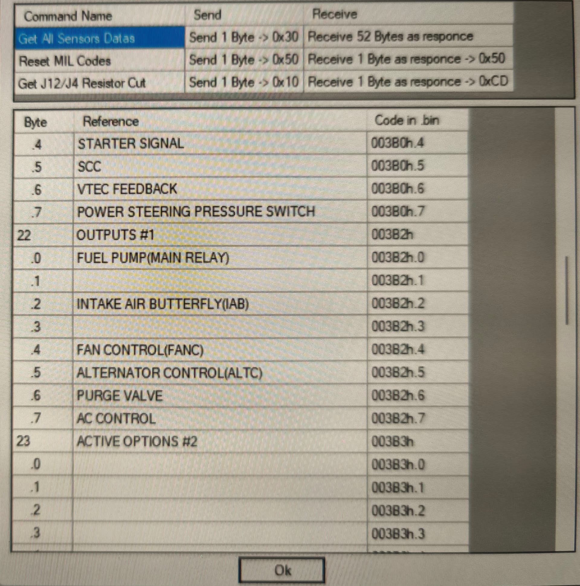

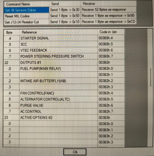

Here is all the isr v3 information
https://i.imgur.com/7ImbS1B.png
https://i.imgur.com/l7slLYS.png
https://i.imgur.com/gC0x3jb.png
https://i.imgur.com/zLDFSZQ.png
https://i.imgur.com/xKi2QsL.png
https://i.imgur.com/RdyQO09.png
Hondash has recently added this protocol to there app, but is more just for the stats rather then a full on digital dash. No worries on checking it out mate. Thank you

The images do not show how values are converted from bytes to actual values. For example byte 2 = O2, so what conversion is used to show decimals on O2 value?

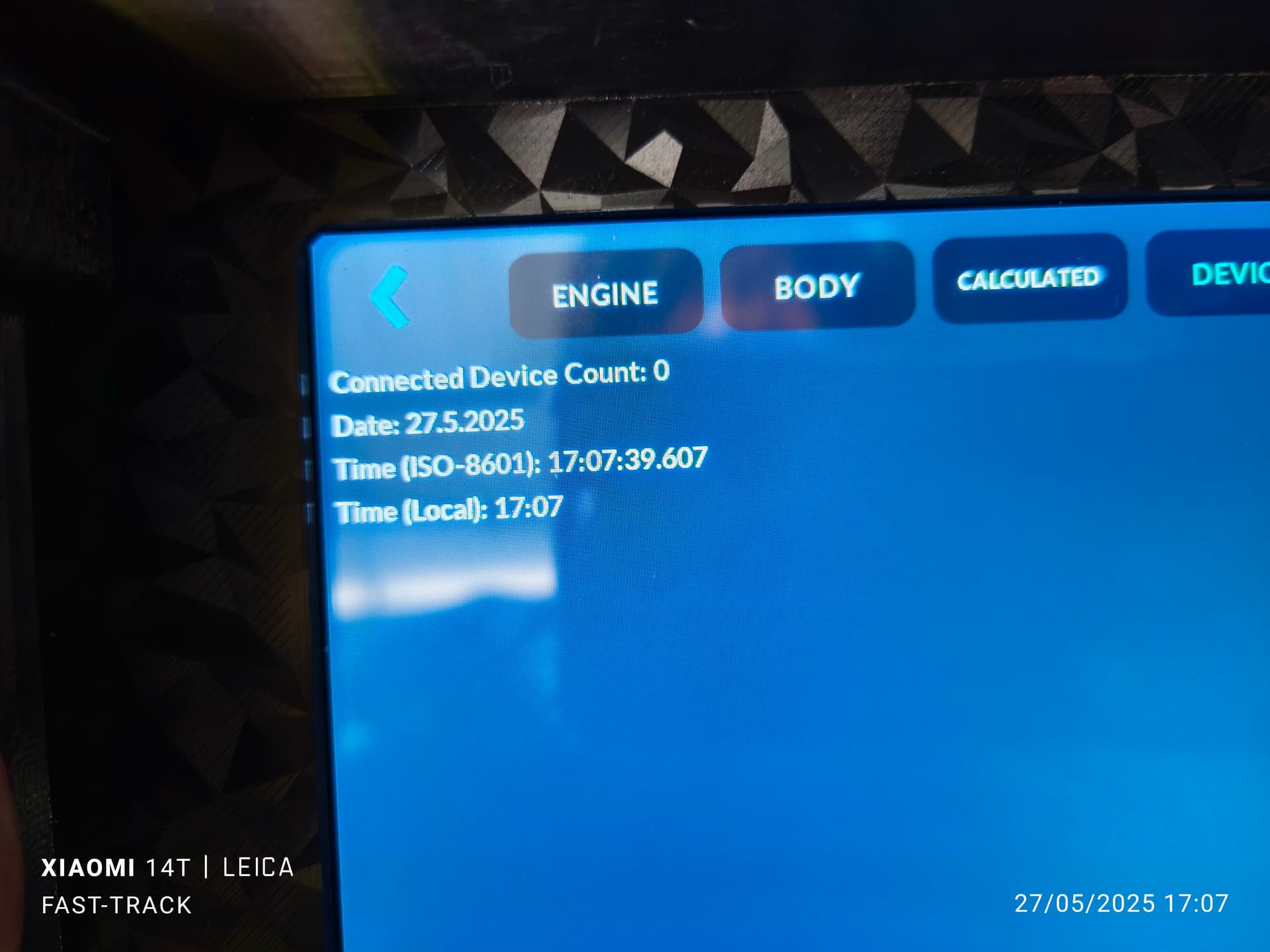

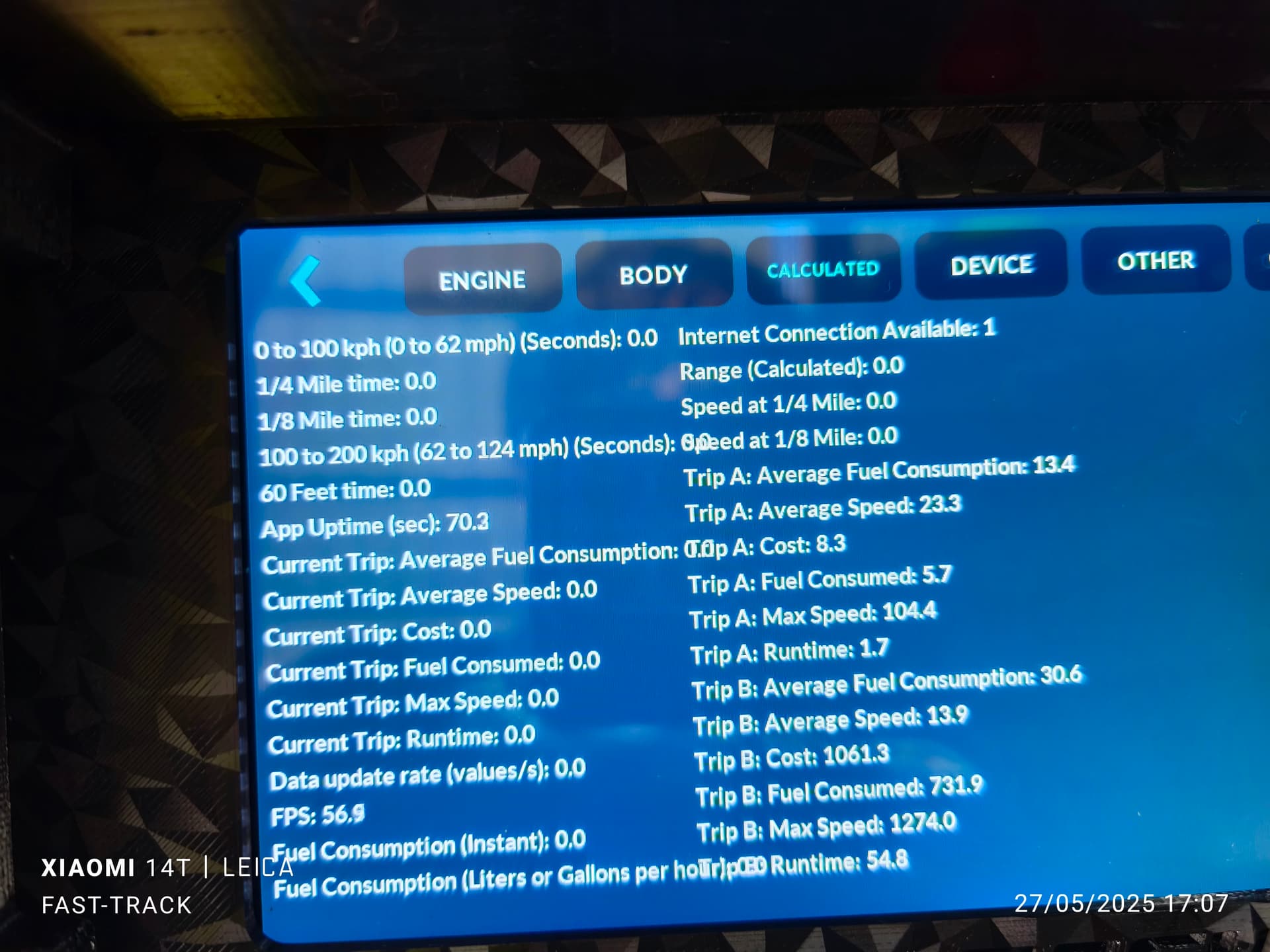

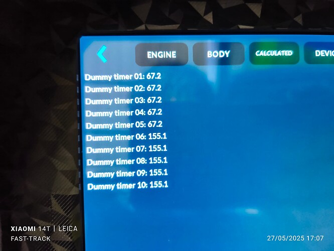

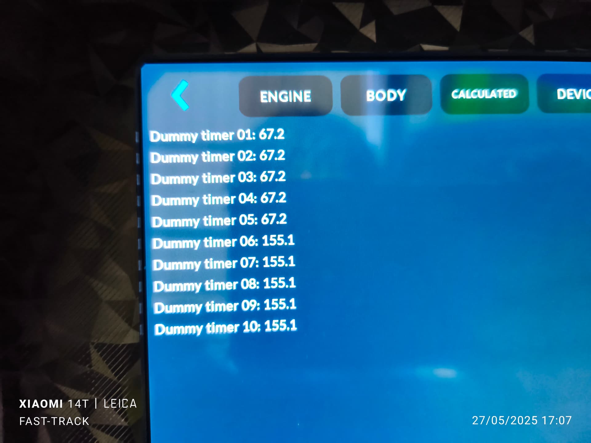

Today i test ISR V3 and connect with hc05 can parring Bluetooth only data not show. I wiil open debug logging and take photo holp this help.
Send me an email to contact@realdash.net and I will provide you a version that has better logging on ISR V3 connection type.
Hello master I click send debug to developers in realdash.
Hc05 connect ecu honda Baud/Uart 38400
I just sent you a link to test version. Please install that version and send a Debug log again.
hope this help
