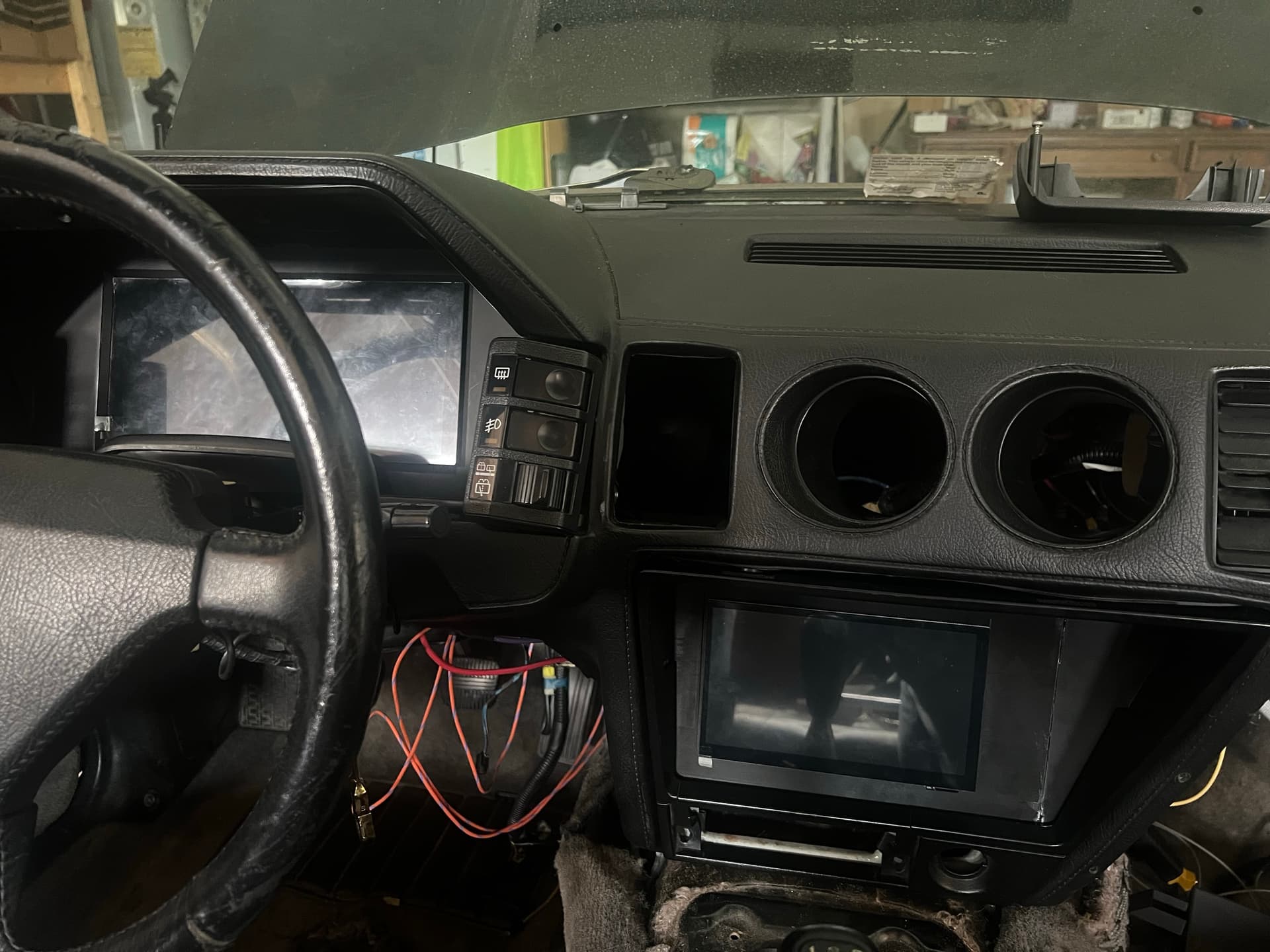

I’ve been struggling with windows merging the monitors reliably It will either work or the main screen wont turn on. I have a Pi4 and a lattepanda that I could use to do the Multicast and I’m thinking that might be easier. If I do the multicast, do I need another CAN reader or can I just use Ethernet cable and tether them together?
Also, is there an .ini file I can edit that I can force it to open fullscreen on both monitors? It works flawlessly on Nvidia GPU, but the Nukbox only has integrated graphics and intel graphics center is crap.

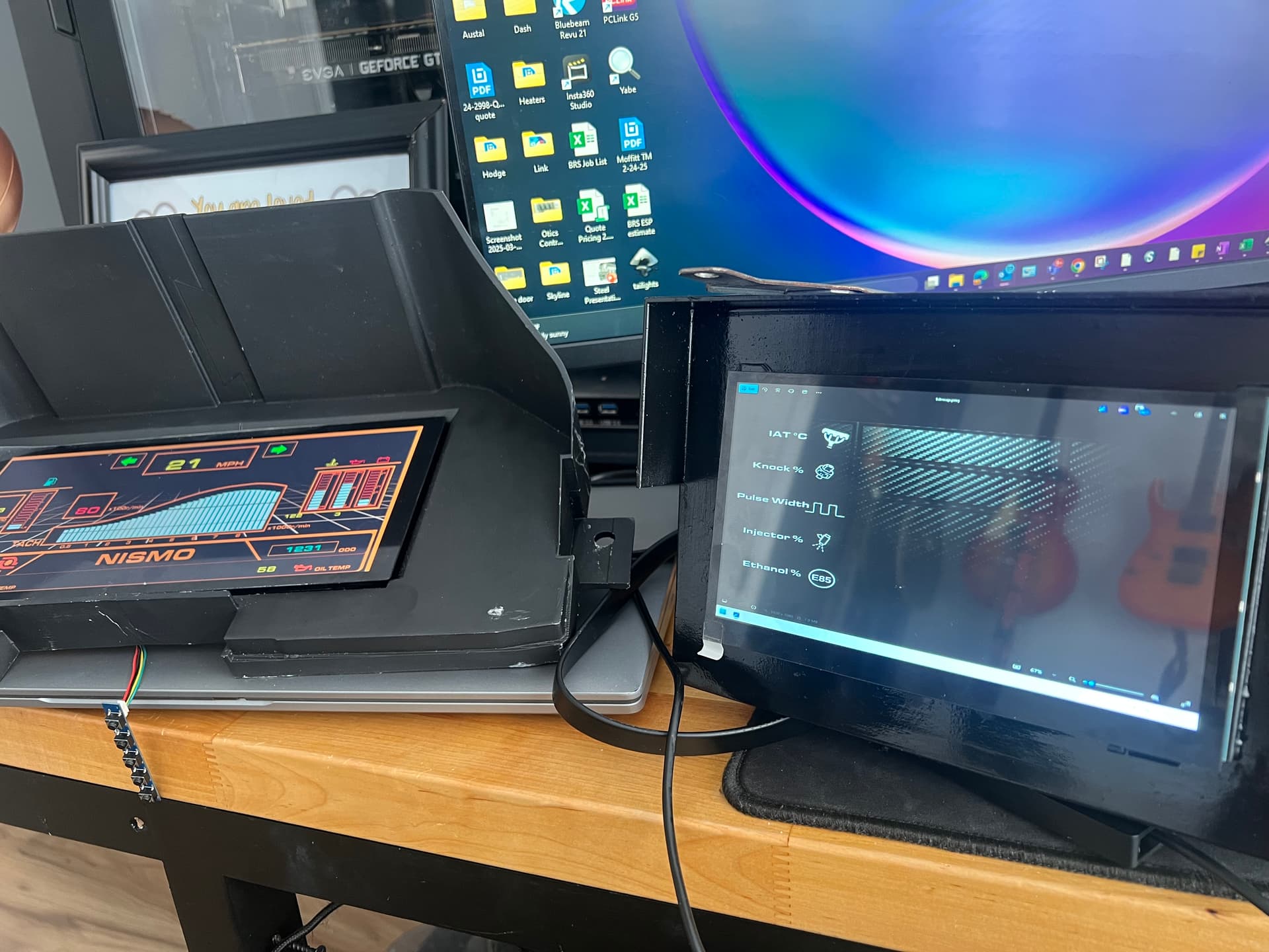

So I did go ahead and install android 15 on the PI and it works really well. Boot is a little slower but the android version of RD is so smooth.
Yes, Windows can be sluggish on those mini-pc:s. Actually, we never though that anyone would use the Windows version as actual screen on their vehicle. We consider the Windows version more of a PC-Editor.
