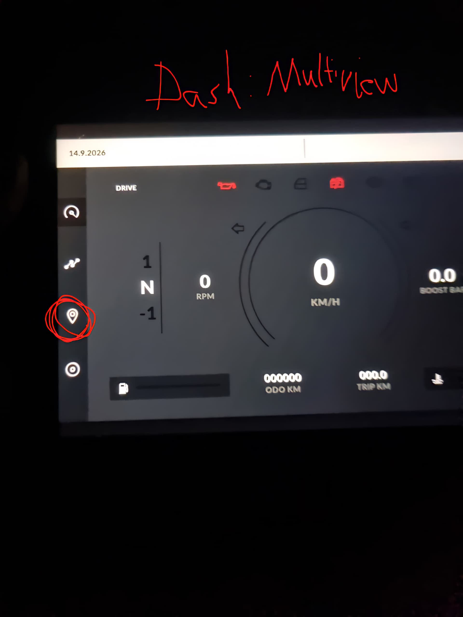

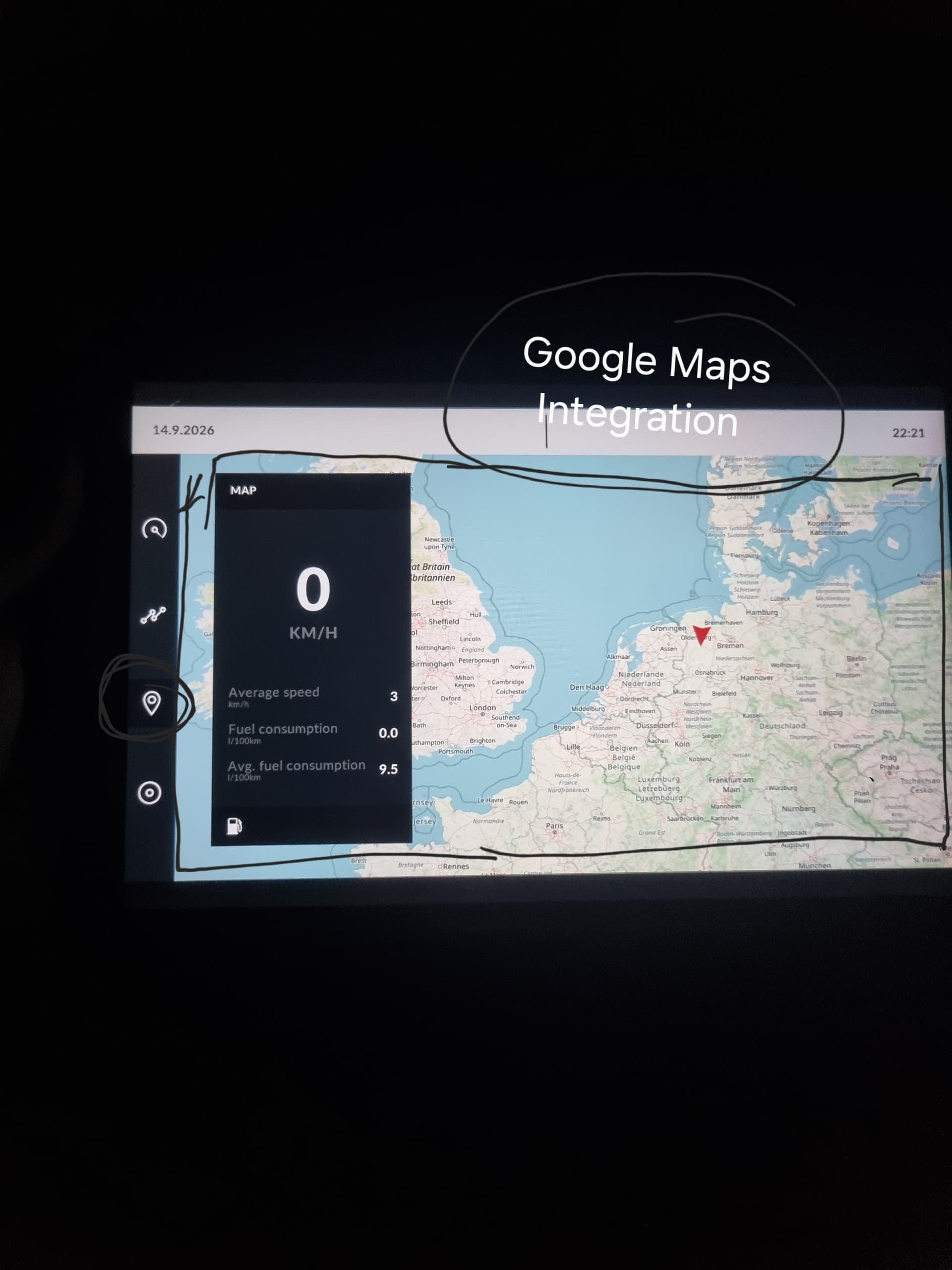

Another option is an complete integration of Google Maps like in Android Auto. I know Android Auto is also from Google and they have a much bigger advantage but I think it’s possible (ideas in pictures).

Integration of Google Maps, Waze, Here maps whatnot comes down to costs. We are offering map view for all our users, even for those who do not pay anything for the app. It is just not viable to integrate, simply put: it costs too much.

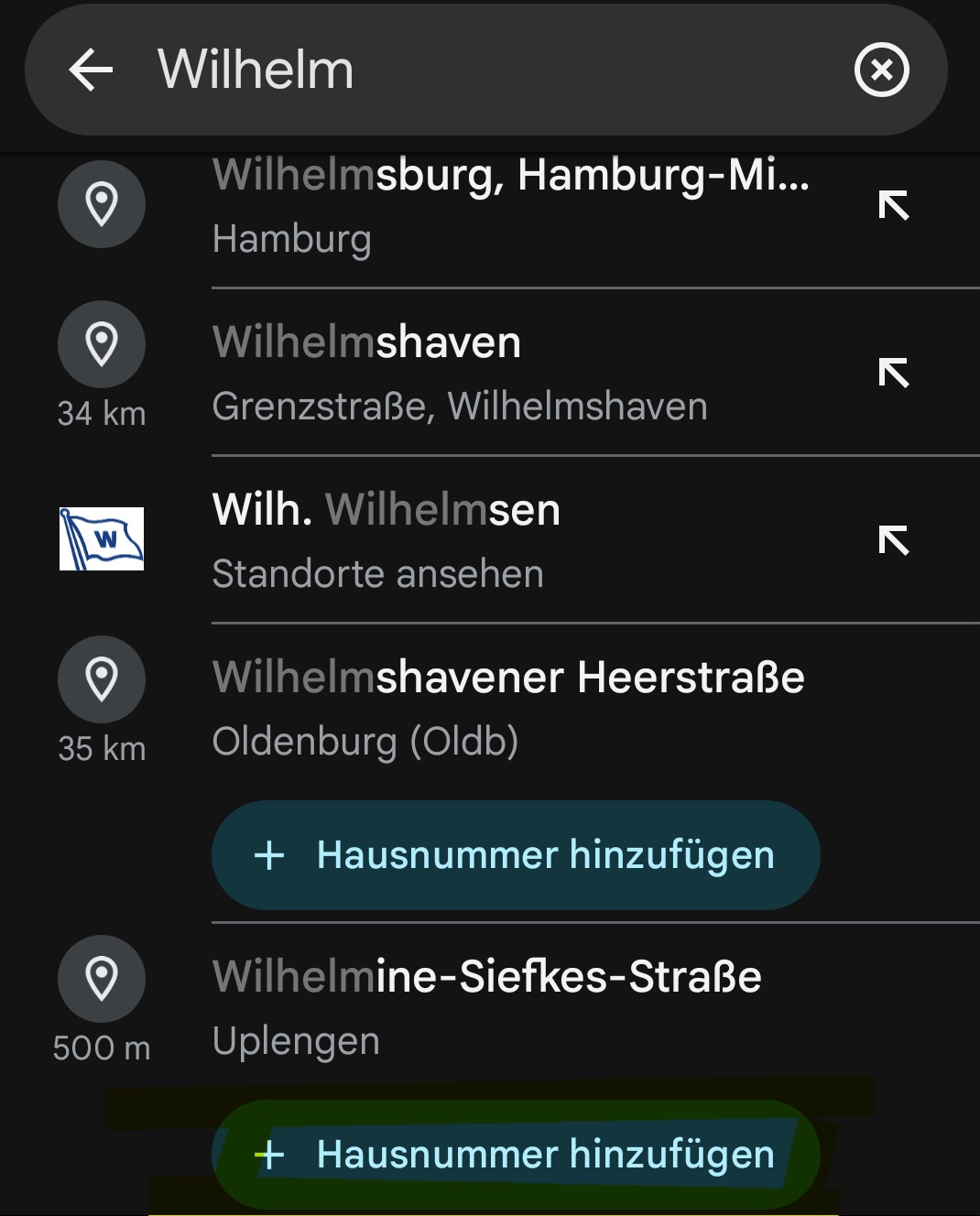

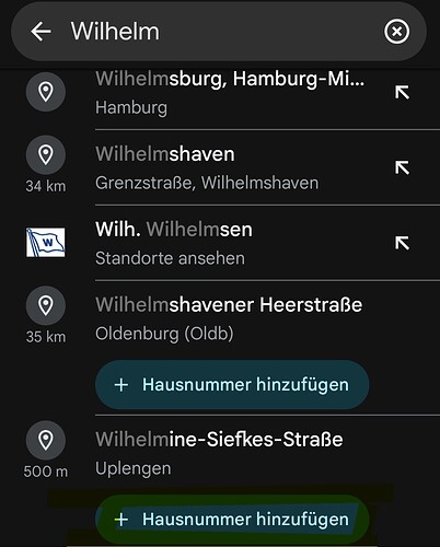

I mean I that it doesn’t let you type in house number like in Google Maps f.e. (I send a pic of it (“Hausnummer Hinzufügen” translates to “add House Number”))
And the interface looks a little bit old. You could do a new overworked version with an option where you decide if you use the new or old option (for old devices).
