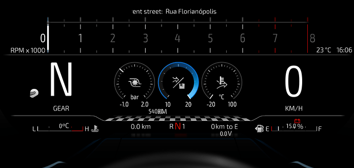

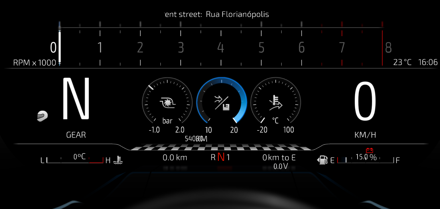

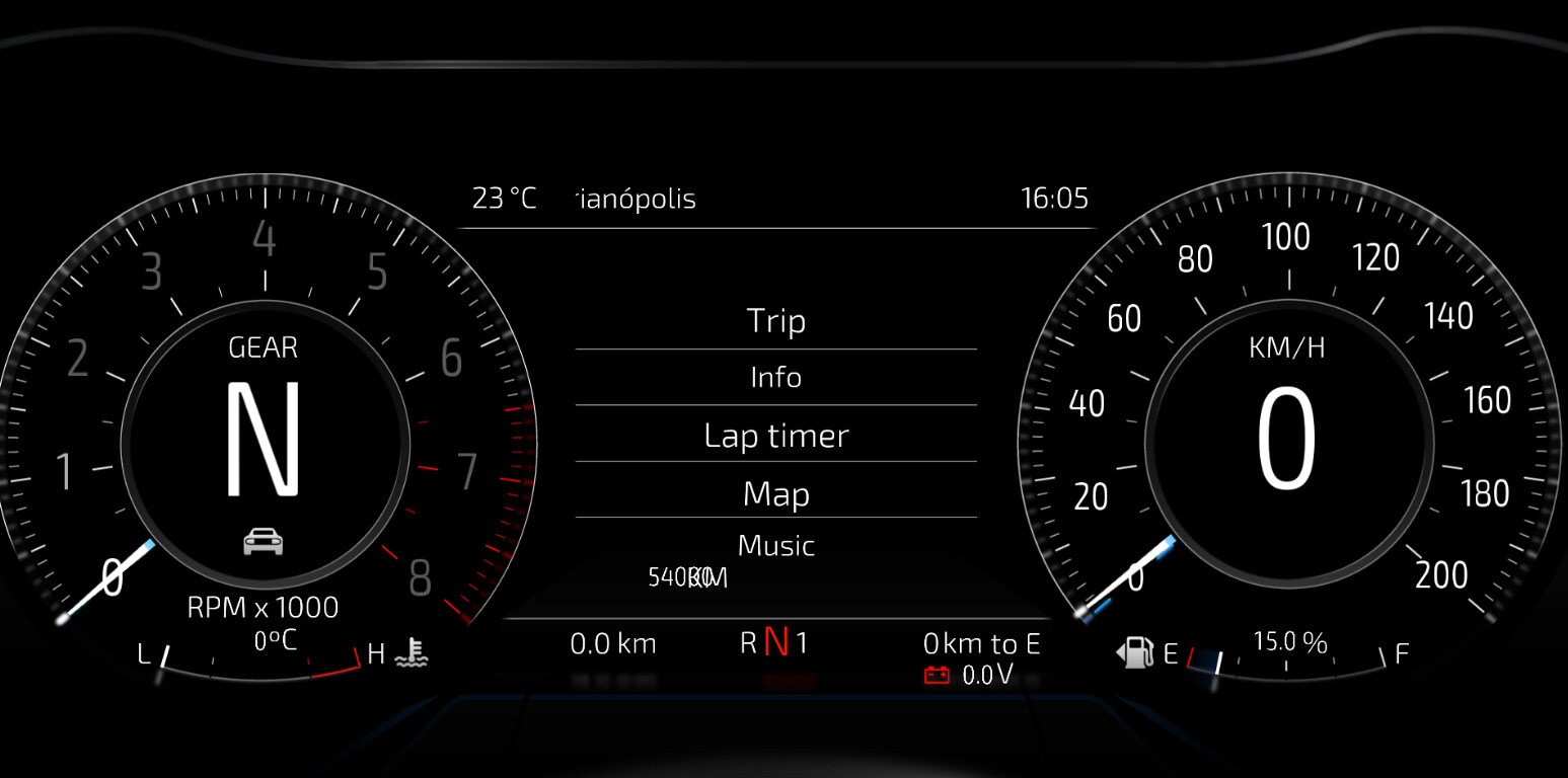

Hi guys. Regarding the New Boss on the block, Dash, it has three different screens inside this dash. Is there a way to delete some of these screens, keeping just one? For Example, I want to have just screen 1.
screen 1:
screen 2:
screen 3:

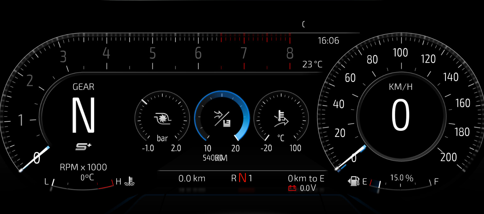

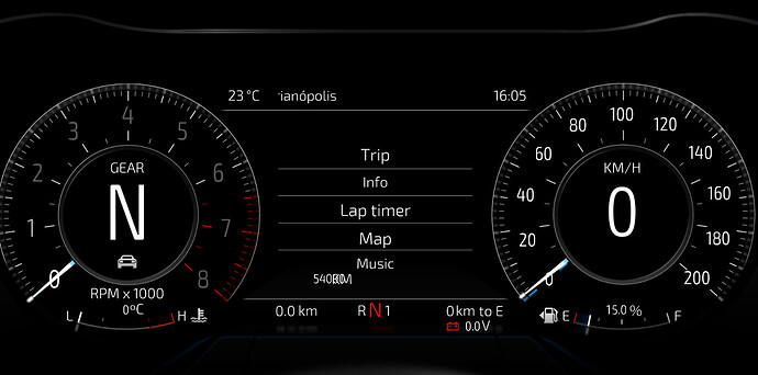

screen 1:
screen 2:
screen 3:
Its not easy to modify our fully animated premium dashboards as their animation scripts are not available for the public. Reason for that is that it would be too simple to duplicate our premium dashboards and share them free of charge.
ok. So if I want to create my dash, how can I create a dash if more than one screen option like new boss on the block? Thanks
You have to use the animation scripting system. In practise, you show/hide/move gauges based on triggers from buttons (or elsewhere). It is actually quite complicated task, see animation system documentation here:

It is possible, but its also very hard to modify our fully animated premium dashboards. If you just want to add static indicator lights to the top, it should not be an issue, but modifying any animated components is next to impossible as we do not share our premium dashboard animation scripts.
