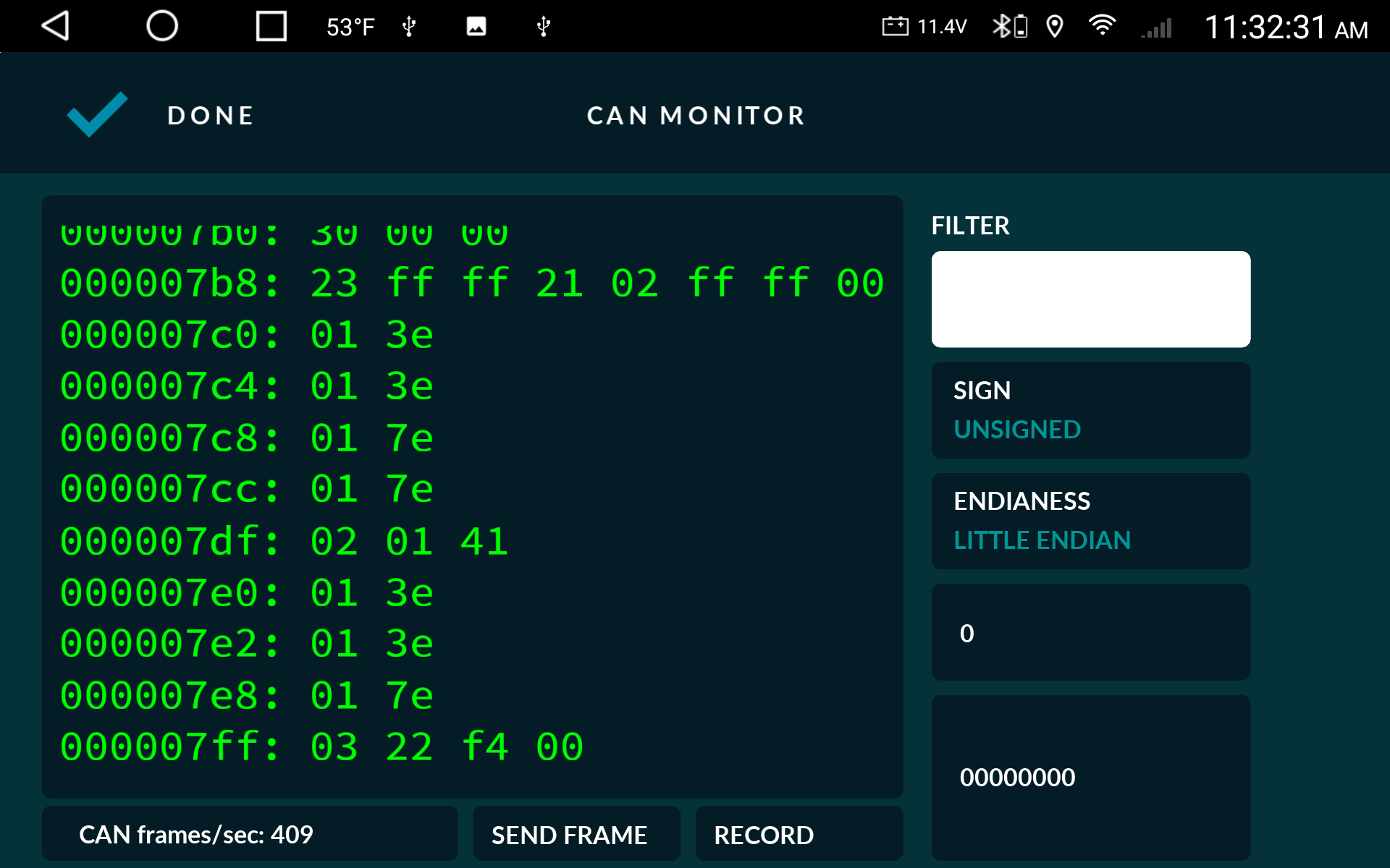

After plugging in Toyota Techstream and going to the section to use Actuation for body control module. A whole much of new CAN IDs showed up.
I’ve never had anything past 0x638

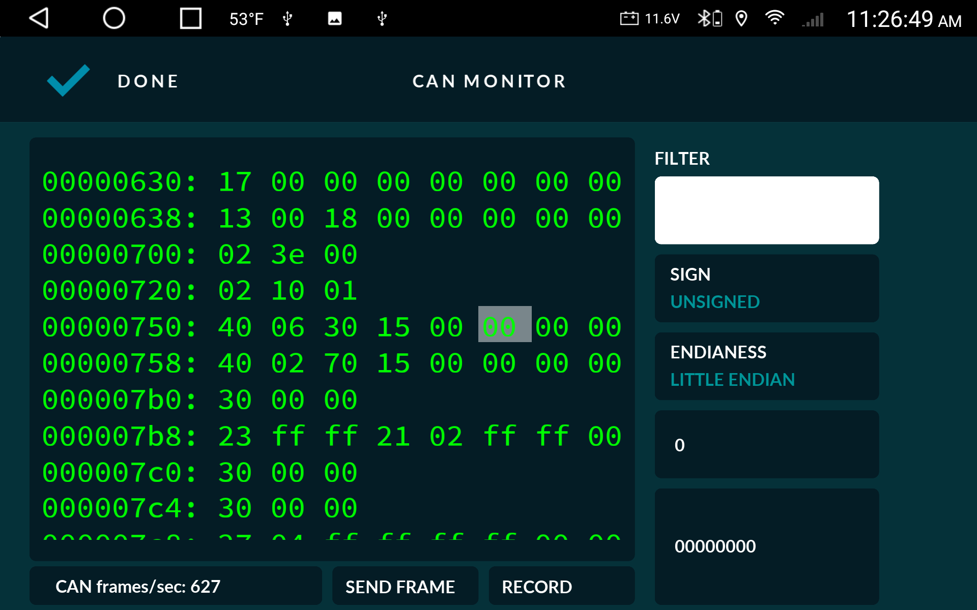

This one value changed when I used the software to Actuate the wireless alarm buzzer, which actually emitted a sound! (I don’t have keyless entry, but I guess the buzzer is still equipped).

this is the SEND FRAME date I sent
0x750 0x40 0x04 0x30 0x14 0x05 0x80 0x00 0x00
upon doing this, it showed up in the window, but the buzzer did not emit sound.
