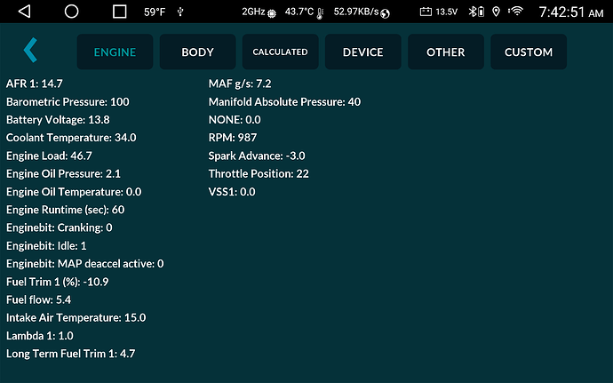

Trying to track this issue down. It’s probably some silly mistake i made.
Trying to get rid of the “NONE” item.

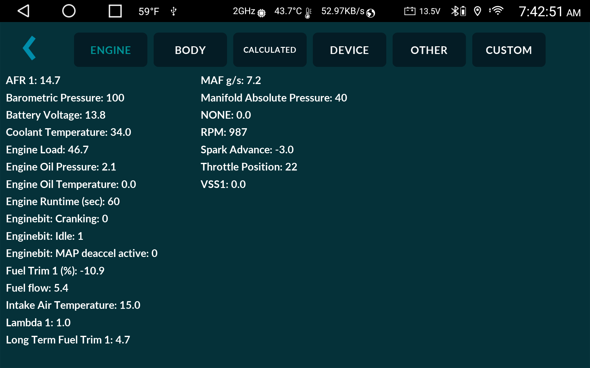

Yes, that should not appear there. It indicates that something is writing into a value that does not exist. All those value writes go to internal input called NONE.
I will remove NONE input from the debug data view, don’t really know how it could be used there.
interesting. I went over my xml several times and couldnt find anything. Thank you!
How do you access this screen? I’ve never seen a screen like this before.
Go to ‘Settings->Application->Debug->Debug Data View’
