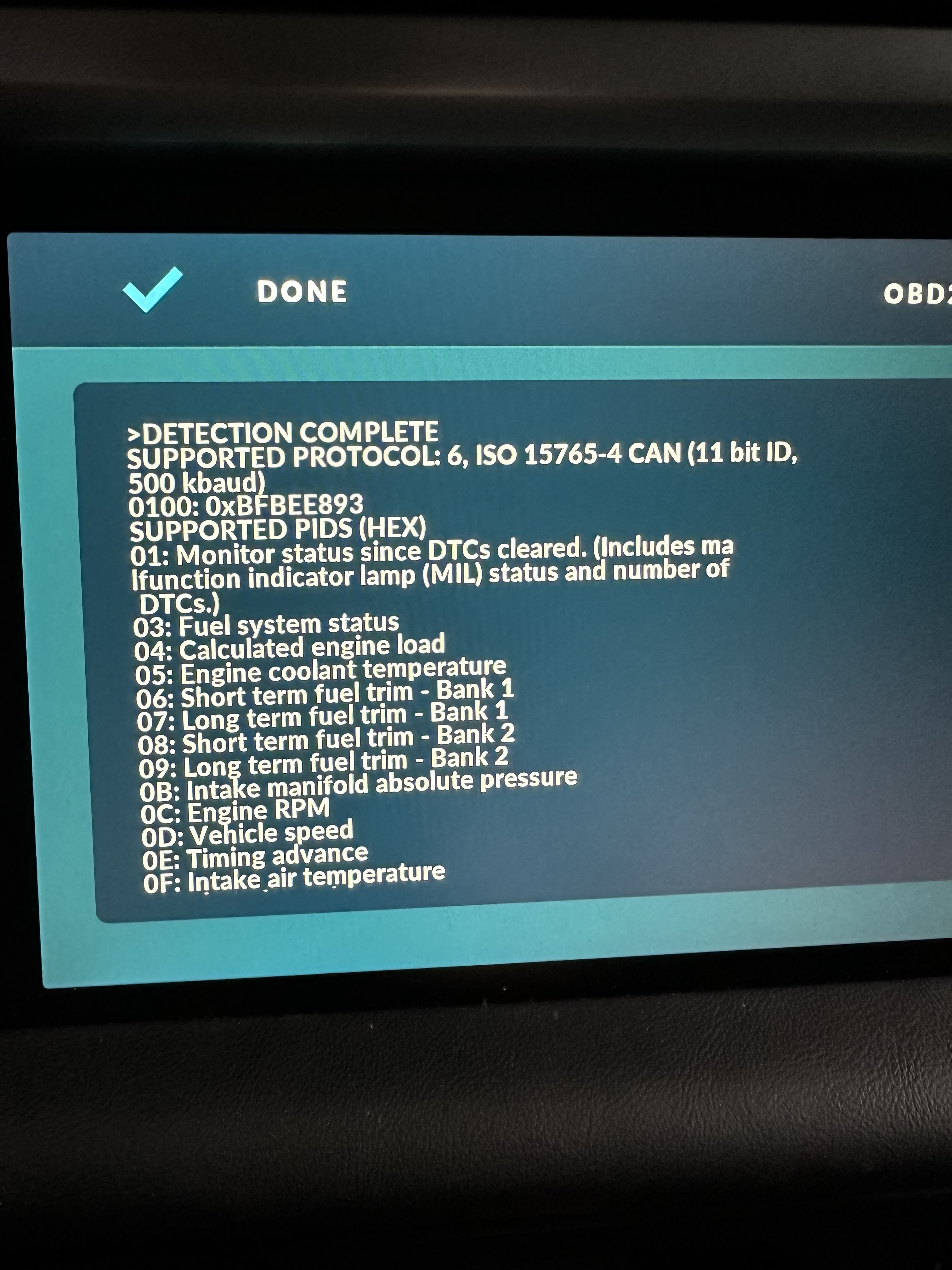

Hello, I am using a OBDLINLK MX+, on latest version 2.4.7 this is their best OBD model. On auto connect, it establishes Protocol 6, ISO 15765-4 CAN (11 bit ID) 500K baud.

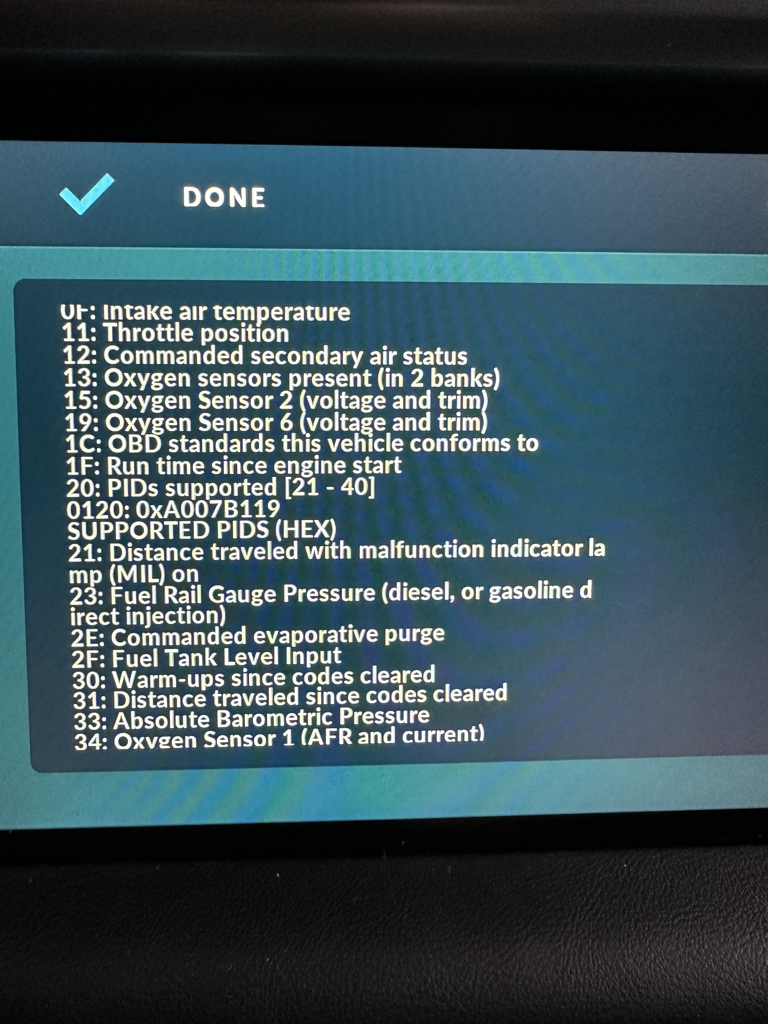

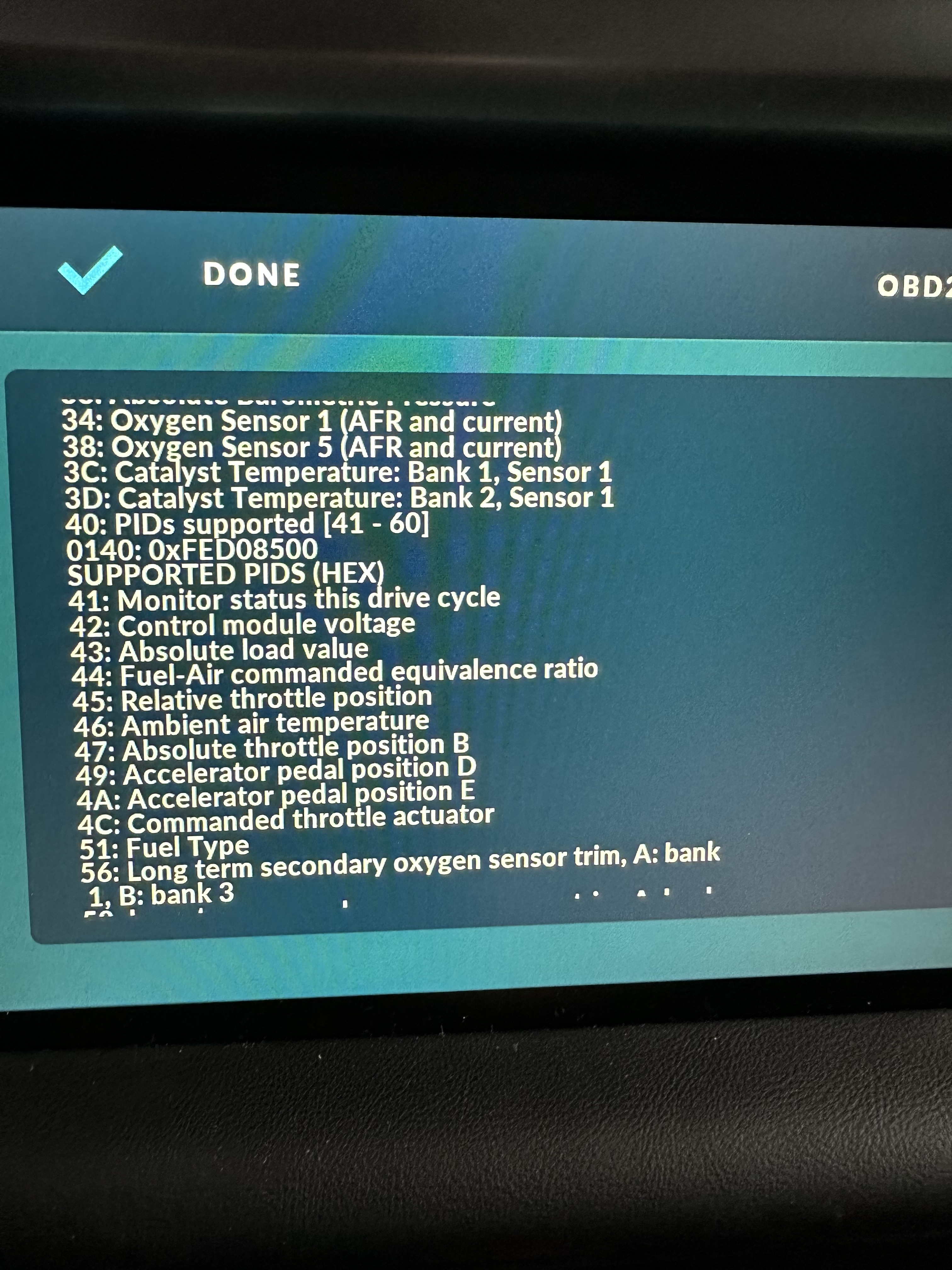

Per the pictures below, it seems to return very few PIDS :slight_smile: I know a custom xml will be way better, but it does not exist for Porsche Macan :frowning:
Is there a better protocl for this MX+ to get more pids ?? Or is this just going to be all I get ? I would like a custom dash…but with limited pids…not sure if it is going to be worth it, thanks.
Like 20 PIDS only ? any help appreciated.

Yes, If automatic detection of the OBD2 protocol works, do not attempt to change it manually to anything else. When using OBD2, your vehicle supports one, and only one OBD2 protocol.
Thank you , what can you suggest to make this work better for this vehicle ? More pids ?
We do not have custom/vehicle specific PID database for Porsche Macan.
