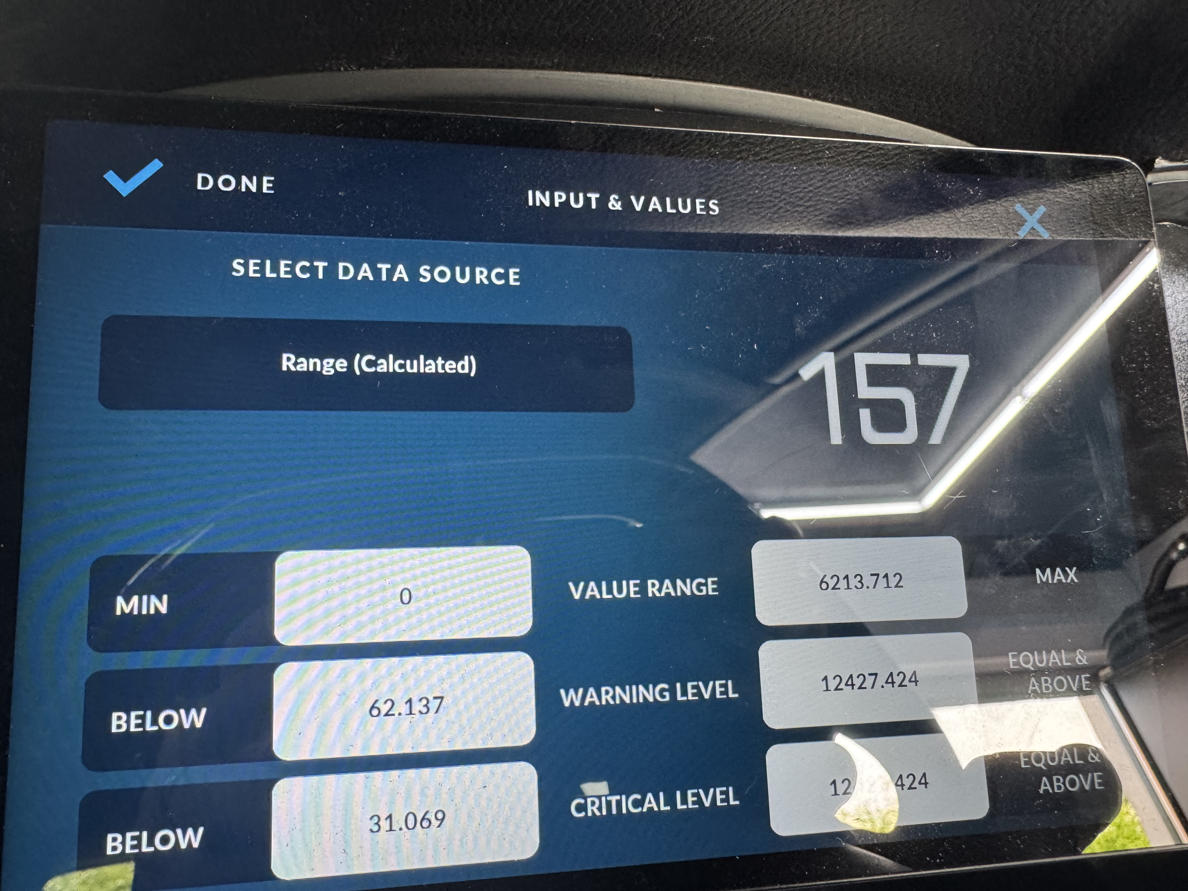

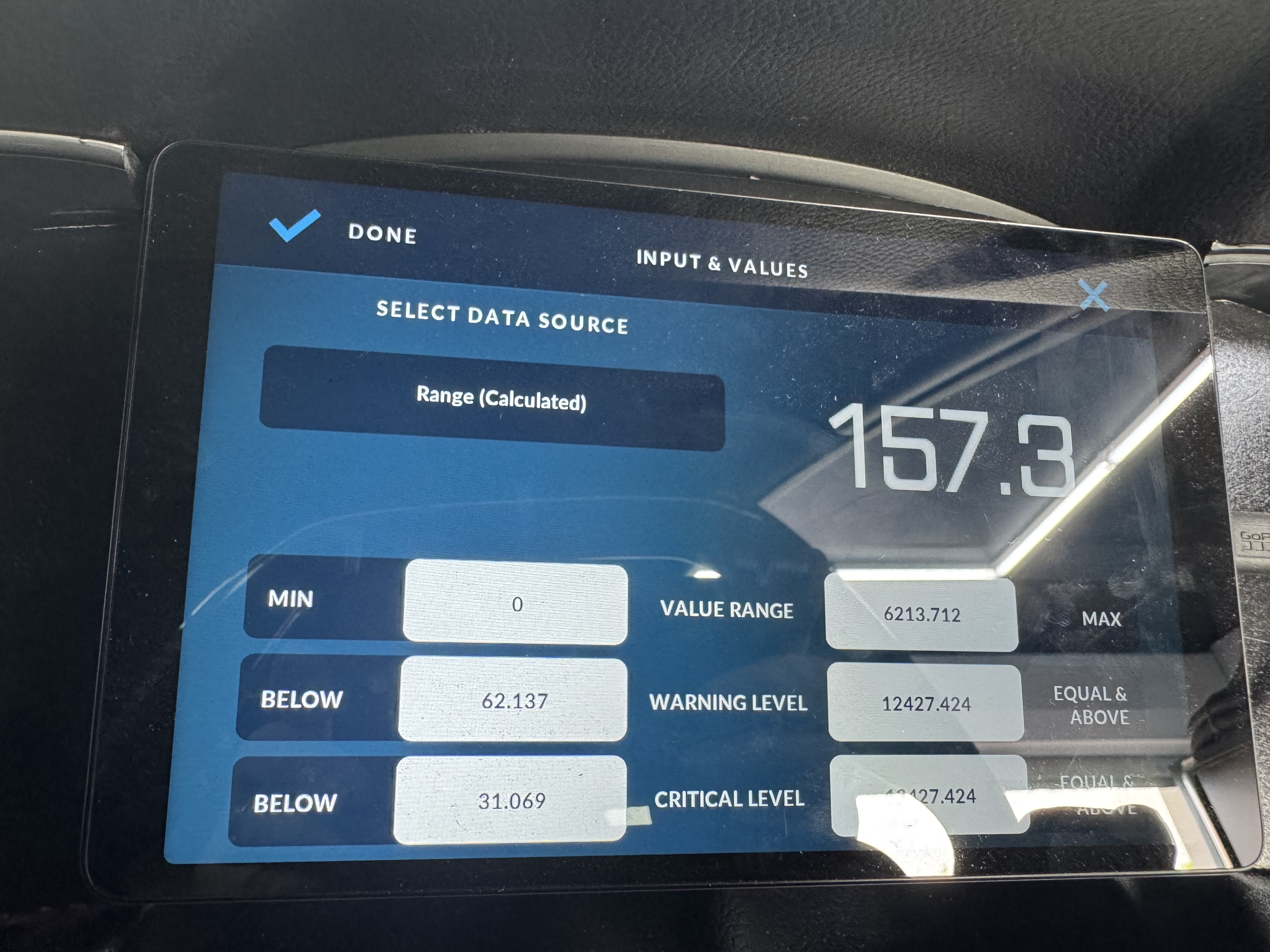

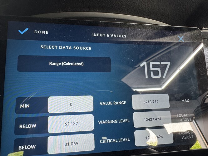

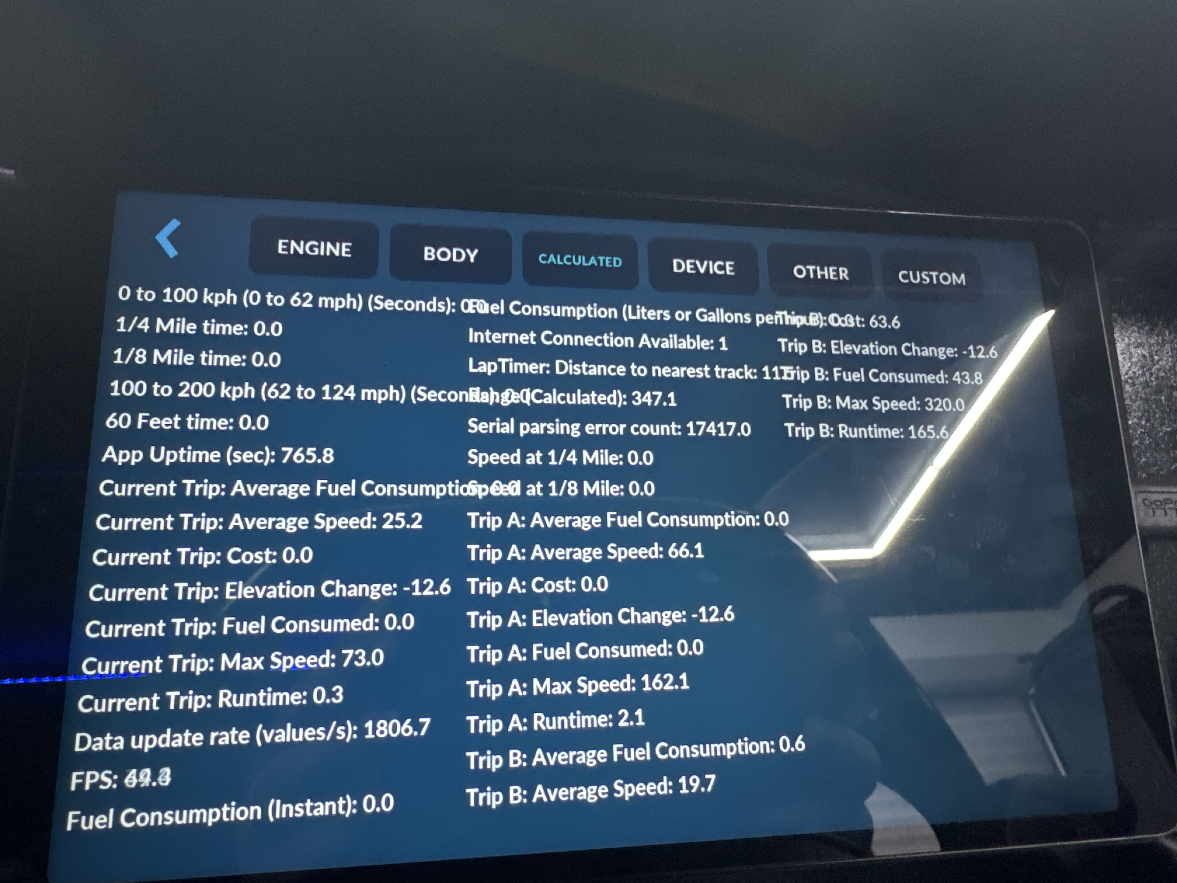

Distance to empty is using Range (calculated), the Debug screen has a different value to what is displayed on the dash see screen shots, I also tried removing the input and re-adding, still get the wrong number and it’s static
For range, it looks like you are using Miles as a distance unit. Debug Data View shows raw data, which is in Kilometers.
Ah that makes sense, so i’m still stuck then, odometer doesn’t update until ignition is cycled, Range is not updating at all.

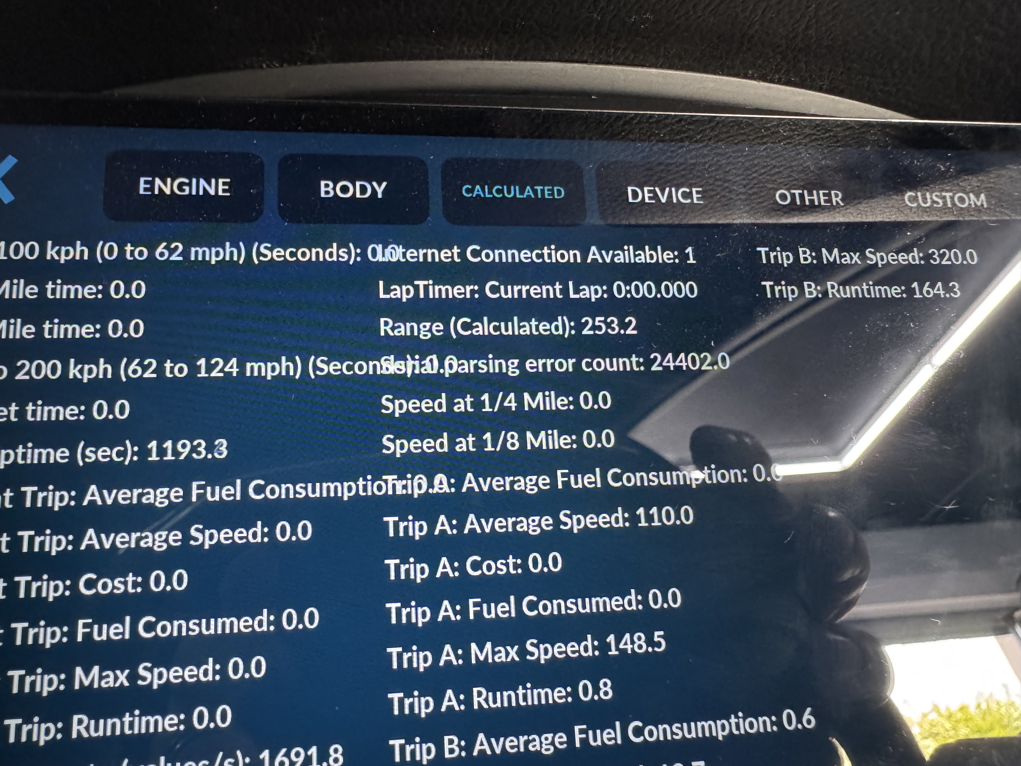

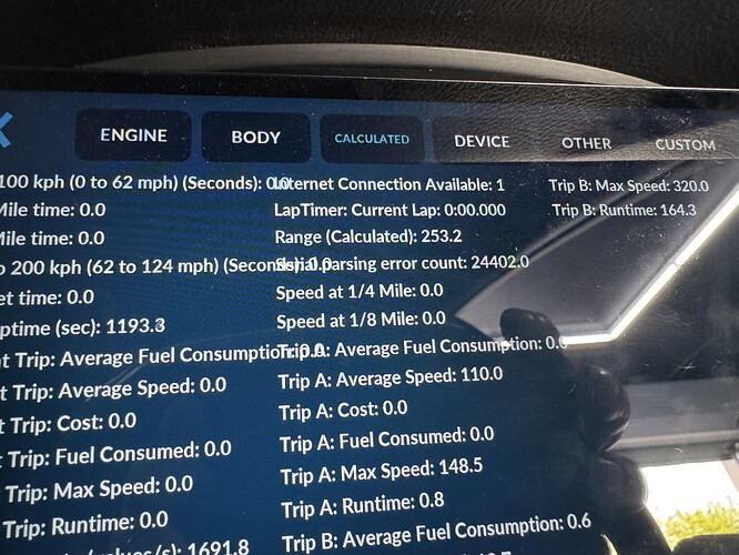

@realdashdev in the diag screen I’m seeing “serial parsing error count” counting up after 725 seconds is about 17200 errors
What CAN adapter you are using? Seeedstudio and Waveshare adapters produce a lot of errors when ran at high baud rates.

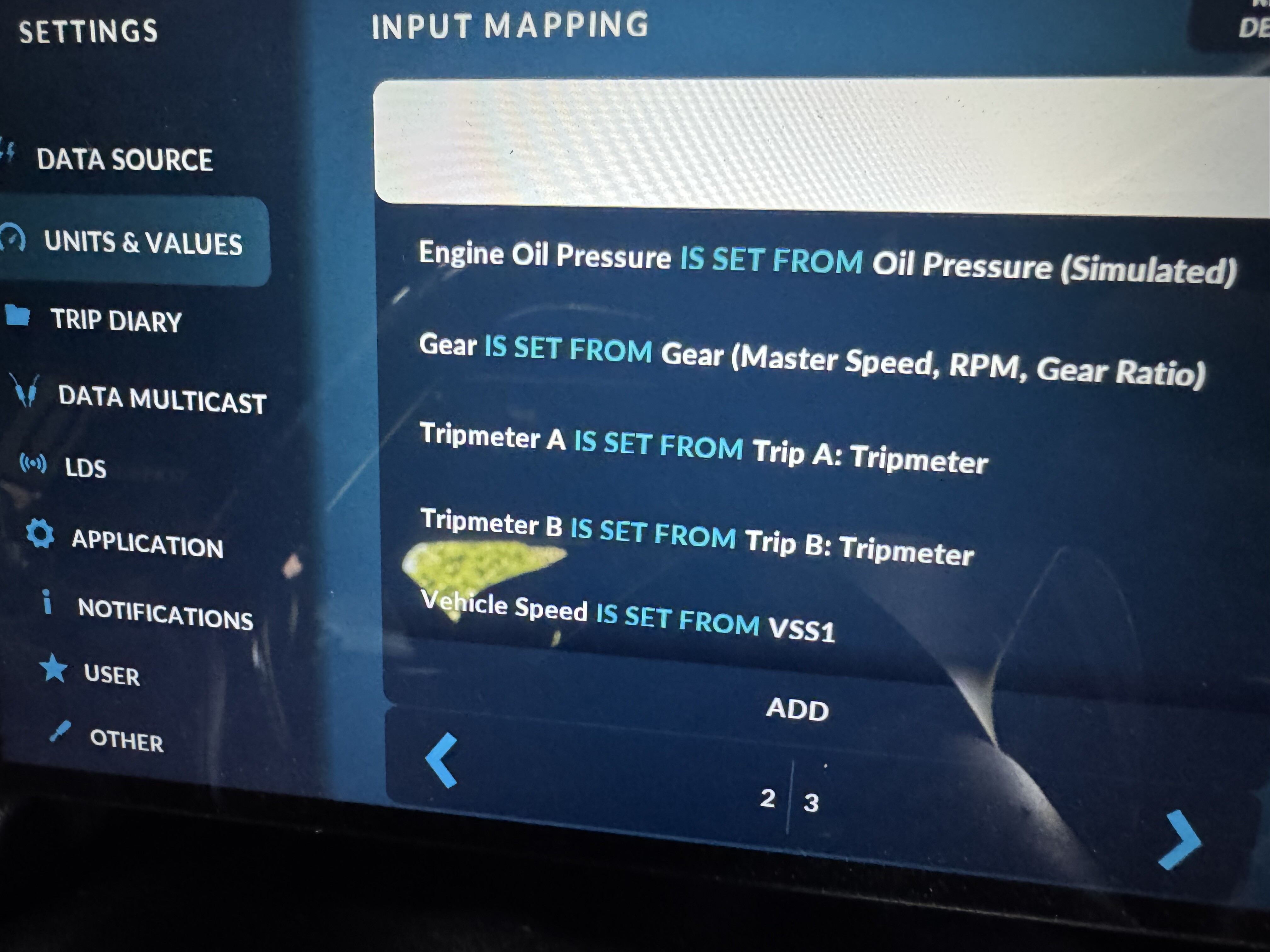

Edit: Are you using Input Mapping for fuel level? Check ‘Settings->Units & Values->Input Mapping’
