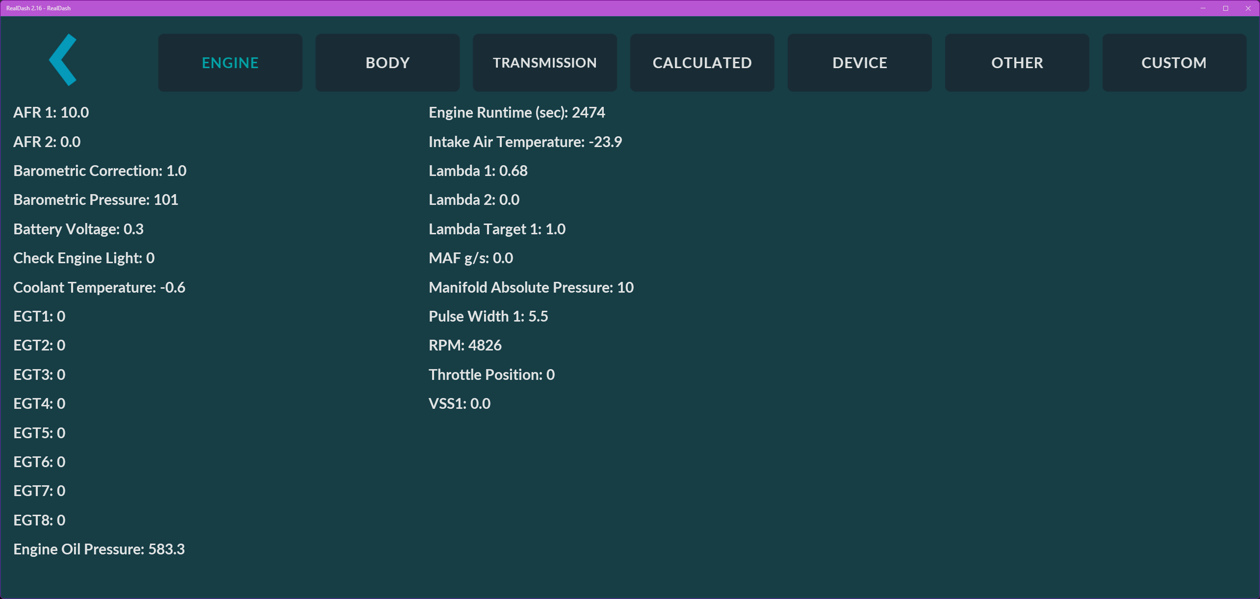

Hi, I was in contact with @nishirams earlier on the Discord world and steered him to here, but decided to look it up myself too, since I can access the Debug Data View :slight_smile:
I tested this with Proteus f4 and latest rusEFI firmware. (USB/Serial) Oil pressure is visible in Debug Data View on my setup.

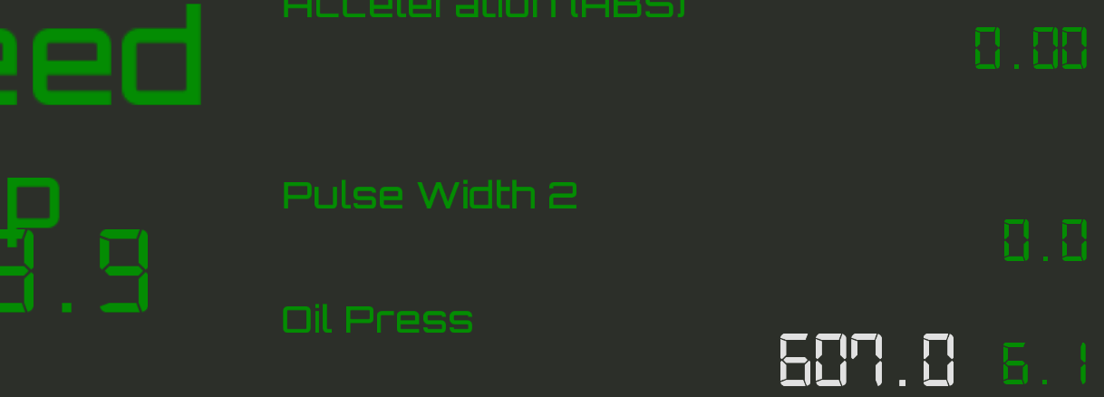

But, the value conversion is wrong, and the gauge maxes out if no conversion is added to gauge maths. With V/100 it works correctly. (White text gauge is “raw value” and the gauge max set to 10000)
Thanks Palepp , yes I’m your case the oil pressure field is coming, even on USB/Serial, I’ve gone through the list 4 times over and in my case engine oil pressure is not there, of course I can’t see it in debug view as I’m not subscribed. I guess my only way to get this to work would be to use CAN as I’m waiting for my Canable adaptor.

It seems like ECU is sending oil pressure in kpa and RealDash always expects incoming pressure values to be in bar. But conversion V/100 does make it show correctly.
Yeah exactly, i just realized this morning that i didn’t consider the unit used in ECU while i was checking this yesterday, but very likely it is in kpa.
