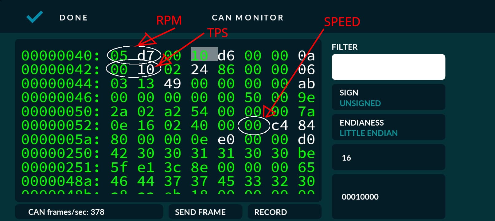

Recently I got a CANable slcan adapter, and I got broadcasted frames such as RPM, TPS and SPEED, and another PID its very hard to identify, here is the frame sample:
I need some other pid such as Coolant Temp, MAF, Oil Temp and so on and searching for a long time and got no result.
Could you please teach me how to send request directly to ECU for above PIDs with XML,
Thank You very much

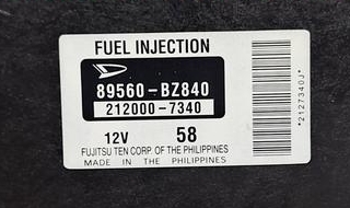

its a FUJITSU 89560-BZ840
