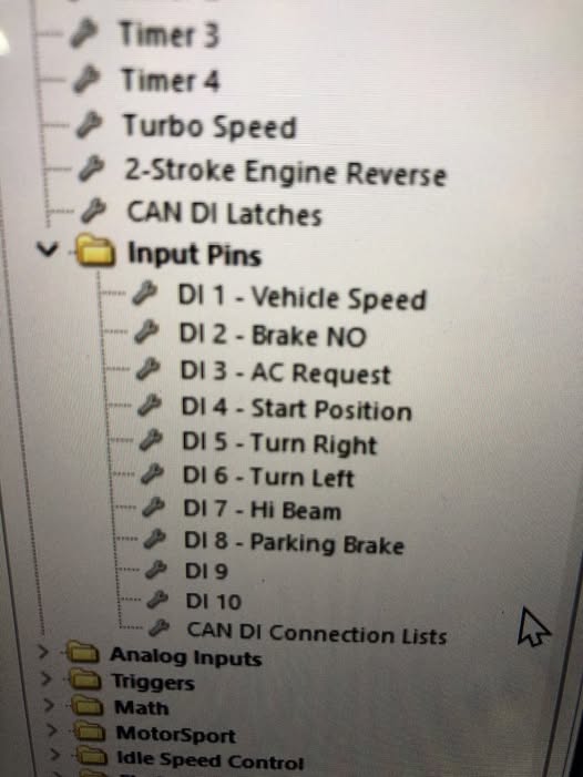

I am unable to determine how to select the input values required to display the indicator icons on REALDASH. I wish to display the turn signals, parking brake, and high beams connected to the digital inputs on the LINK ECU. Please advise.

Using the CAN adapter meatpi to communicate with LINKECU.
I have created the XML file, but I am unsure how to get it to recognise the digital signals from the image.
Paste your xlm code and i can tell u if theres a problem there
