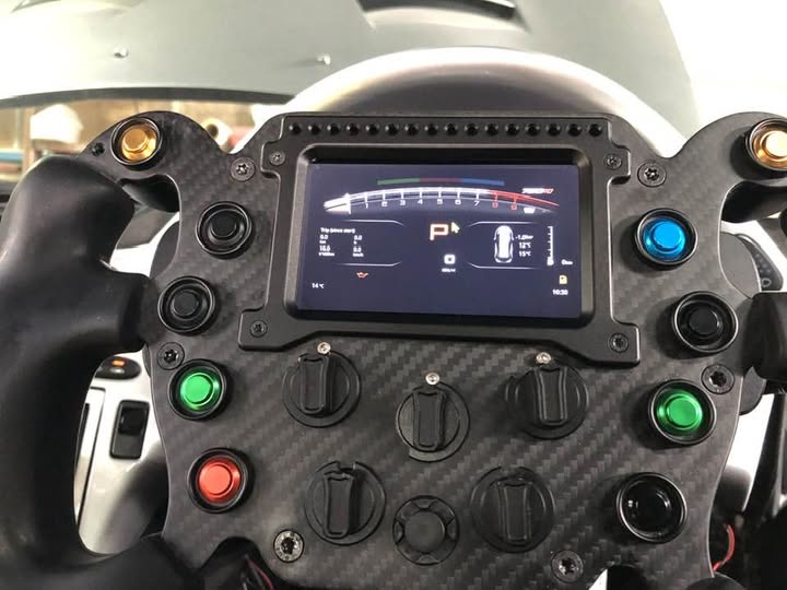

I configured the combination of link_ecu_short.xml & Transmit dash2pro, but the vehicle speed function is not working.
LINKG4X (Di1 RL wheel signal input) CANTCU (DCT GEARBOX)
Please advise.

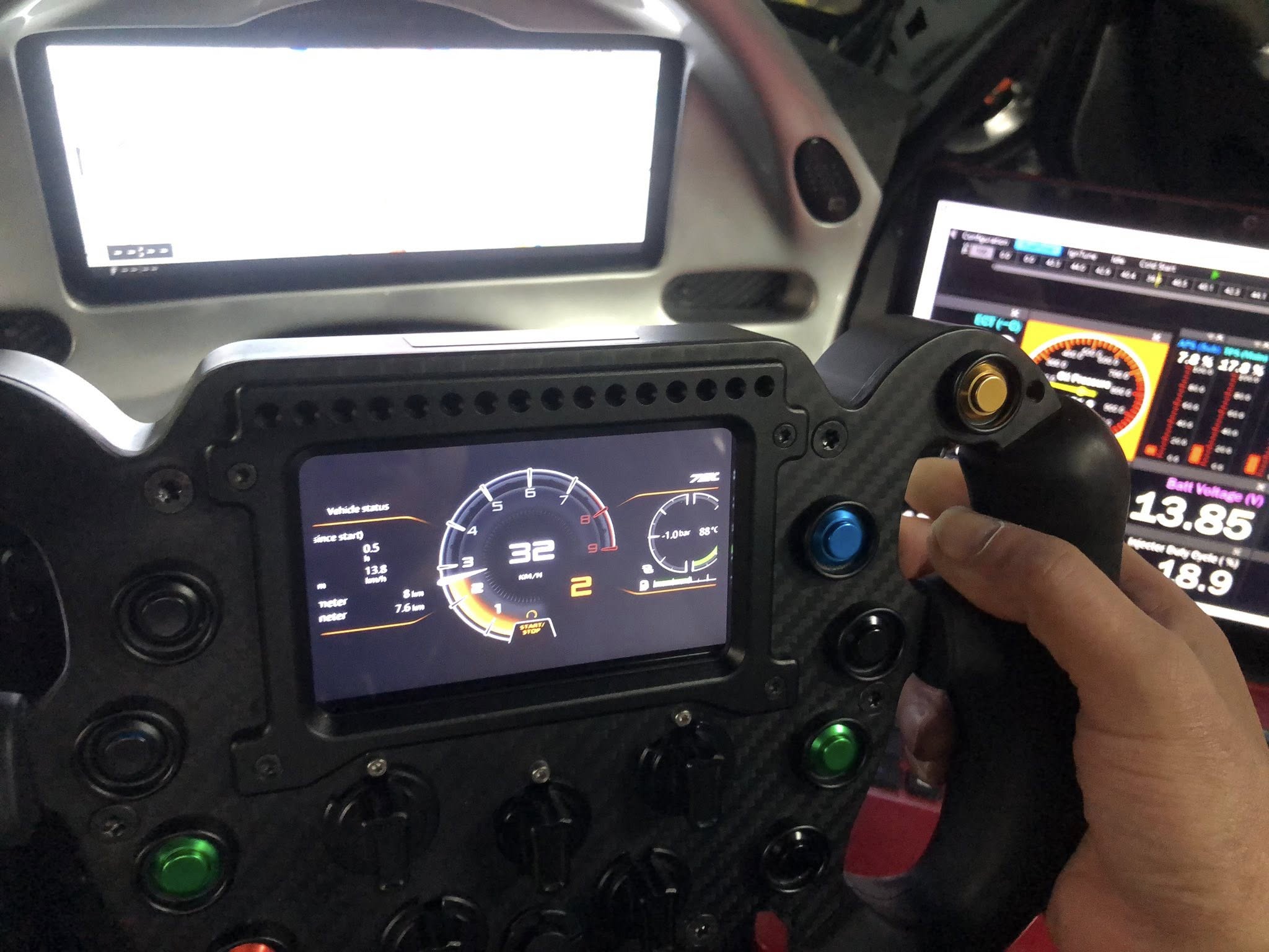

Use input mapping to map your TCU speed value to vehicle speed:
  • Settings->Units & Values->Input Mapping
Is it difficult with digital signals from the ECU?
No.
  • Use the Debug Data View from Settings->Application->Debug
  • Inspect what input has working vehicle speed
  • Go to Settings->Units & Values->Input Mapping and map the speed input into ‘Vehicle Speed’
