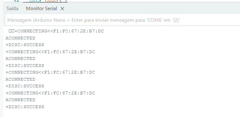

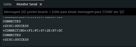

I ran some tests to better understand what’s happening. I connected the module to the serial monitor and noticed that every time the connection is established, the module sends a “connected” message. I believe this may be interfering with the communication.

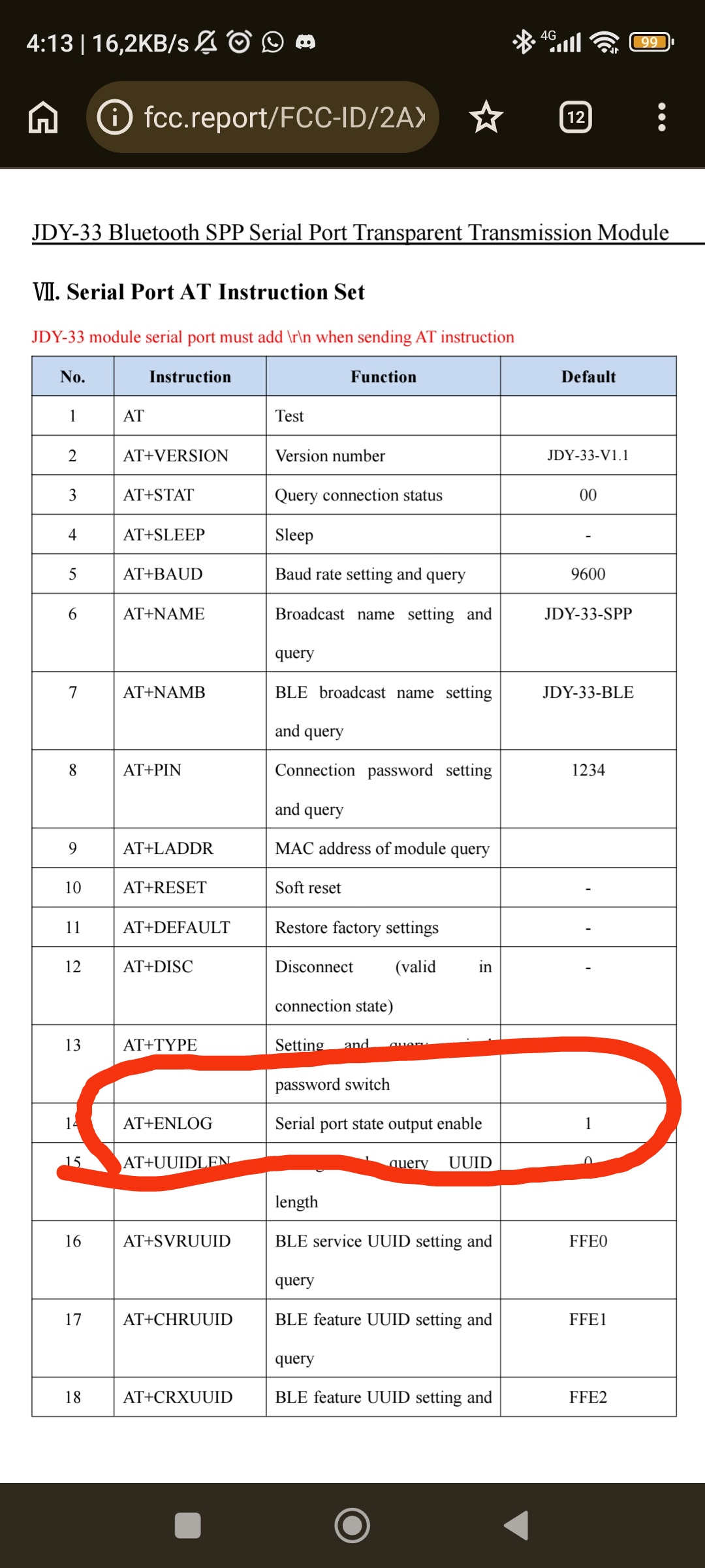

It’s the adapter itself that sends it. I ran tests connecting through a Bluetooth terminal, and the same message is there. The datasheet shows an option to disable the message, but it doesn’t work.
